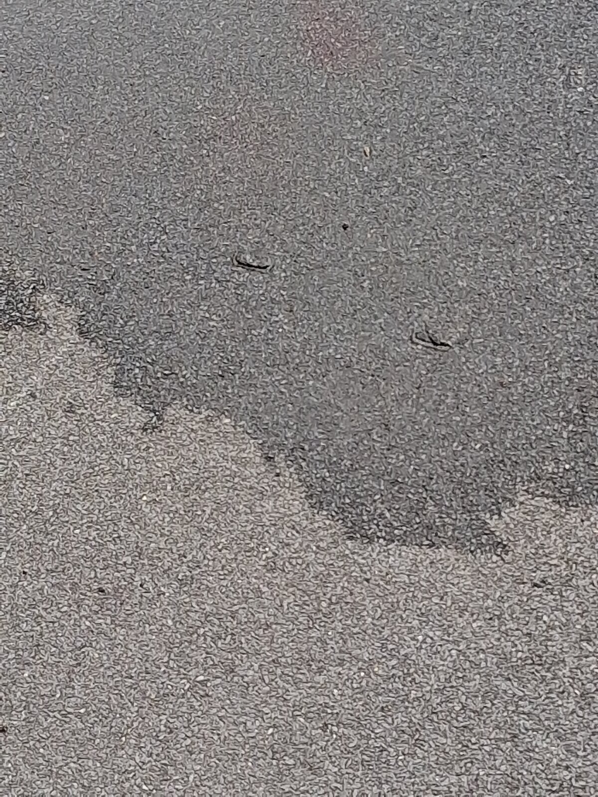

Ladder feet dents in flat roof felt
17 Sep 2025
3
I employed a roofing company to look at our roof.
When using a ladder to reach a high level the feet dented the flat roof in eight places.i attach a photo that shows two of them. They haven't punctured the felt. How should I repair them.?

I'd phone the company that don't it. That's a poor effort. They should fix.

You need that repaired..
Black jack or similar.
I think they were a dodgy company. They haven't replied.
Are you concerned about the visual appearance or water ingress? If the latter you can patch felt roofs.
I guess a bit of both but water ingress is my main concern.

They patched up holes which took days but it's worked.
So felt can be repaired.
