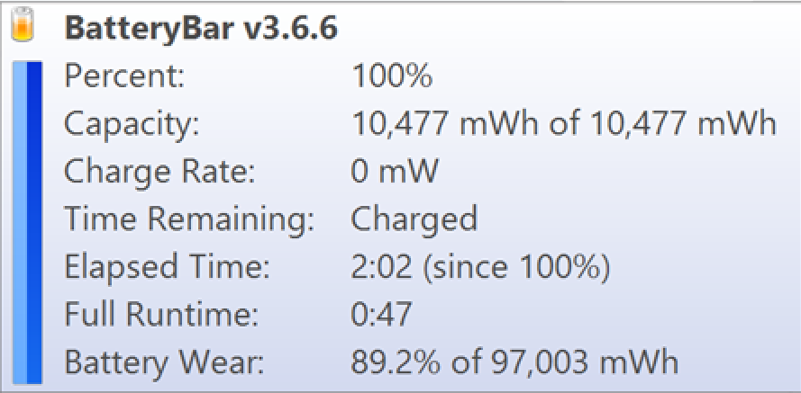

I have a GF65 Thin 9SEXR msi laptop which is only 3 years old and little used but the battery seems to be completely drained, the laptop will only power up with the ac adapter lead attached. I have done a battery report but not sure what it is telling me 51300mWh design capacity and 39433mWh full charge capacity. Is it likely to be the internal battery that is the issue or the power block for the want of a better word attached to the ac adapter being faulty and not able to fully charge the battery?
Your laptop battery design capacity is 51,300 mWh, but the full charge capacity is only 39,433 mWh. That indicates that the battery can no longer hold its original charge capacity.
The full charge capacity is significantly lower than the design capacity, which means the battery has lost some of its effectiveness, likely due to bad charging habits for example draining the battery to 0%.
You will need a new laptop battery but before putting a new one, go to device manager and uninstall the battery driver then reset your laptop, the issue might resolve for a short period of time, but it will return later, new battery needed.
EDIT : The charger is fine as it does power the laptop without the battery
I would read that, as the battery is around 1/5 lower in capacity, than when it was new, but it may not be the entire story. If the laptop will only work with mains plugged in, it suggests the battery is not producing the volts needed. You can buy batteries online, and they are not usually difficult to replace.

My 2015 HP laptop battery has a design capacity of 41 Wh. Currently fully charged has a 68% capacity at 28 Wh. HP Support assistant states a cycle count of 266/300 for what that's worth. Also says the battery is healthy.
The battery supports the laptop fine when unplugged (or I forget to switch on the wall socket for mains).
It's thrown some wobblies in the fairly recent past wrt not charging properly and has needed the battery disconnecting and reconnecting to resolve. Simple on this device as it plugs in and doesn't need the case dismantling (unlike access to the memory or HDD for upgrades).
I blame Win11 on this unsupported processor ;)
EDIT All batteries degrade over time and lose capacity. Some designs/chargers just do better than others. Only if the battery capacity affects regular 'normal' use should a new battery be considered necessary.

Charging lithium batteries to full charge (100%) eventually damages them, same as letting it reach 0%.
It's not the charger damaging the laptop, once the battery reaches 100% the circuit disconnects the battery circuit, you can test this by feeling the adaptor, it won't be hot after the battery is full as the current supplied by it is reduced.
