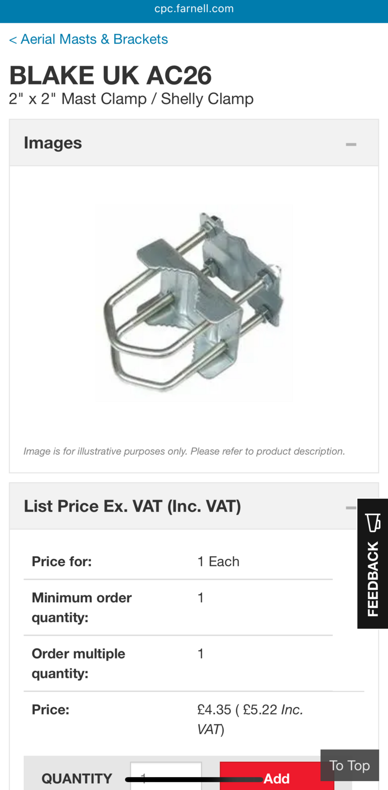

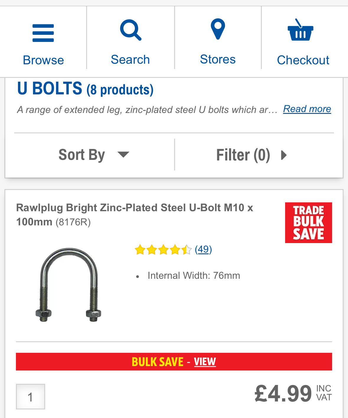

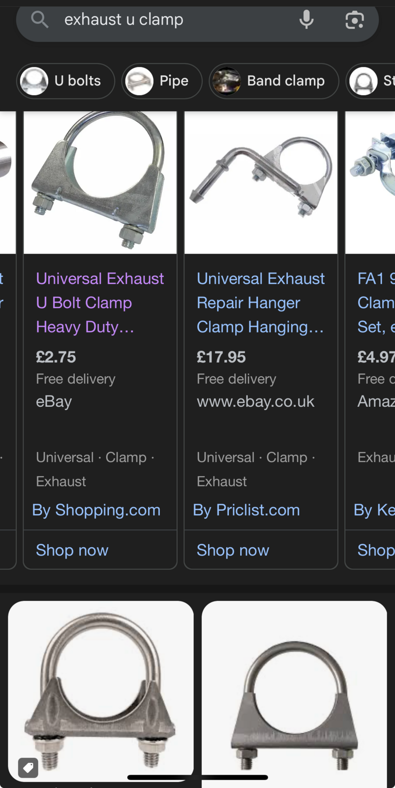

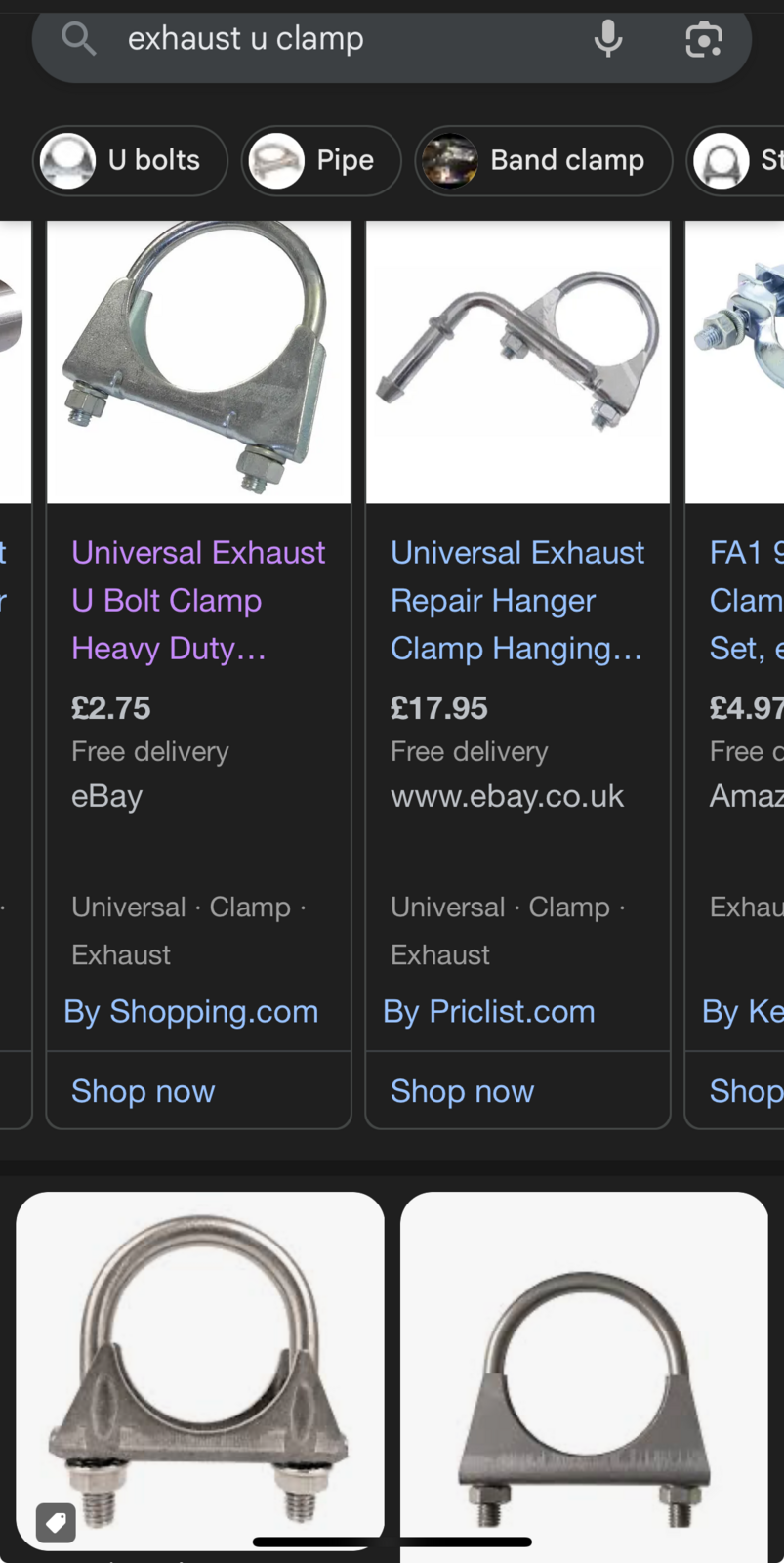

Or use a U clamp intended for car exhausts, they come in various sizes and you can either drill another hole in the plate part to fit a mounting bolt or just drill two holes in your mounting plate the same distance apart as the holes in the clamp plate-and bolt thru the whole lot. They come in a variety of sizes eg eBay item 402992566500 or 355650948237
Also a thing, are u bolts - like above without the plate:

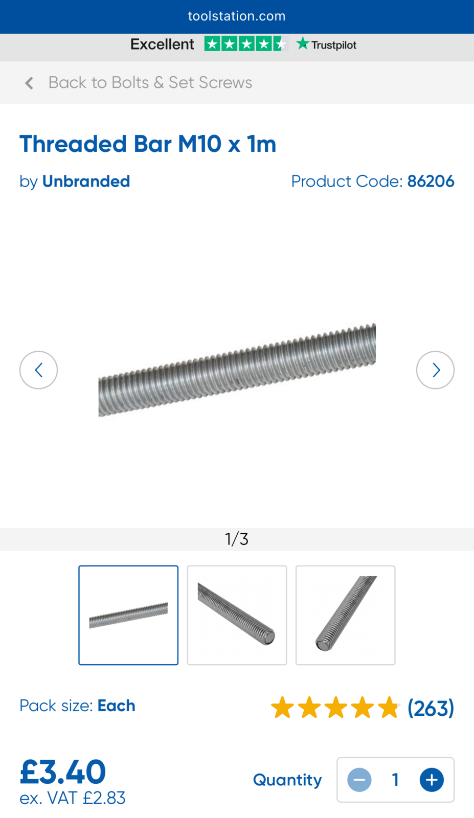

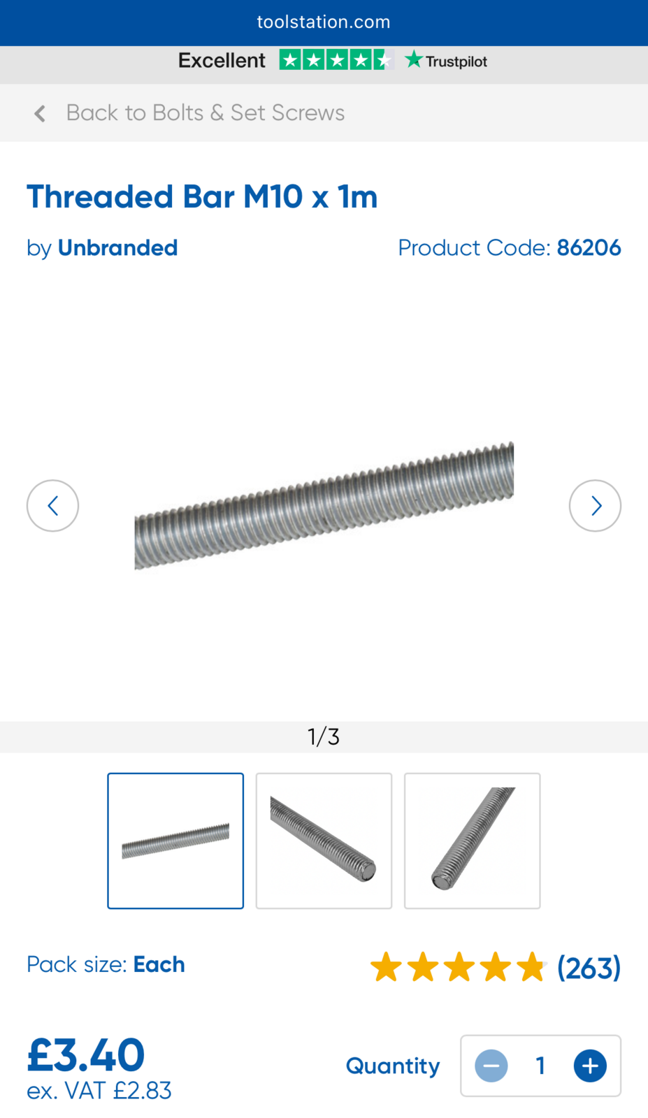

I've also seen masts and tubes mounted with threaded bar, and you basically just use the tube itself as a former for the bar, bending the bar around the tube for an exact size U clamp, then drill holes in a flat plate the width of the U:

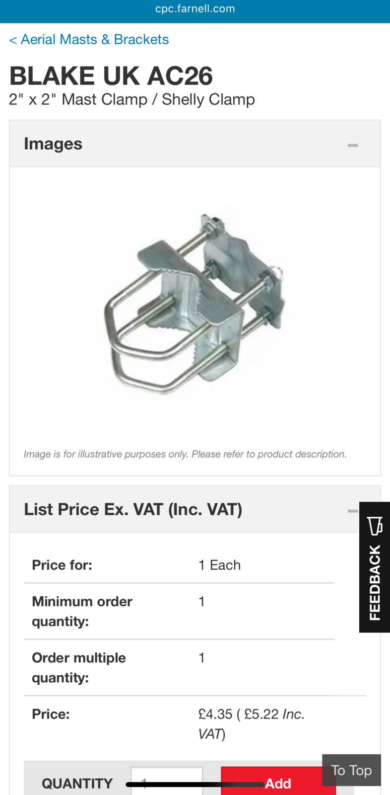

Also while browsing I saw this - maybe see how big stuff like that goes:

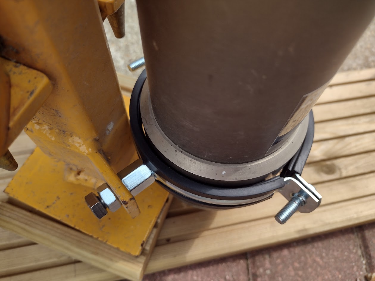

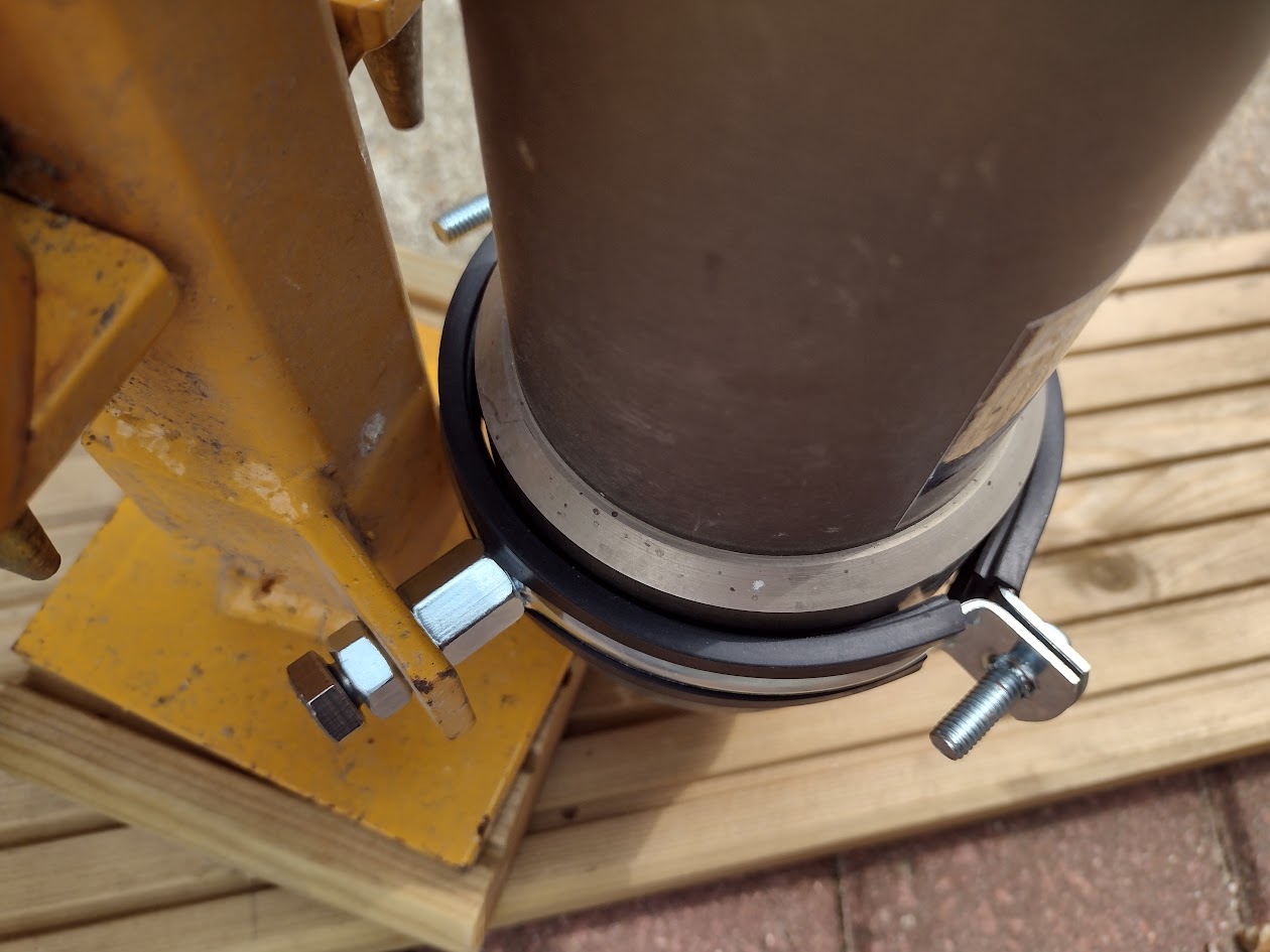

Well, I understand what you're saying, but I thought it was simple enough by showing the clamp I have and saying, it needs to look like that, with one central fixing point. As the ones I have, the only issue is the socket is welded on and the thread isn't deep enough.
So by 4mm deep, what I mean is what ever length the bolt is, you can only get in 4mm. So imagine it this way, the longer the bolt you use, the further away the mast would be clamped.
But yes when I get a chance I'll take a photo of the set up.
Someone linked to this a few days ago https://www.britishpipeclamps.co.uk/wp-content/uploads/2018/11/image-117.jpeg which would be ideal if they did the sizes I want. I emailed the company about sizes but haven't heard back, so will call them next week. They're ideal as they don't have a welded socket like the clamps I have, but like the clamps I have, they have one single and central fixing point.

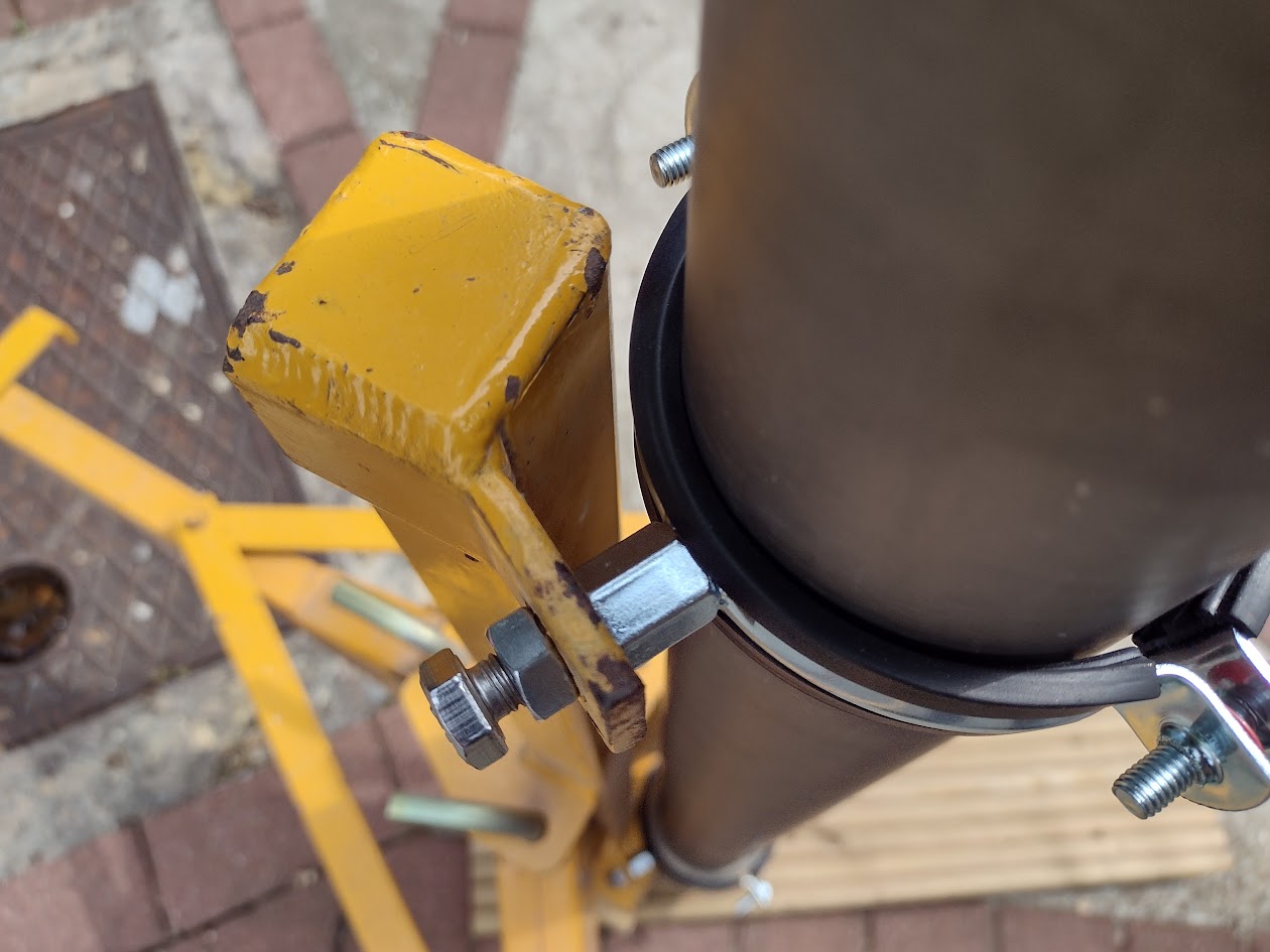

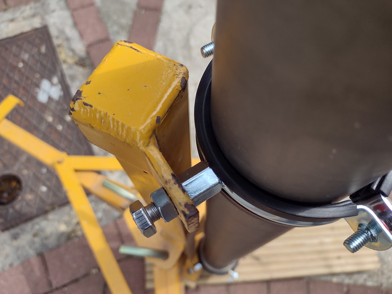

I've got some photos now of the tripod with mast attached. The photos will show why the clamps need to be pretty much the same type as shown. There isn't the width for U clamps or anything else really.
So long as the welds on those clips don't break, fine, but if they do, then we're in big trouble!

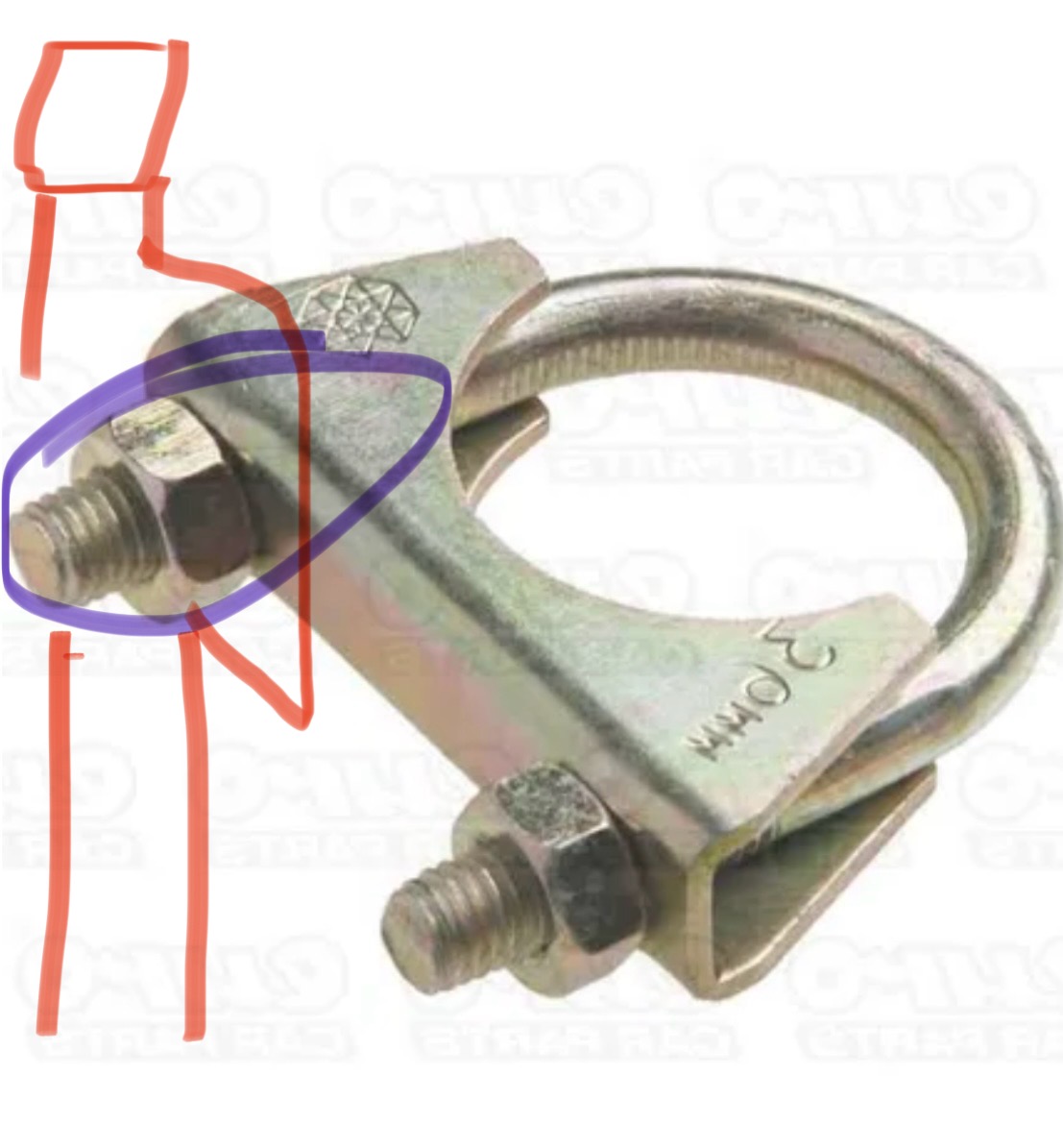

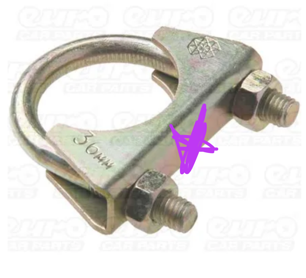

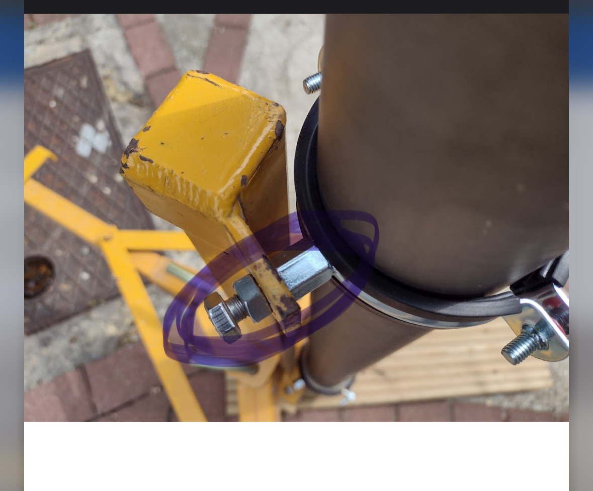

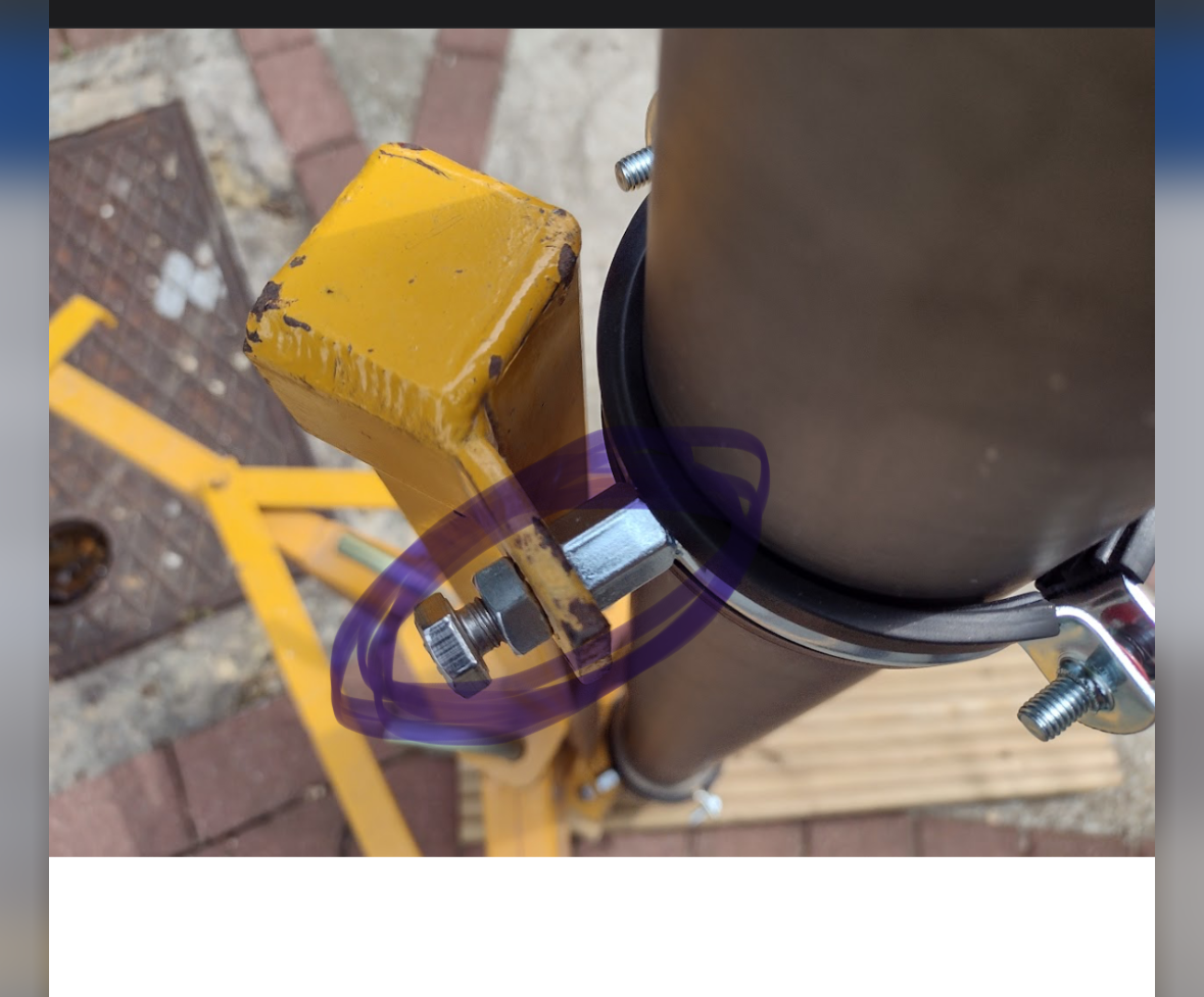

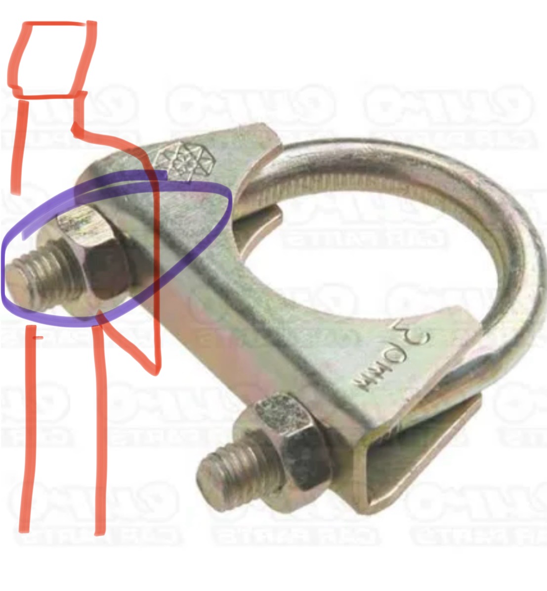

OK, no drilling needed, just pass one of the bolts on the U clamp through your yellow pole hole so the u clamp nut is bolting the clamp to the mast and the yellow pole at the same time
This bolt/nut assembly here:
Is this one here:
Drawn the outline of your yello pole in red. The yellow flange should be between the nut and the plate of the clamp. You could add washers or a nut for spacer if needed or try bolting the whole assembly to the other side of the flange (rotate the mast and u clamp 180 degrees) as the flange is slightly offset and the other side might give you more space. Could also grind a bit off the u clamp. If you really want security nip into your local garage/fab shop and ask them if they'll weld the Uclamp plate to the yellow pole flange (I'd use it as an excuse to buy a welder if I didn't already own 3)
Much more heavy duty than the 1mm steel band that's been tapped out to form a thread of that pipe clamp you've already got there

The side load needs to be in the centre, not to one side, so that won't work.
