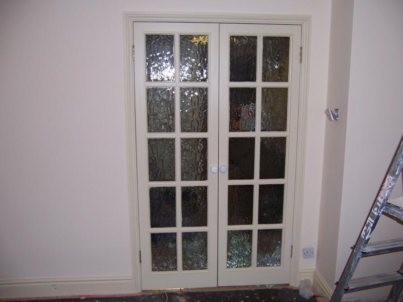

The door frame for my living room entrance is approx 1960mm high, 1140mm wide, currently occupied by wooden and glazed double doors, each door approx 570mm wide.

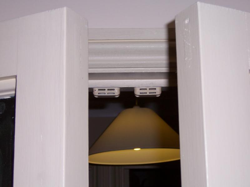

The problem is at the moment is that they are latched using a couple of magnetic latches at the top of the door stops, as you might use on cupboard doors.
There are no mortice latches and the knobs are just glued on.
This is rather unsatisfactory, as currently when trying to shut the doors they tend to bang loudly and rebound.
What latch options are there for double doors, something that would give a more satisfactory closing and opening action? Many thanks in advance.
you could try using some sliding bolts,or a pair of flush bolts and a latch and handles.
Thanks. So basically you're saying that if I wanted a mortice latch and handle (which I would like as that would match other doors in the house) I need to have one door bolted? That's what I was afraid of, the problem being that just having one door in normal use would be a bit too narrow, especially if carrying something.
I suppose I could replace the doors with one normal width one, and a sidelight the correct width to fill the rest of the gap. On the other hand, it is sometimes quite helpful to have the full width of the doorway available, such as when moving furniture.
Here's a thought - can you get extremely narrow doors? I could have a normal door on the left, and a very narrow door on the right which would spend most of its time bolted, but could be unbolted when necessary? I'm sure I've seen such a thing in an old office I used to work in, but I don't know what such things are called.
Or if that was too ambitious and I wanted to stick with the two 570mm width doors, do people think ball latches at the top might be better than magnetic? Any other advice?
