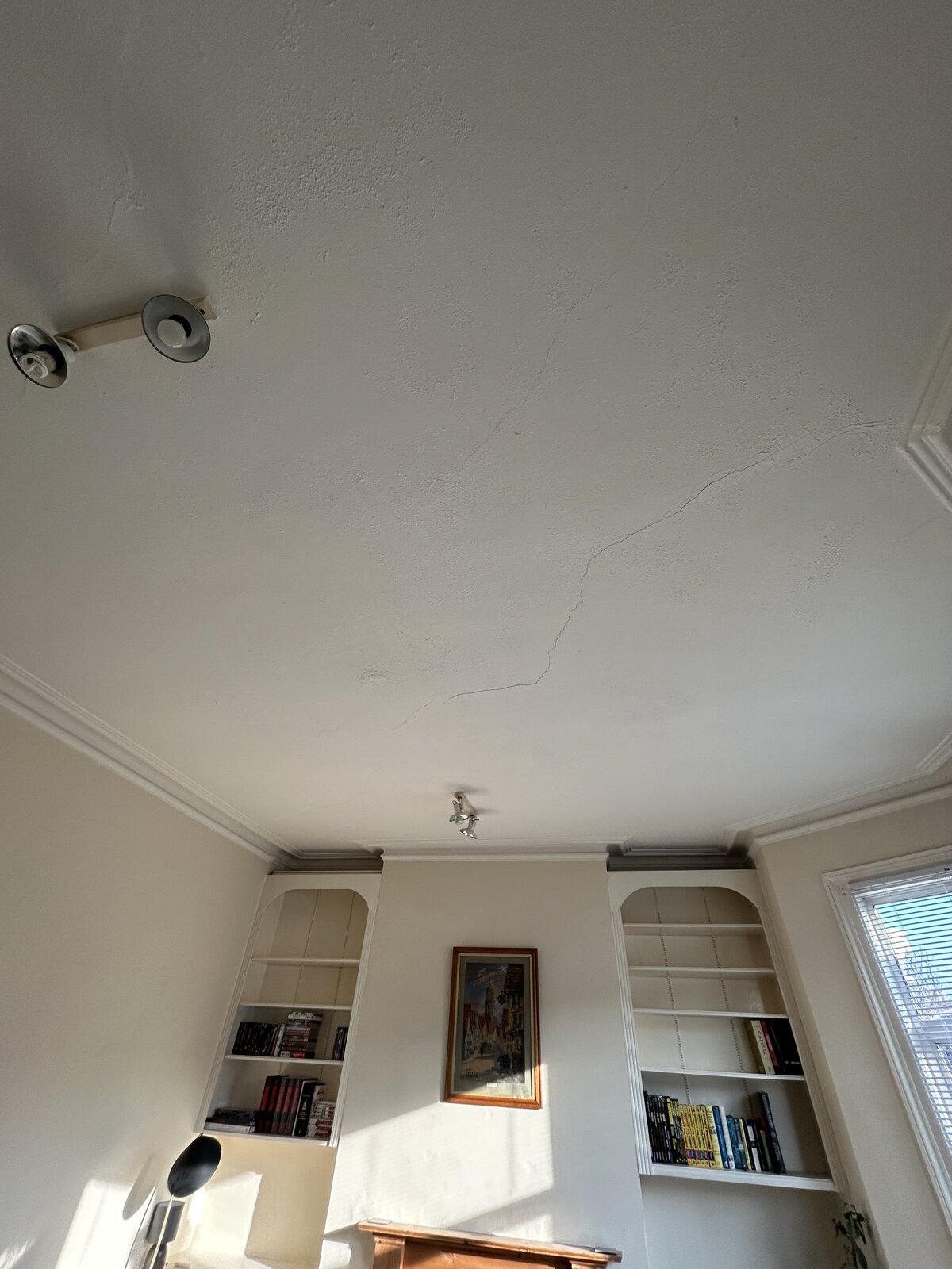

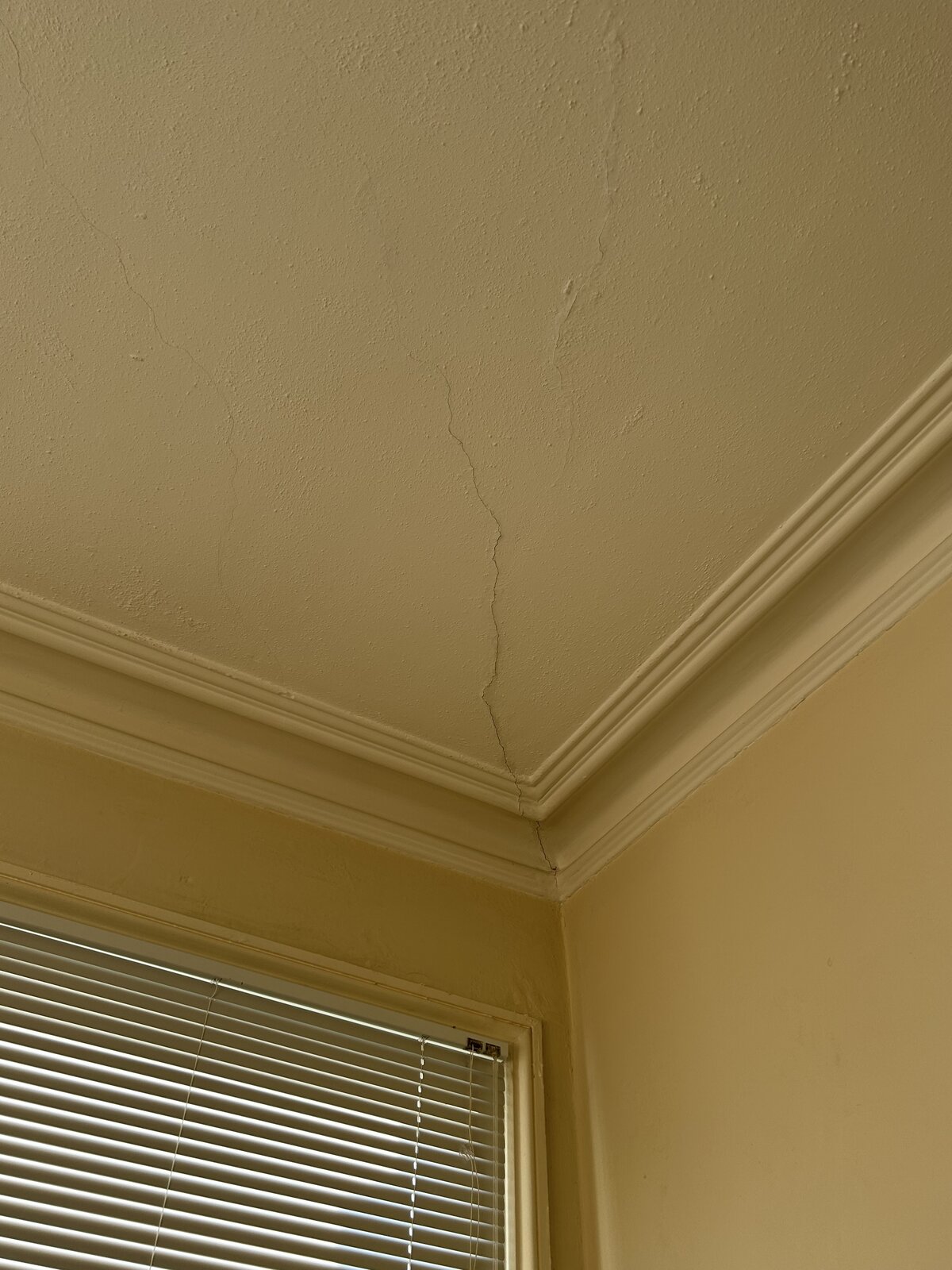

Hi there,
I am hoping to fix the cracks in a lath and plaster ceiling and have been getting varied advice online. I believe the loft was previously overloaded and so the cracks have been formed due to excessive deflection of the roof joists. They have been poorly filled in by a previous owner and have cracked again. The loft has been emptied so I believe the main issue has been solved, although I have not yet seen the joists to inspect for damage.
Options I have seen floating around online:
- Fully remove lath and plaster and replace with new plaster board fixed into joists
- Locally break out around cracks and reskim
- Overboard to avoid having to remove the lath and plaster
Does anyone have any experience in fixing cracks similar to these? Thanks in advance for any help!
You can get the cracks repaired but likely they will appear again.
Over boarding it will with plasterboard will be a better option.
However, If it was me, I would remove that old plaster rather than repairing it.
Empty the room and put a doormat outside the door, tape up the door, take rubble bags, a broom and shovel, and a canister vacuum in there.
Carefully remove the old laths. This may be a complicated job for the average DIYer as it's not a game of ripping everything out at once.
You can keep the cornice. If you want to carefully remove the laths and leave a 5 inch distance. between the coving, whej your finished removing everything then you can proceed to remove the rest of the laths carefully till the coving.
Wear a dust mask and goggles, do not open the door again until you have swept up, vacuumed, and taken off your filthy hat and mask.
Then replace it with plasterboard.

A much simpler job will be to overboard it. For one of my rooms, I done it this way to save time and it was perfect.
All I would add to @Jurassicspark's comments - if you are taking the lath and plaster down, remove all the old insulation from the loft first, and thoroughly go over the loft with the canister vac - it makes for a far less messy experience.
There may be laths going into an adjoining room - in my place it appears as if the partition wall was put up after the ceiling laths were in place - so be careful ripping out laths near the room boundary.
Personally, I went for over-boarding in my downstairs rooms; I could keep the original mouldings in place and the floor joists were beefy enough to take a bit of extra load.
My ceiling joists upstairs were slim and bowed, re-doing the ceiling from scratch allowed me to batten out the ceiling level, and didn't add too much additional weight to the joists.
Personally, I would keep the old ceiling, and fill the cracks.
If you overboard, you will lose some of the detail on the coving.
A new boarded and skimmed ceiling could crack along the joins.
Cracks in old ceilings are character.
Cracks in new ceilings are annoying.
