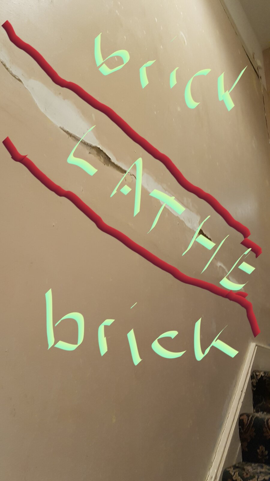

Pic shows hallway wall, after wallpaper stripped.
Between ground and first floor, the walls have beams running the length of wall, like a course of brick, but wood, as a base supporting the first floor joists. That is an internal wall.
House is 100+yrs old.
Here is a pic looking up the stairs at the wall.
The previous occupant made a poor polyfilla repair decades ago before papering, which was obvious through the paper, and now the orignal lime plaster is blowing /crumbling around the filler.
House was empty/unheated (stat was set to 4 Celsius) for several years before we moved in.
I assume the blowing only here is due to brick/wood expanding/contracting at different rates as temp and humidity fluctuated.
My gut feeling is remove the plaster and lathes, infill with plasterboard and skim/feather this into the original plaster (that is solid)?
Or would it be preferable to remove the plaster/filler on the lathes, and reapply plaster on to them? I dont think so due to the wood/brick expansions differences.
Please advise and thanks for the help
