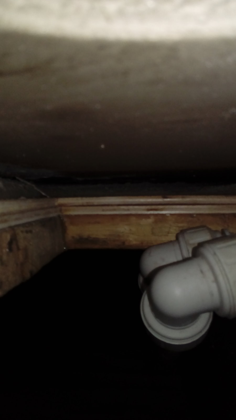

So.....(big deep breath!)...next problem. I have cut a hole in the floorboards for the waste but where this is, there is no support for the tray. I was thinking of trying to get a piece of ply bove the pipes and fill the gap. This is tricky as the tray is now stuck down and the only access is through the waste hole (90mm dia). I was thinking of trying to get some expanding foam in there - easy as through the bendy straw applicator. Will it cure rigid/strong enough to support the tray? The other option is to try and get a full bed of tile adhesive in there. This will be much harder to do due to limited access!
You can see the underside of the tray in the photo and the hot/cold feed pipes. I want to cover the pipes and void with ply, then fill the gap with expanding foam or adhesive slurry....
