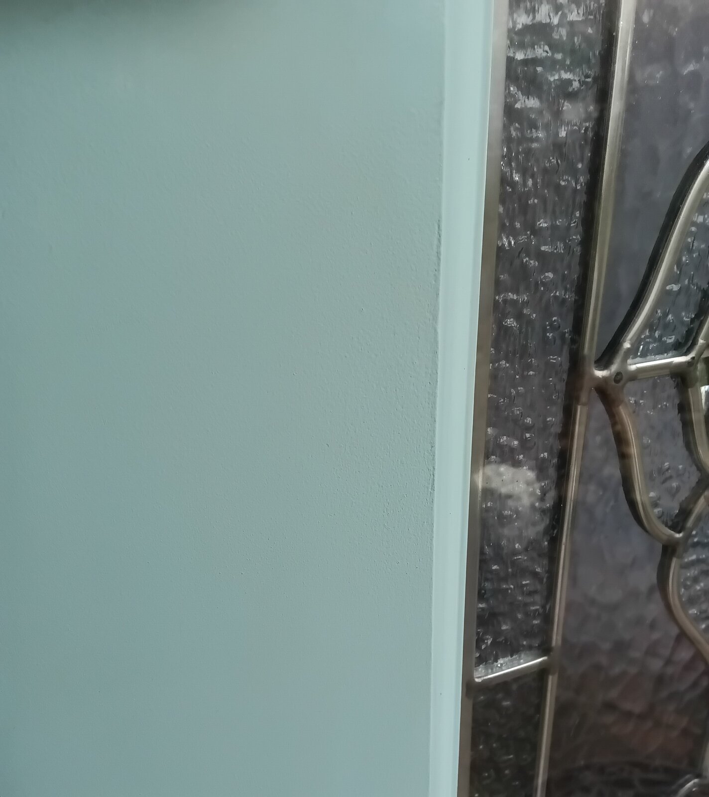

I did my front door in water based paint - not Zinsser - and used micro foam sleeves in thin coats and lay off using a clean sleeve in areas where there were bubbles. I think I used ProDec or Harris, can't remember to be honest. There is a barely visible texture to the paint which is really only noticeable when I run my palm across. The finish is the best I could achieve without spraying. I'm pretty chuffed with it, neighbours have commented on how good it looks too.
In saying that though, I don't know what the sheen level is of the Allcoat Satin, rolling it in the way i've done above, does tend to matt the appearance of the paint in my experience. In the tricky areas, around the glass reveals, where I brushed, the paint has taken on a different sheen, nobody else sees it but I know it's there.

Here is a quick pic up close of my front door which I did in the way I explained upthread. It is a lot smoother than I could have achieved by brushing alone. I did sand inbetween coats with 180-240 grit. It needs a touch up now tbh but you get the idea.
