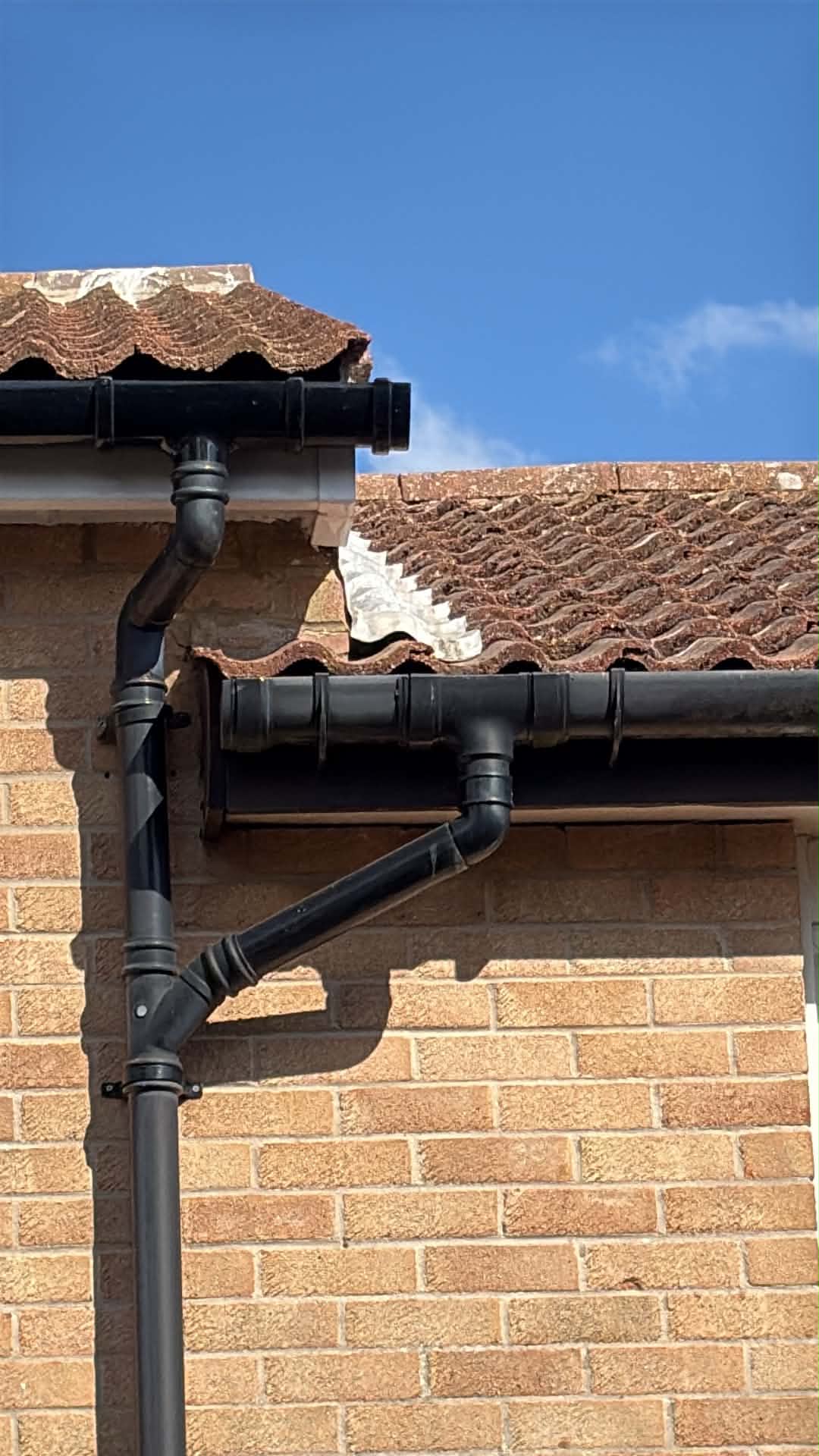

Hi,
Is the lead that cover the tiles okay like that or should be attached? I live in south of the uk
Please let me know
OP,
Best if the lead had wrapped around the brickwork corner, & come down to the gutter. A pic from the side showing if the abutment lead has been turned into stepped chases would help?
more photo's please - from the side (R/H side view of the original photo) and a close up of the end of the lead as in the original photo of yours. is the lead one piece or several?
