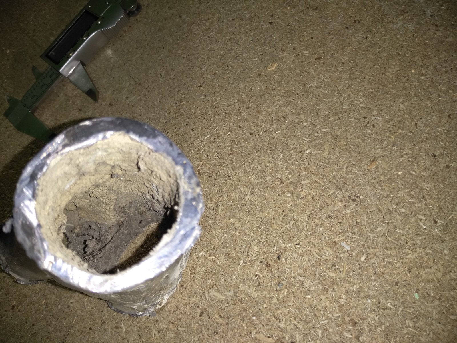

Hi, I measured again the waste pipe. It is actually 45-46 mm outer diameter and 35-36 mm inner diameter. The wall thickness is between 4-5 mm.
Here is a picture of a piece of the pipe I cut.
I cannot install a 110 mm pipe. The connection I am planning to do is in the 2nd floor. From the Saniflo, 3 meters horizontal PVC pipe to the lead pipe. Then the lead pipe goes 3,5 meters vertically and disappears horizontally under the floor of the 1st floor below.
Would it be ok to install the Saniflo in this lead pipe?
I'm no expert but I wouldn’t. The insides look far to rough and I wouldn’t mind betting you'd get a build up of you-know-what on the inside of that.
If you ripped it all out and weighed it in it would probably pay for the replacement piping.
How are you planning on joining the pipework from the Macerator to the lead? Macerators can pump with some force, if a joint comes apart, it wont be pretty.
Better think again, with a 3m horizontal & a 3.5m vertical the sani pump won`t last very long regardless of what pipe you use.
