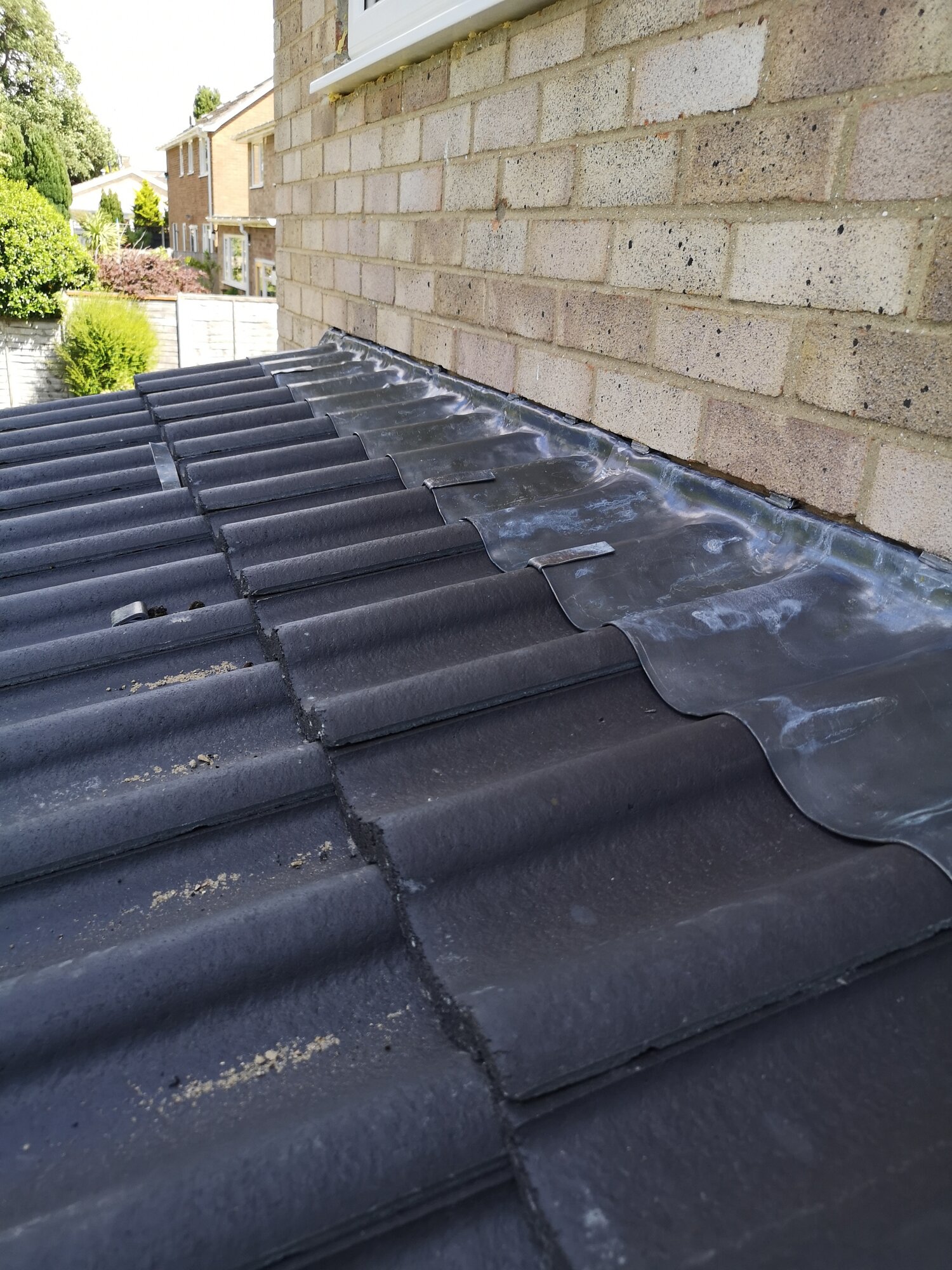

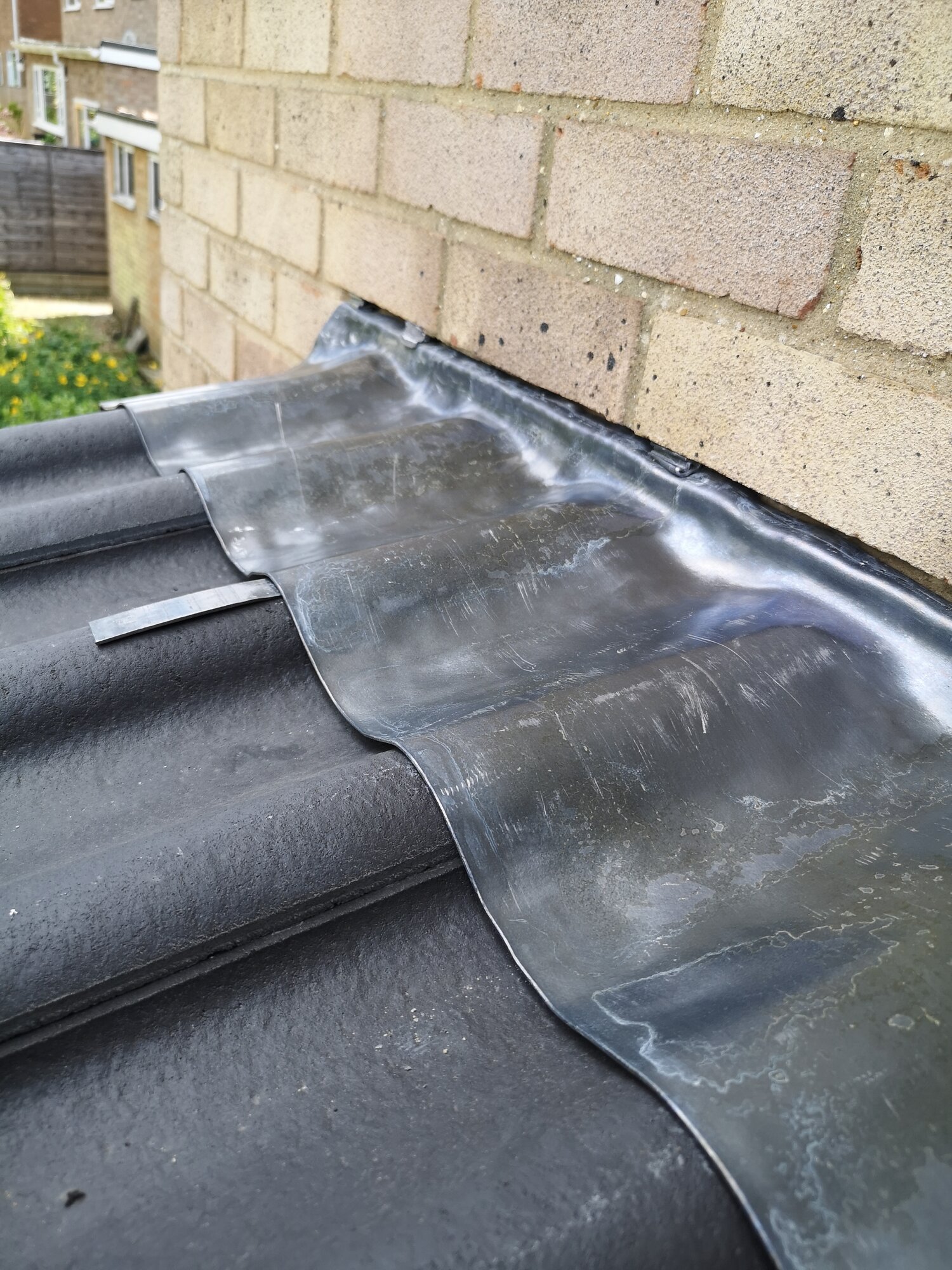

Hey,
I've never done leadwork before. Just trying to form it around the tiles. There are gaps between lead and tiles. Prob about 5mm. Don't seem to be able to get it tighter. Is this nomal/OK?
I’ve seen worse, but I’d be more concerned about the lack of upstand on the brickwork, and the pitch of the roof looks awfully shallow. And don’t d you oil the lead, both sides ?
Shallow upstand can't be helped. Roof pitch is 15 degrees and has to go under 1st floor windows.
Any tips to get the lead and tiles closer?
A little heat and keep dressing, work it from the back to the front
you do not need heat, put hand pressure on top of the tile roll. the keep dressing with a suitable dresser, it will sit down snug if you persevere
Yes oil it when ever you stop. So if you stop and are going to continue the next day oil what ever you have done .
Oil under lower edges and clips.

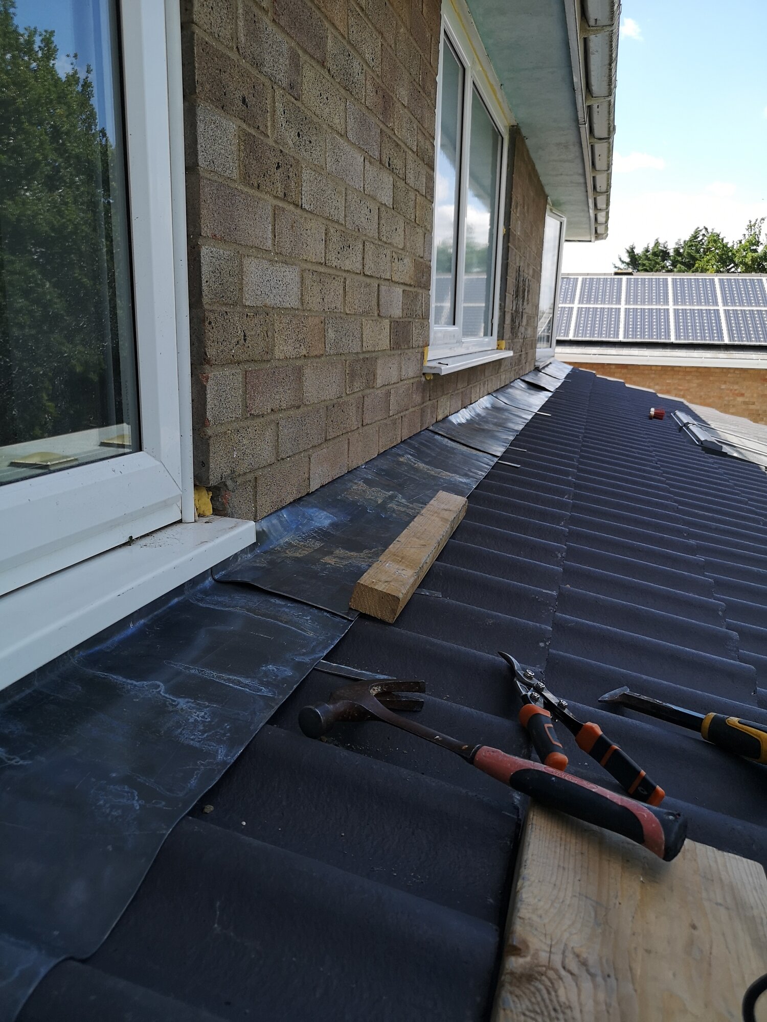

Looking at the pictures , it would have been easier to put the upstand and chase bends in before fitting.
Also you could have gone up to the next joint up in between the windows.
More weather proof. I won't mention cavity trays ....

But you did mention cavity trays!! I did ask the architect and said they weren't needed and certainly wasn't going to argue!! Presumably lots of people who do a lean to extension do not have cavity trays?
He's wrong
Why? Brickwork looks in decent condition, windows are over most of the lead, I'm not in a very exposed position, the overhang from roof above is only a couple of meters away...?? Why would I rip out all those bricks to put them back with only 30% of the mortar?
Think I will stick without a tray.
I'm just pointing out right from wrong.
