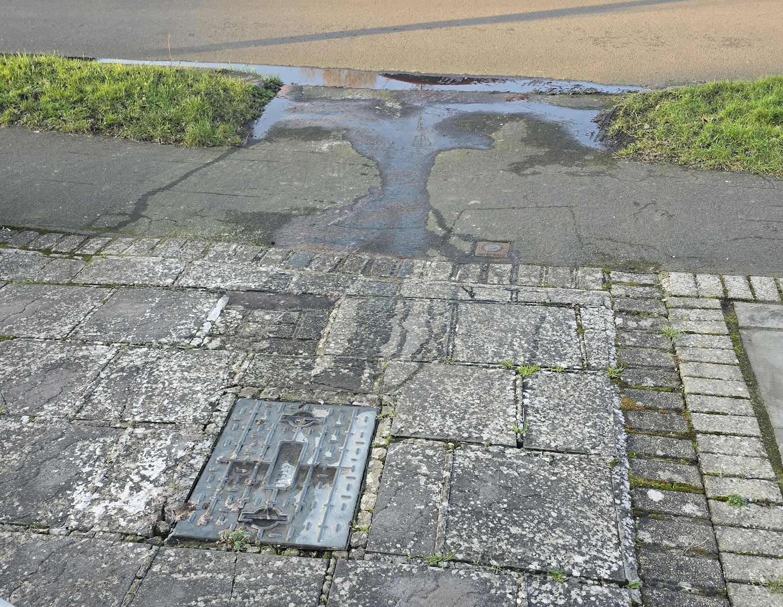

Recently moved into a new property and noticed a intermittant leak from this manhole cover on the drive. The leak smells, so I have a feeling it's sewer related.
Is this something I need to fix, or do I need to notify the water company ?
Lift the cover, and see if do can determine if there is any flow, to me it looks like the pipe comes down the drive - it could be that there is a blockage downstream that is causing the back log.
Best get onto your water company
And stop flushing your toilet or using water in your home
I don't know the answer unfortunately.
I've reported it to my water company using their online form and sent some pictures, so will see what they say.
Unless it’s a shared drain then the water company will probably cover the cost
The opposite! If it's shared then it's their problem.
But the fact that it points towards the road from the house suggests it's probably the homeowner's problem. But nobody can say without lifting the lid and looking.
Gloves on, deep breath, have a look.

Nobody knows where the blockage is, whether it's public or private or anything else without lifting the lid and looking.
I don't know what the situation is where you call out your water company and it turns out the problem was in your own private pipes - it's likely that you'd end up with a bill for £100s.
I had to call out Welsh Water a couple of years ago for a blocked sewer. It was not known beforehand if the sewer was private or shared. I was quoted £140 for clearing the blockage if the sewer was private. In the end it was found to be a shared sewer, so no charge.
A couple of times in the past, at an older property, on lifting the lid on the drain, it was right up to the top with all manner of floaters!!!!! Ewwwwwww
Had to get drain company out....not a nice job.....
Last time it happened i sorted it myself with some drain rods i bought...
