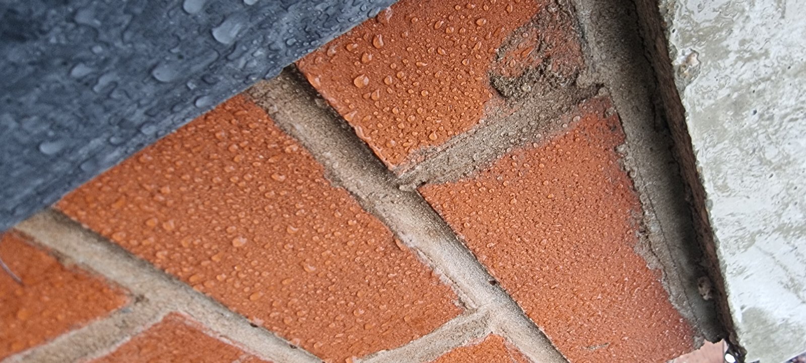

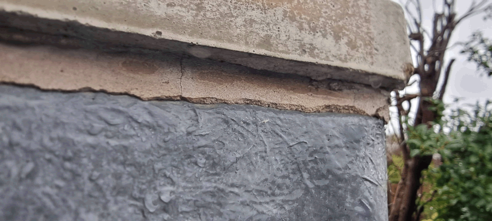

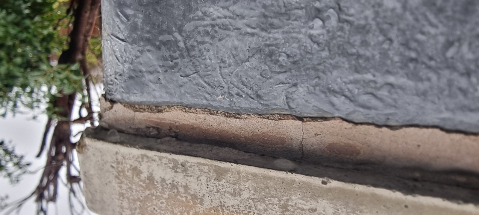

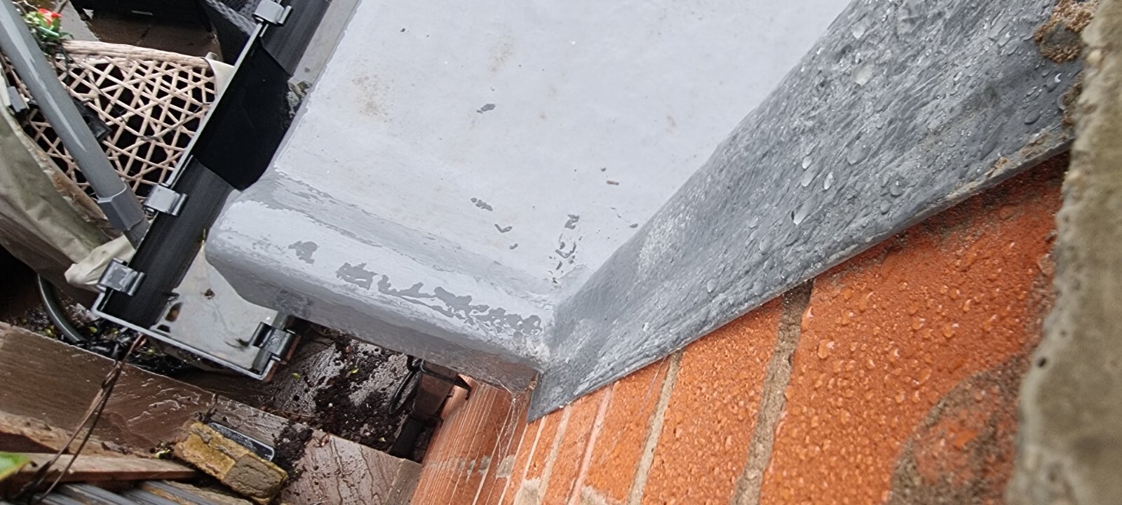

So I climbed outside on the roof. It appears that there is an over hang on the coping stones. One thing that struck me was on one of the photograph the grey GRP moulding is. Should that not be siliconed and maybe it's that place where the water has come inside after snow melted? What does everyone think.

I have rotated the image so that it is the correct way up. I do not understand why your upside down image looked so different.

It is really weird, your upside down photo makes it look like the mortar is bulging out. I took the same image and rotated it by 180 degrees and it looks normal.
Contrary to my earlier post there does indeed seem to be an overhang. I honestly do not know if the overhang is sufficient.

It would be more useful to have an image from a few metres away showing the whole area particularly the areas above the internal damp. Mark the locations of the damp on the image
