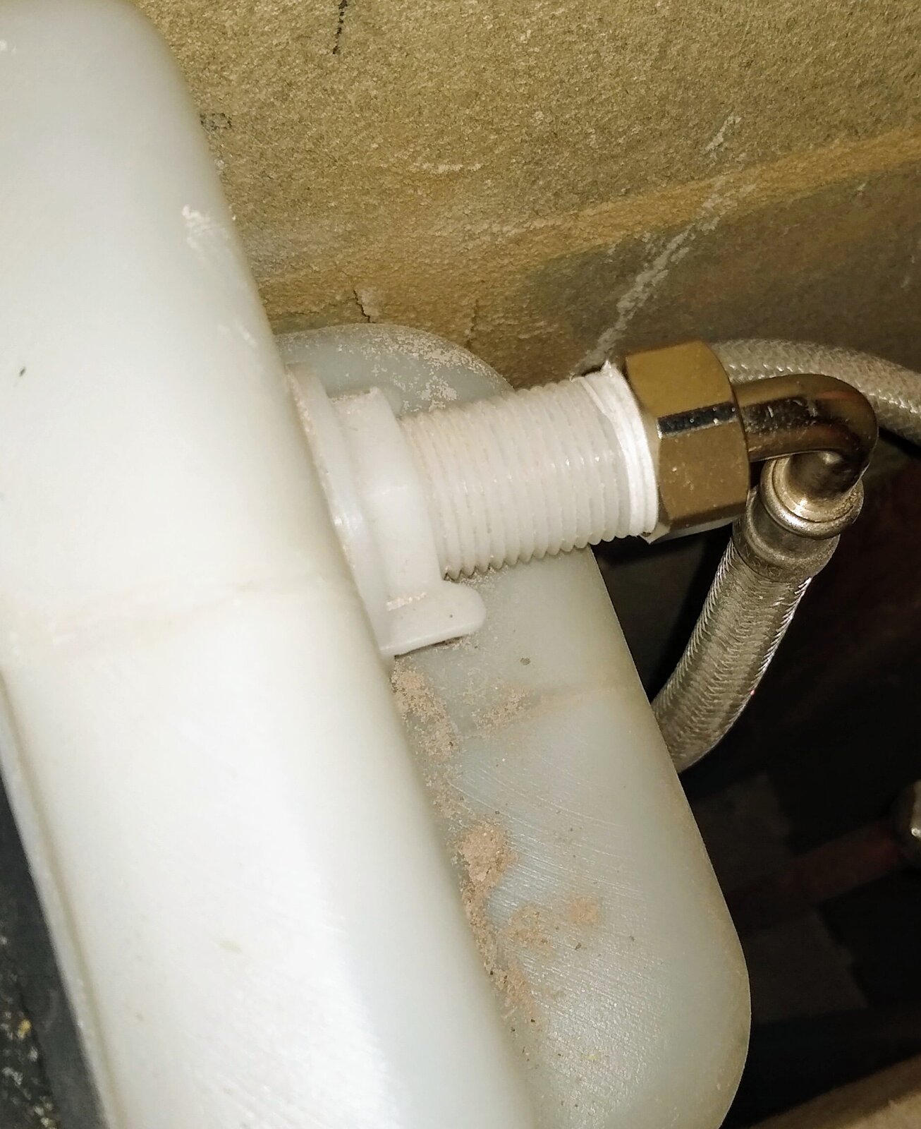

There is a small leak coming from the water supply to my cistern which I'd like to sort out
Is this a case of just nipping it up
Or should in apply something like ptfe or jointing compound?
There should be a rubber washer/seal in there that does the job, isolate the water and take it off and check the seal condition
