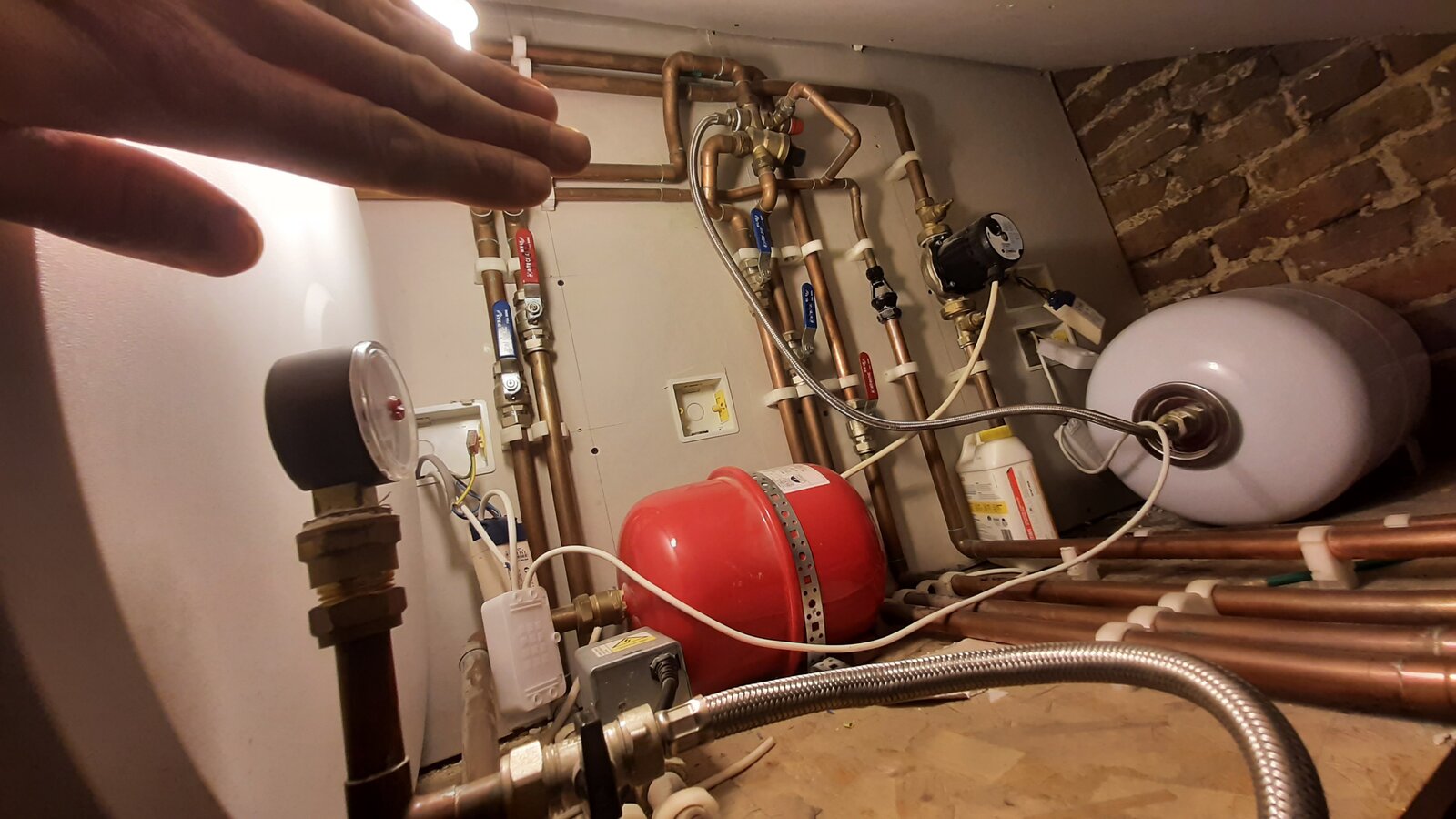

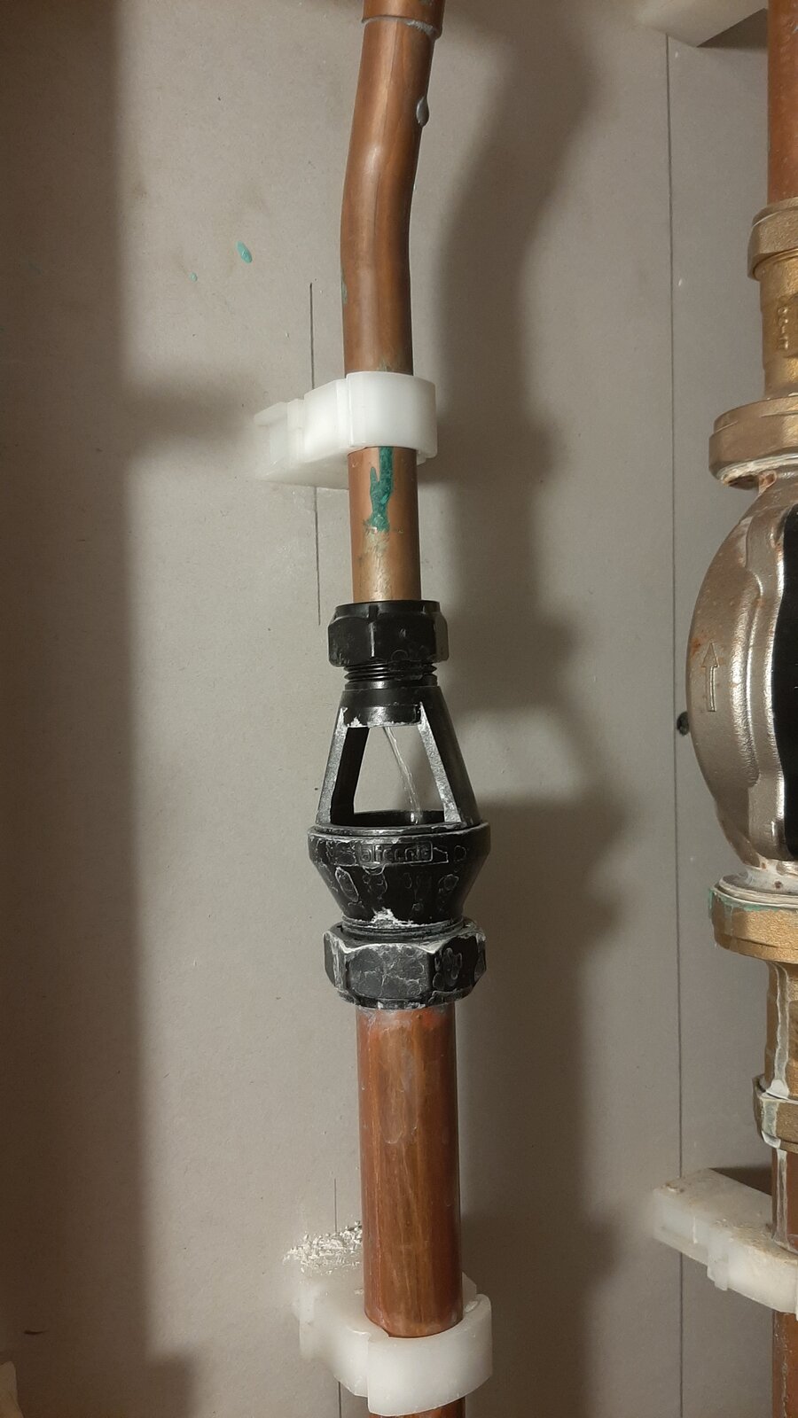

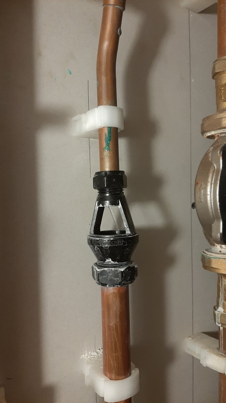

Still haven't found the leak. However, shortly after turning the hw on, a small trickle flows into a recepticle which passes it into a copper pipe which is connected to the soil stack.
Is this to relieve pressure as the water in the cylinder expands? Is it normal /expected?

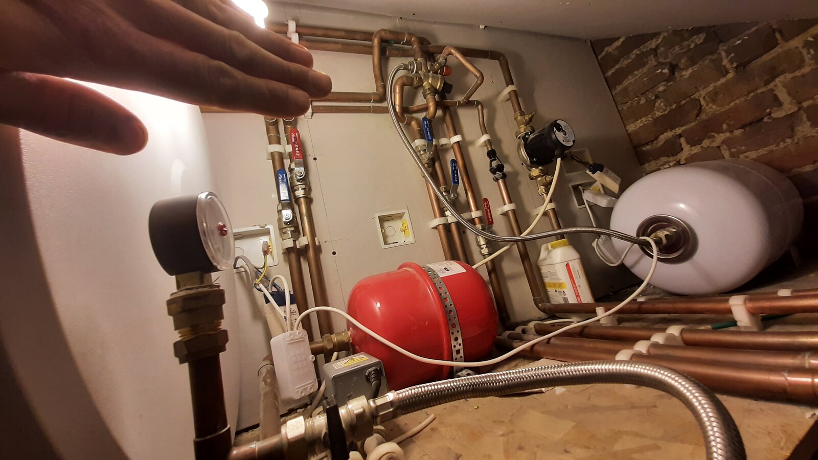

Here's a wider angle
For context, the cylinder is a horizontal gledhill tank just to the left of the pic, just in view below my hand
That's a tundish ,and shouldn't have water flowing through it unless there is a problem,with hot water expansion not being accommodated ,or the PRV is passing when it shouldn't. Probably the former. Have you followed the pipe from the lower part of the tundish connection ,to see if it's leaking ?
That receptacle is called a tundish. It's there so you can see when water is flowing through it, which it shouldn't do under normal circumstances. Not sure those pressure relief vessels will work properly on their sides.
Yes - followed the pipe from the tundish. Can't find any leak yet. I'm leaving it to run a lot longer to see if perhaps a build up is required before the leak starts
But could I speed that process up by pouring fresh water into the tundish?
You could ,but I doubt it would make much difference.
