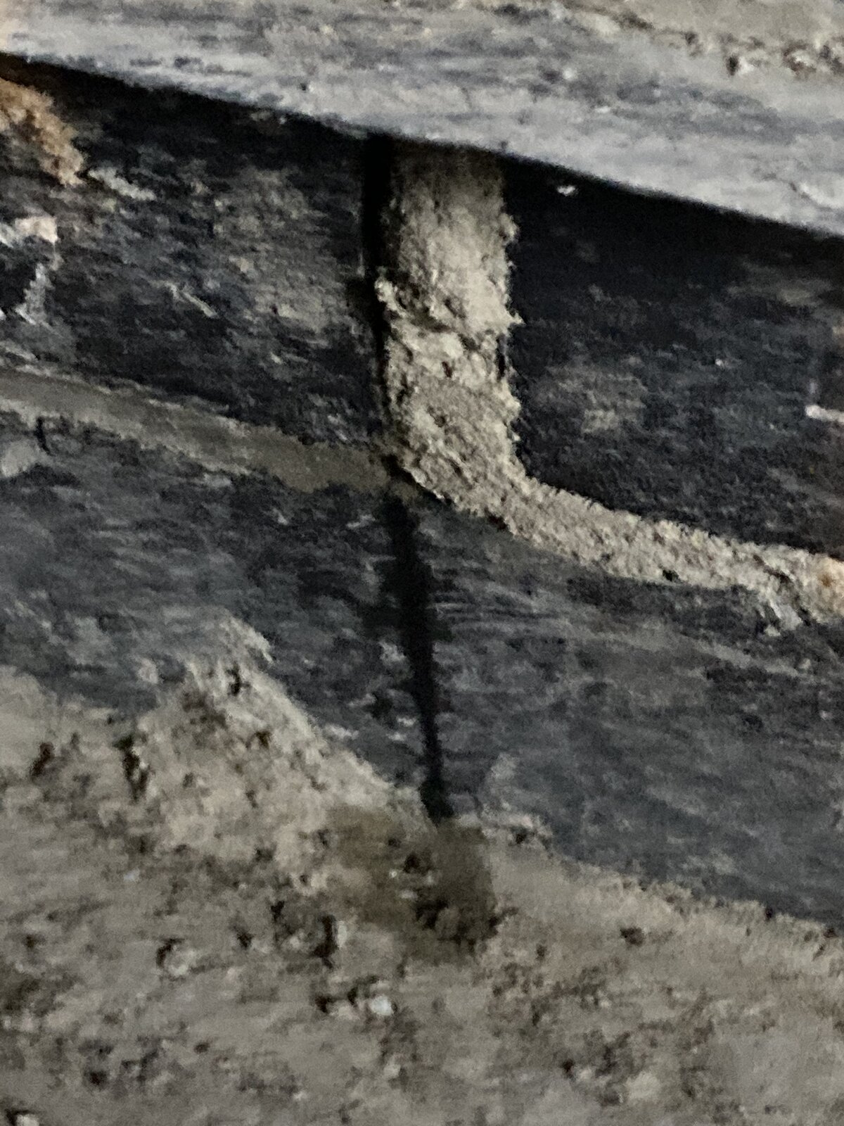

Ok massive thanks for helping by the way. I’ve taken loads of photos and rerun the watering can test.
Firstly the roof. There was a bit of rain last night hence slightly wet. Hopefully you can see that the sides have a “lip” to prevent water run off, this is sealed with some sort of rubbery sealant. The gutter is at the back.
If you look at the fascia you can see where water has run through in one place, this is near where the water penetrates the building. It happens on the other side but you can’t see the water as well so no picture.

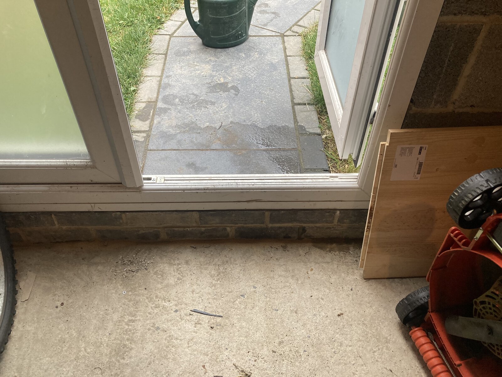

Secondly the penetration and watering can test. I’ve run about 5 litres of water from a watering can without the rose into each - about 30 seconds - and taken photos from the inside. There are 3 suspect areas - one on one side and 2 close together on the other. You can see that it’s coming through the vertical joints which are clearly not right (at least I hope you can, it’s hard to get a good photo)

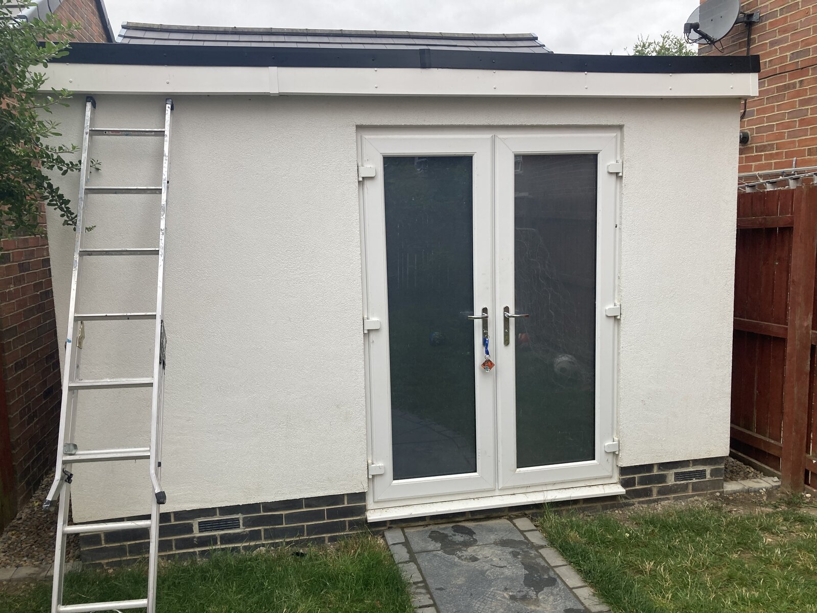

Finally a picture of the building just in case something isn’t clear about it’s construction that matters.

SBR in the mortar mix would have been a good idea if it was only going to be single skin, the bell cast at the bottom of the render should stop most of the water from getting to the engineering bricks. You could try stormdry masonry paint.
I would have expected a brick building to be watertight???
Your expectations are wrong.
Brick walls are not water resistant unless they are designed to be. This means that walls required to resist moisture are built with a water resistant barrier which can be a a physical material lining the wall or an air gap as in a cavity wall.
What you have there is either/ both ground water or rain water wicking through that section of wall and neither of which is a defect of a solid wall.

houses usually have cavity walls, and unless there is a fault or abnormal condition, rain on the outer skin will not make the inner skin damp, even if there is CWI (Cavity Wall Insulation). Solid (nine-inch walls) have less resistance, but are not usually damp unless there is a broken gutter or something making the wall wet. Either of these is an ordinary wall if built of ordinary bricks (or rendered blocks)
blue engineering bricks are impervious to water and damp should not pass through if they have been well built with strong mortar. They are considerably more expensive and would suggest a high-class job unless the builder is incompetent.
sheds and garages often have walls about four inches thick with a single leaf of brick or block. This is called "half a brick thick" because a brick is about 9 inches long. These have much less resistance to damp and water penetration. It is a cheaper build but adequate for an outbuilding. Sometimes a lining will be added later if it is to be treated as habitable space.
painted-on sealants should not be necessary. The actual fault should be found and rectified

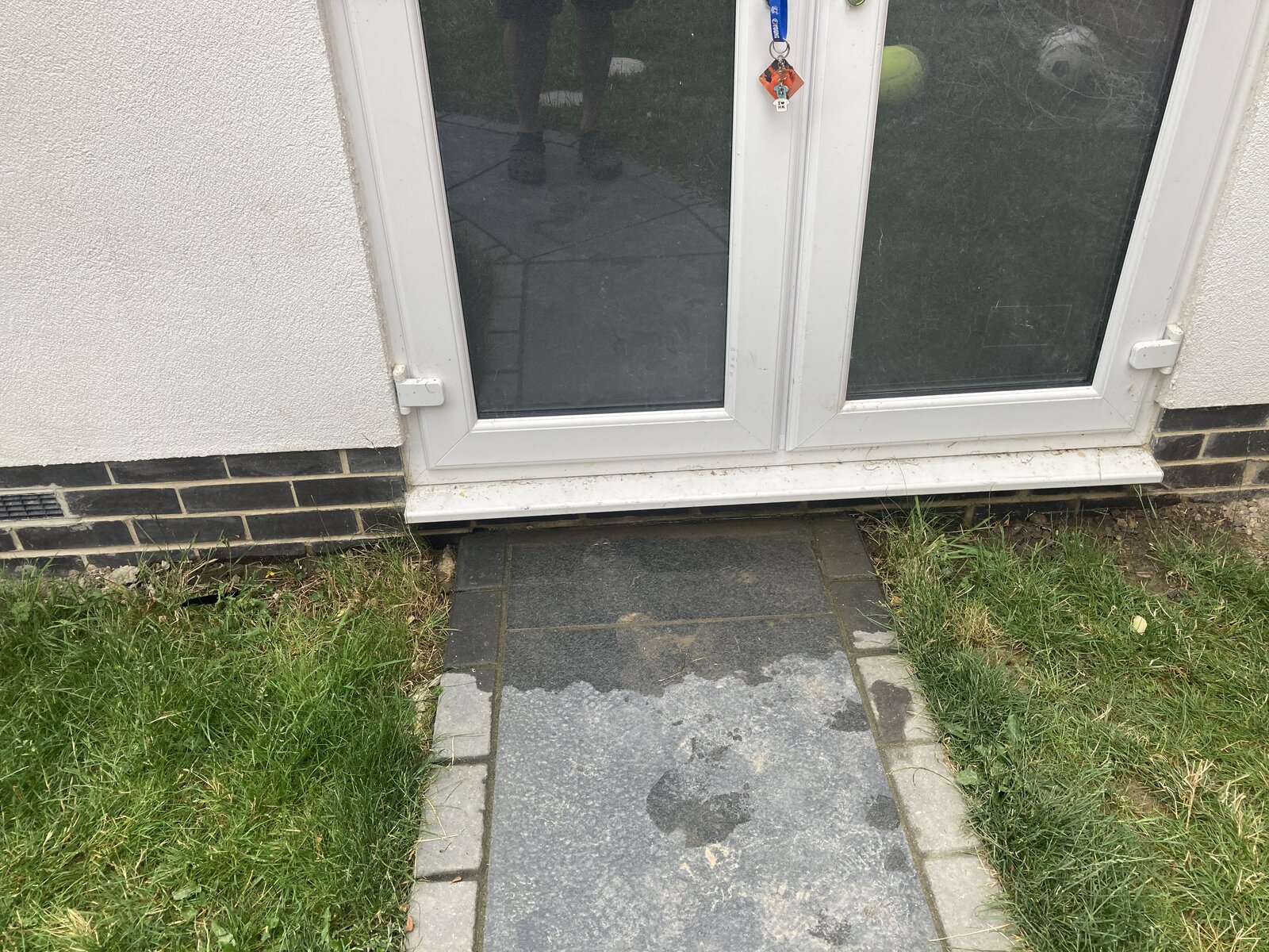

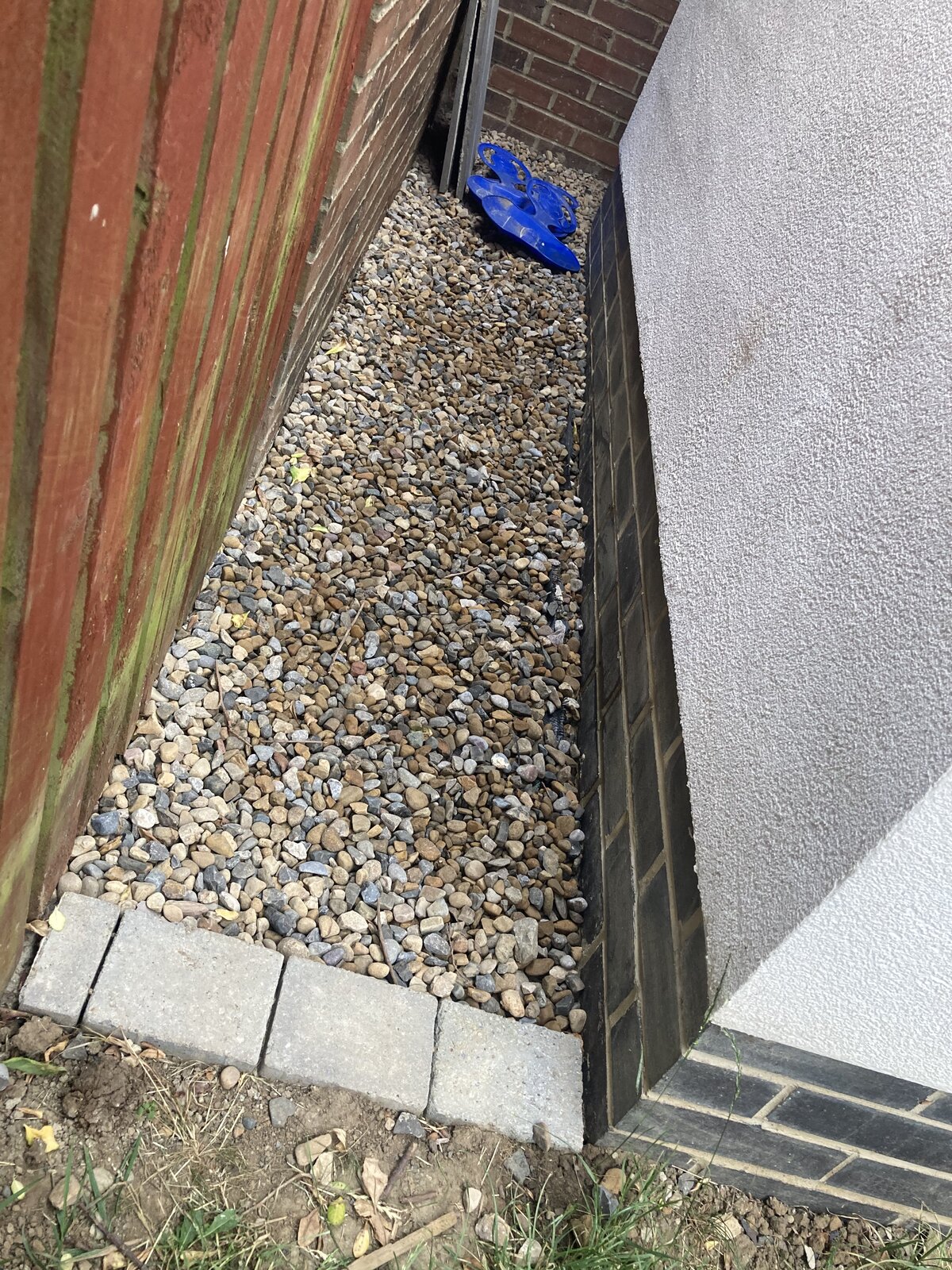

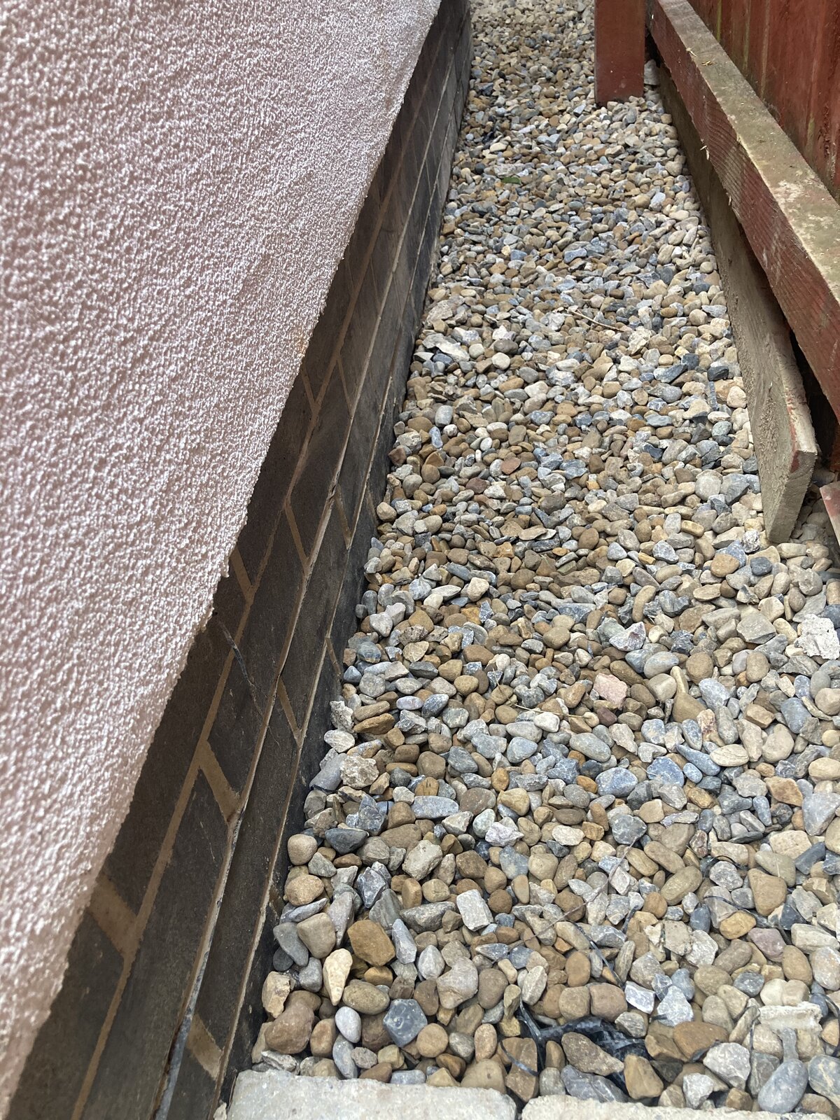

Sorry I’ve made a bit of a mistake. At the sides the slab is below ground level but with gravel slightly above. At the front the slab is below ground level, I’ve just done the watering can test and water does come in.

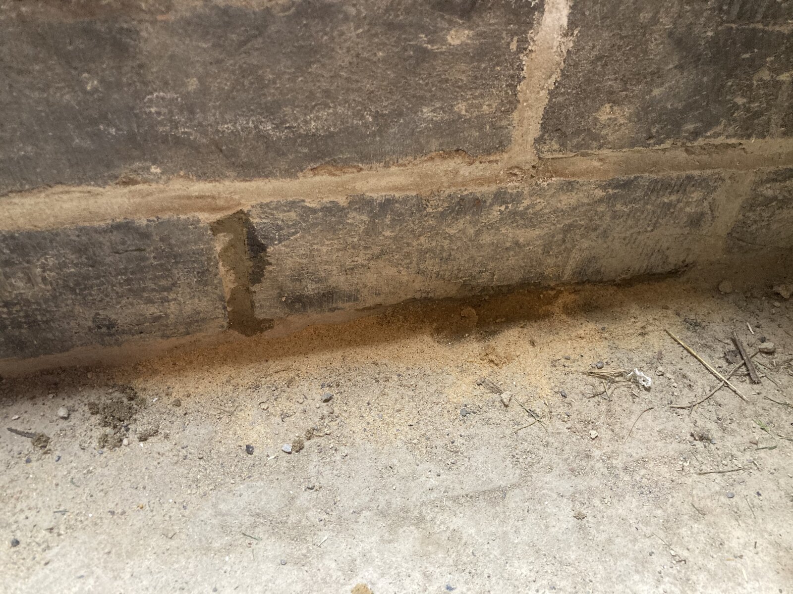

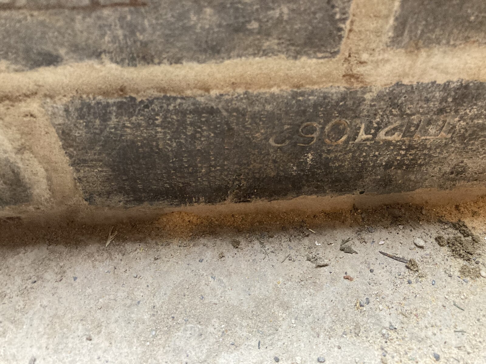

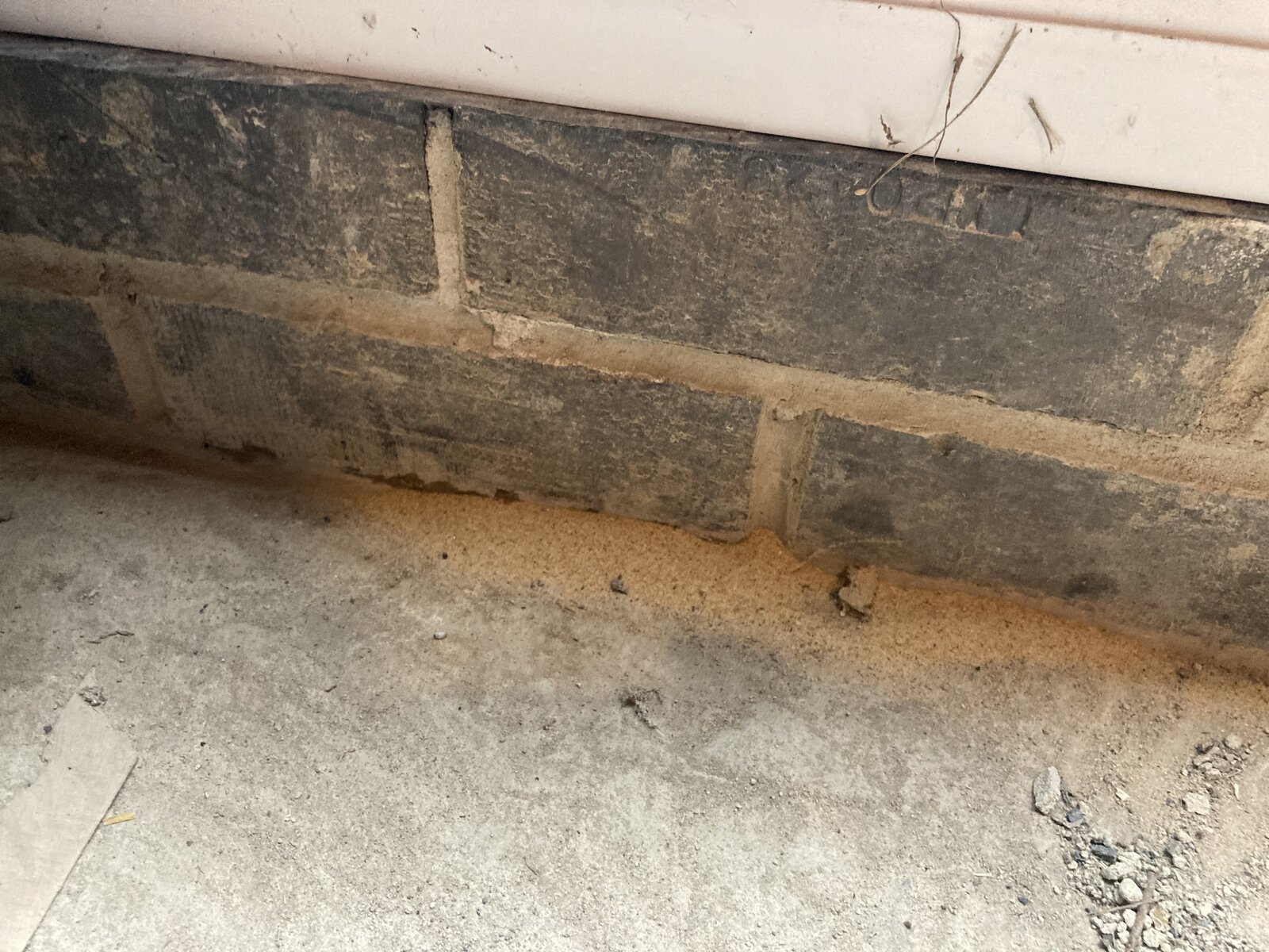

Can you take a photo of the base of the wall externally with the gravel scraped away so we can see the junction between the base of the brickwork and the top of the concrete slab?
I suspect water is tracking across the top of the slab under the brickwork. That's what happens when you have the damp proof course 2 courses above the floor slab and either no damp proof membrane under the floor slab or no lap between the damp proof course and damp proof membrane.
I think the builder has tried to overcome this by using blue engineering bricks but really should have added a waterproofer in the mortar as the mortar joints will probably let the water through.

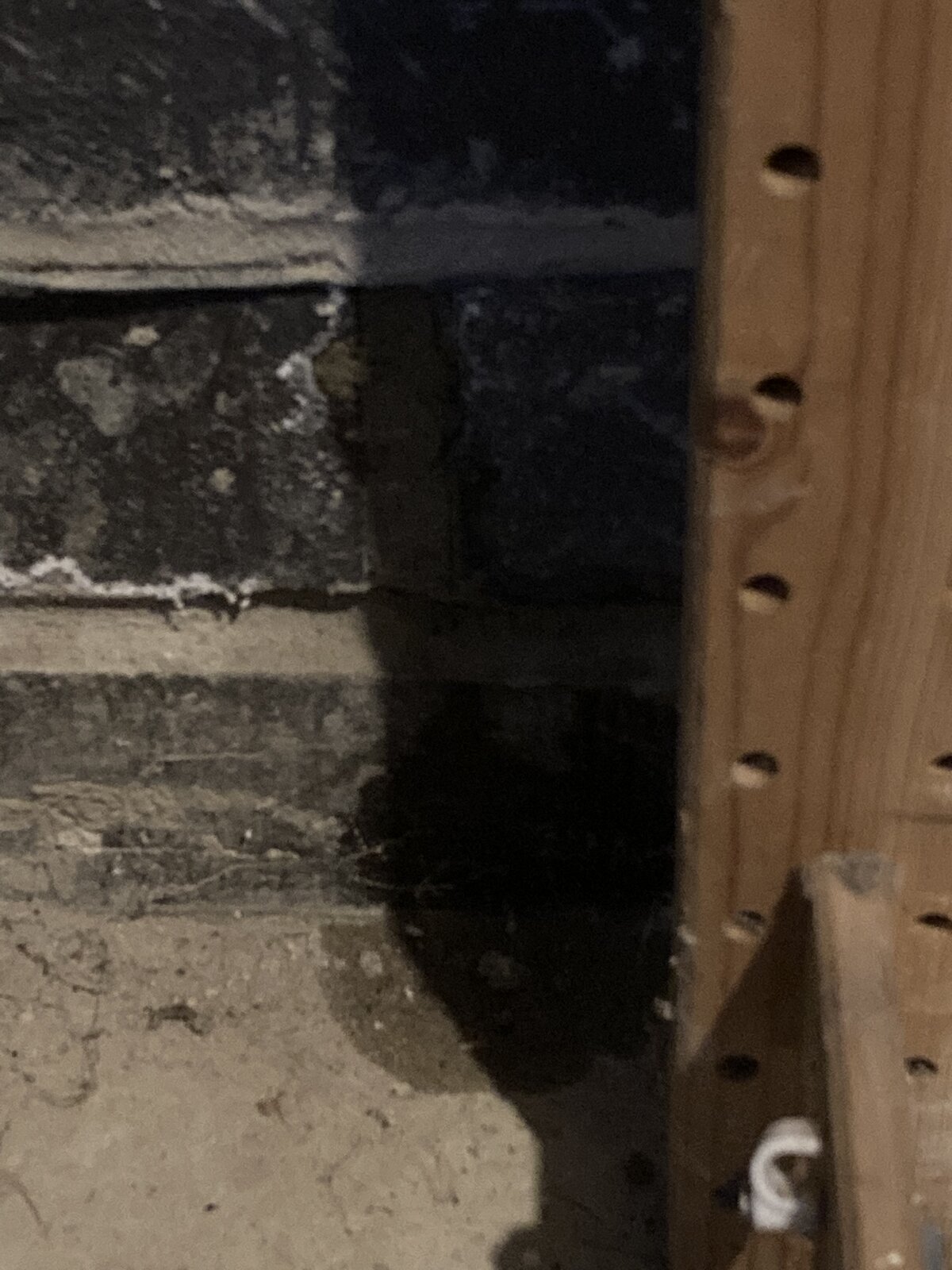

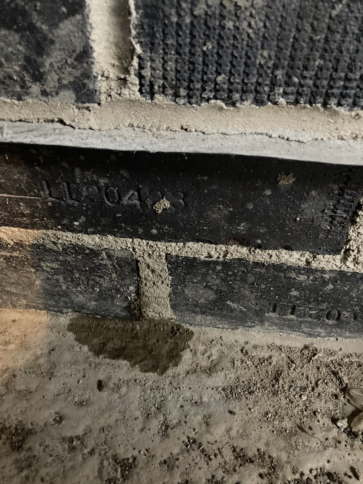

Please see below. There seems to be a DPC at 2 and 4 courses - see internal photo. I’m sure that in at least 2 joints they’re at the vertical joints between 2nd course of bricks ie not caused by the slab. I’m not saying what you’re saying isn’t right just maybe more than one explanation.
I was told there was a DPM under the slab as I asked if I could store things on the floor. Looking at the DPC I don’t think there’s any way that it can be lapped to the membrane under the slab as the DPC is just between the brick courses.
I’m thinking of getting someone to have a look, do surveyors do this sort of thing? I worry another builder will use the immortal phrase “It’ll cost you” which it may well do but I want it to be the right thing to do!!
