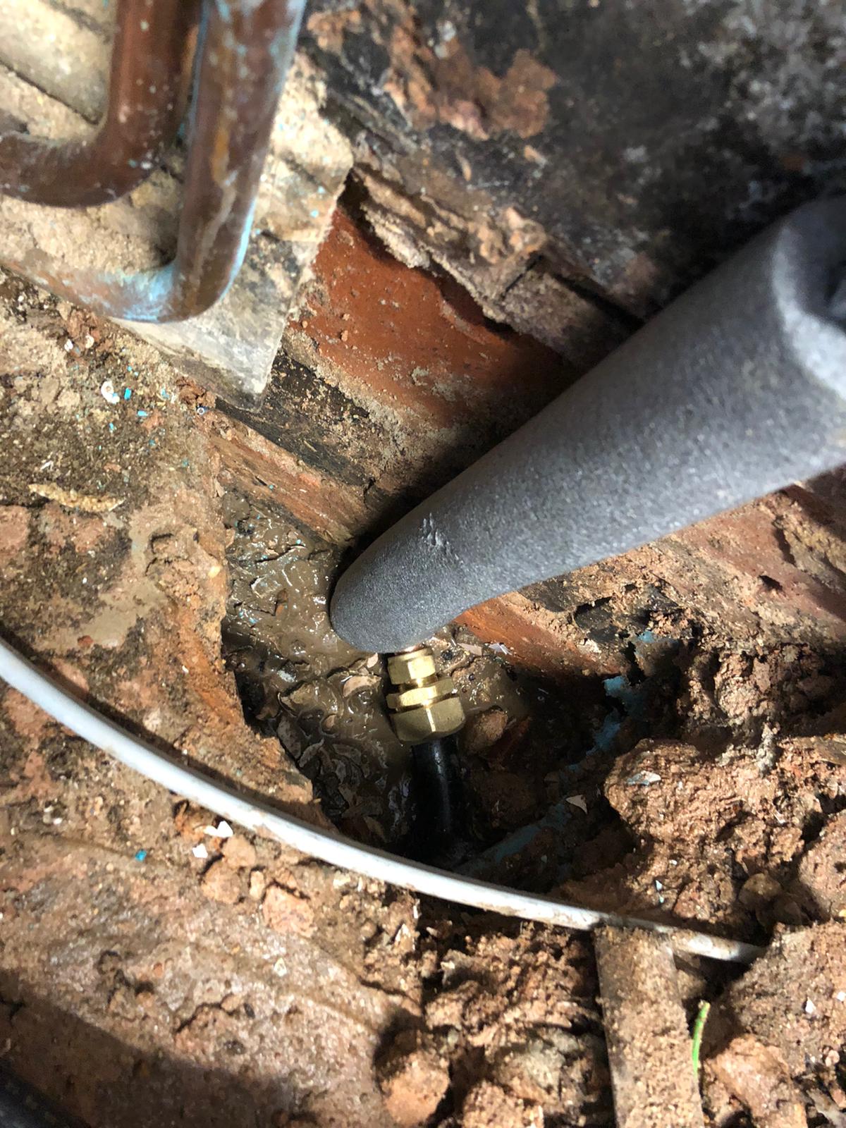

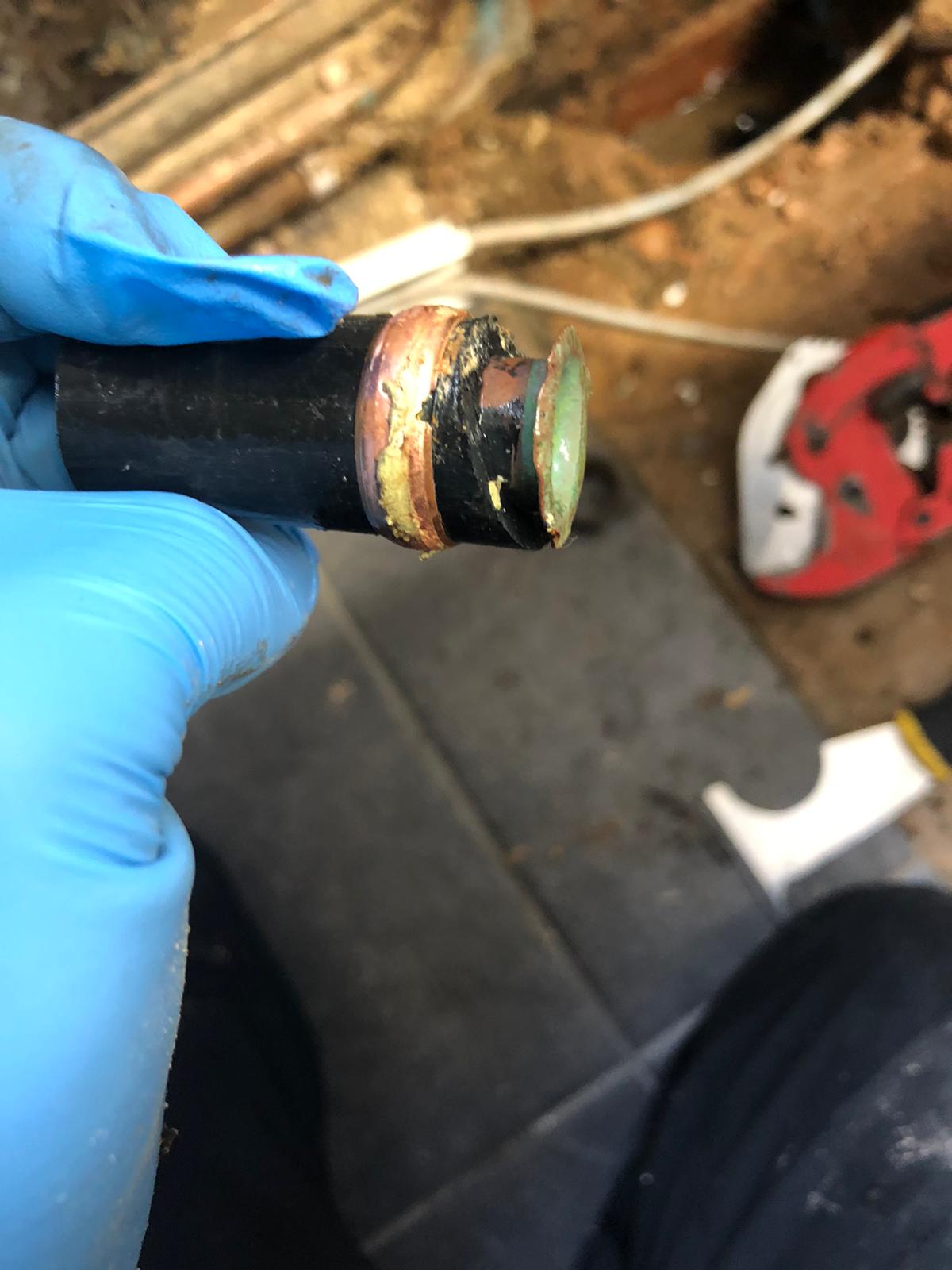

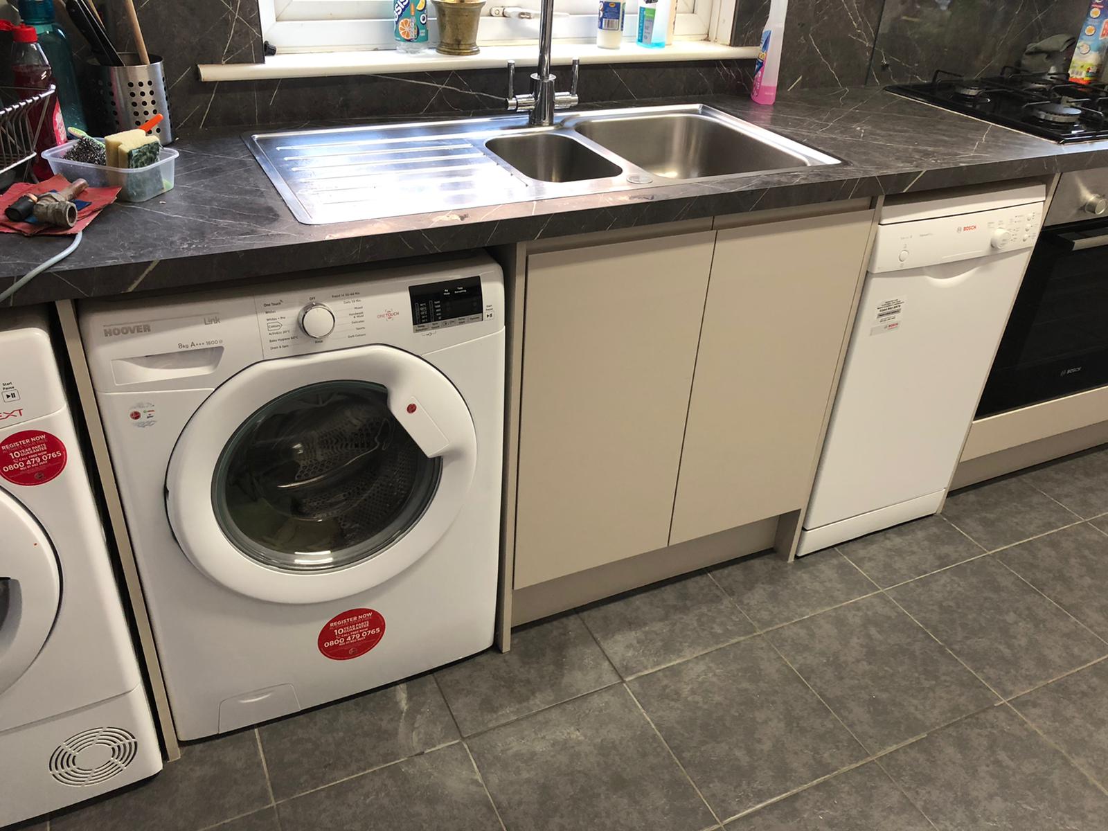

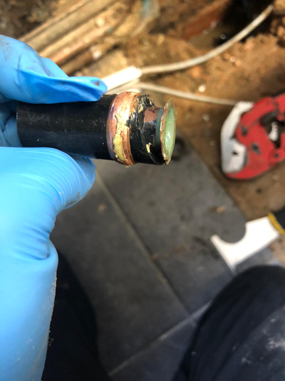

Sorry to bring up an old thread. The works were completed today. Top guy the chap was. Wouldnt even know he has been. Was very involved work. Kitchen sink needed removing from worktop followed by the carcass etc.
Leak was found. It was a joint below ground which was leaking. According him it was the wrong fitting and the pipe was not cut square
He has repaired and made good the area. Pleased the result. Will need to let the floor underneath dry now . Anticipate it will take a while and hoping for no lasting damage

I hope that brass compression fitting underground is dzr (dezinctification resistant).
He did make a song and dance when he came to quote and said the fitting is likely wrong and that he needs to ensure the fitting is suitable to use underground.
He did go away for an hour and said he needs to go and buy the specialised fitting.
