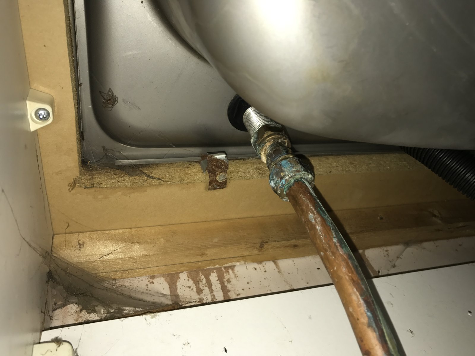

Hi all.
Got a little project on my hands here. There is a constant drip from the pipework under my kitchen sink hot tap - currently filled a baked bean can over about 3 days. Previous owners solution was to tie a Jay cloth around the pipe but I was hoping for a more satisfactory solution without phoning a plumber. Could anyone advise on the procedure involved here? Any advice much appreciated.

Fitting looks quite long for a simple tap connector. Does it have an isolator built in?
I would cut the pipe a bit lower and fit an isolation value and then a short bit of new pipe in the other end to a new tap connector.
I am not a plumber but for me not being very experienced that seems the simplest and most fail safe way for me to do it.
Depending on your level of competence, you could try these as a simple route. You can also get flexi pipes with built in isolation valves as well.
