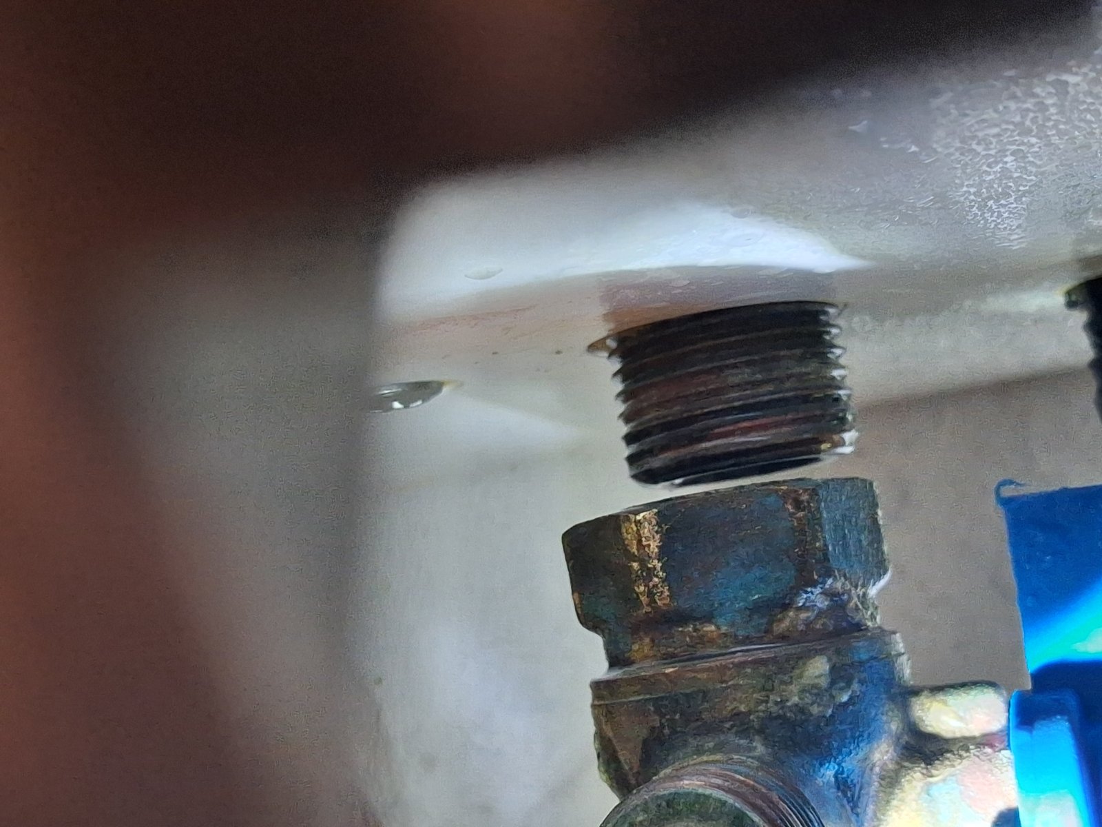

Hi ive got a leak to the cold feed to my boiler can anyone advice if this joint should have some type of washer or joint compound
Any advice is very much appreaciated

There may be the remnants of the old fibre washer trapped in the nut that you screw onto the treded pipe. That needs to be dug out before you insert a new fibre washer. The outside diameter of that must be of a size to fit closely, but not tightly, into the nut.

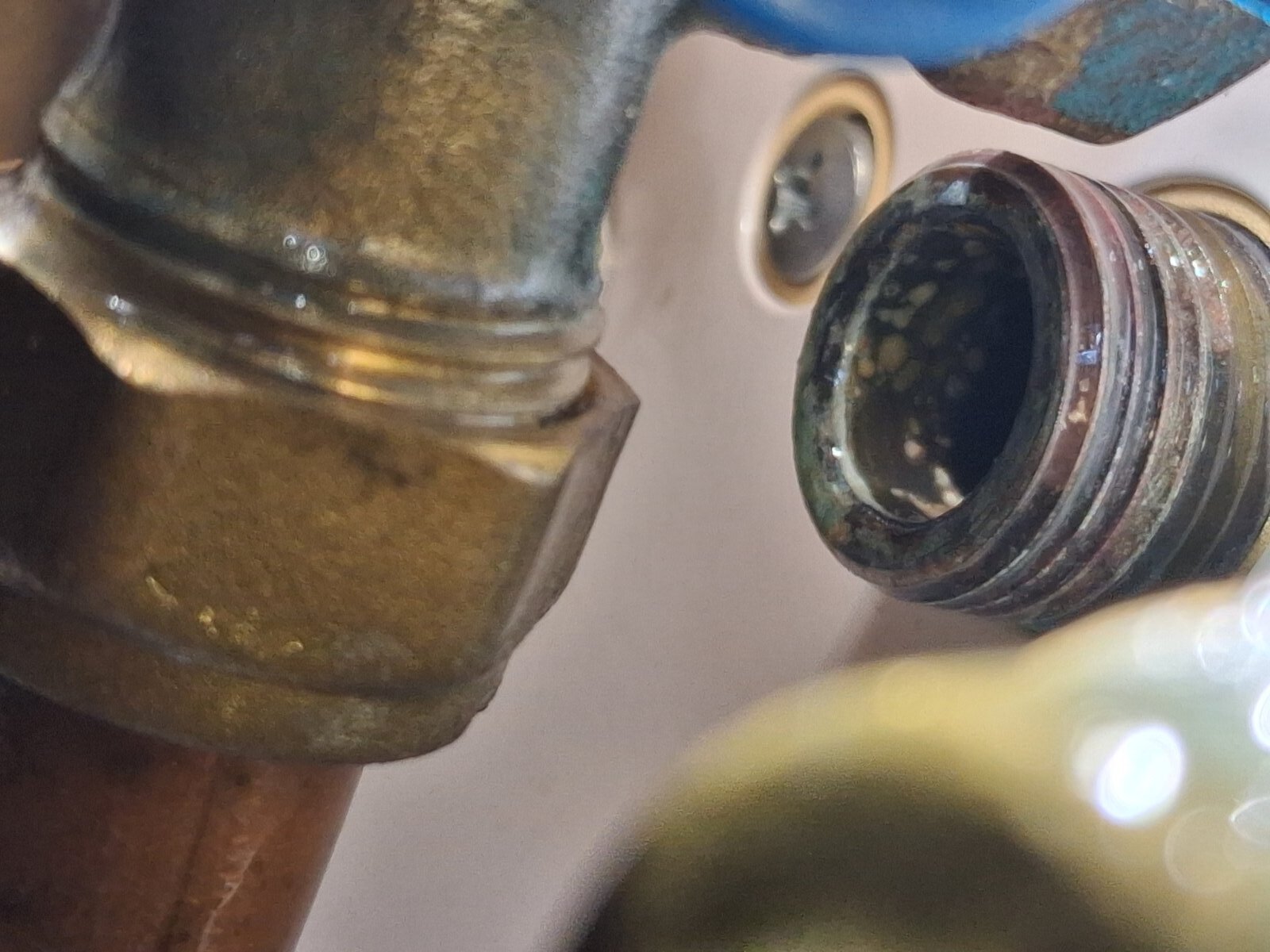

Thanks for the replies. When i push the nut down i can see the top of the inner part and its just metal definately no remnants of any washer
It must be somewhere in the fill pipe then. Can you try to flush it out?
