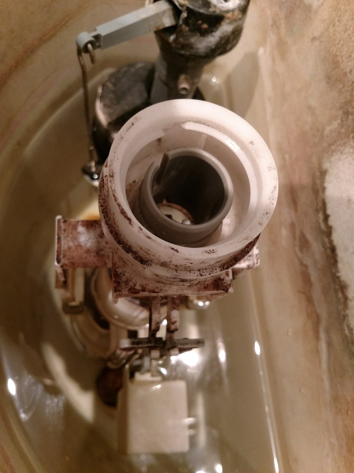

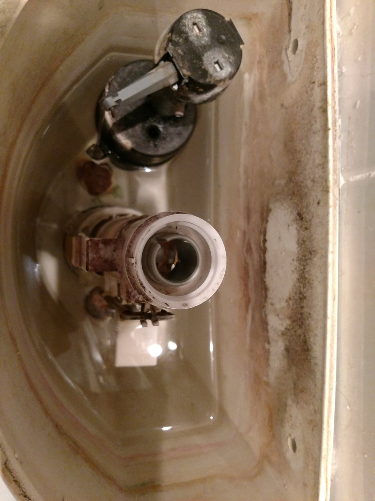

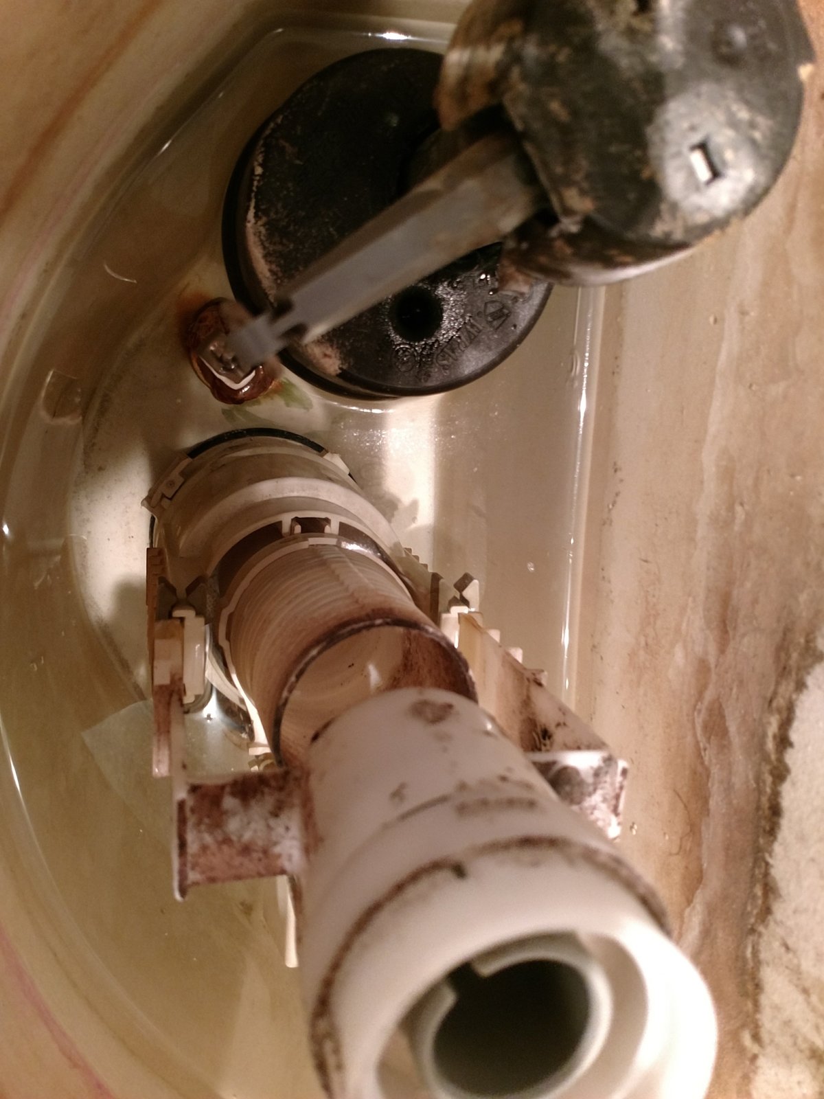

Hi,
I have a very slow drip from the flapper into the toilet which is causes the cistern to fill for a few seconds every 10 mins.
It is quite old and was wondering if anyone could tell me what size flush value seal I would need for this type. I have no idea if they are standard.
By flush value seal I mean the rubber thing at the bottom that seals against the bottom of the cistern, looks like a big washer i think.
I have attached some photos.

For the price of a new seal, if you can actually find one for it, you're probably better off just replacing the flush valve itself.
If you wish to try though, you may actually be able to pop that flush valve out, 1/4 turn anti clockwise and it may click and then lift out and then see what seal it needs. If it doesn't click loose easily when trying to turn then don't force it as it may not be modular.

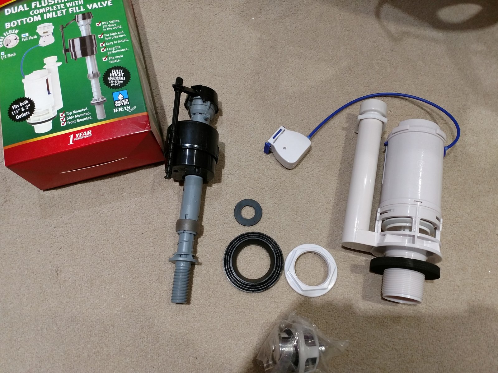

Got both of these yesterday.
Just to make sure I'm not over complicating this. To just replace the flush valve I need to completely remove the cistern?

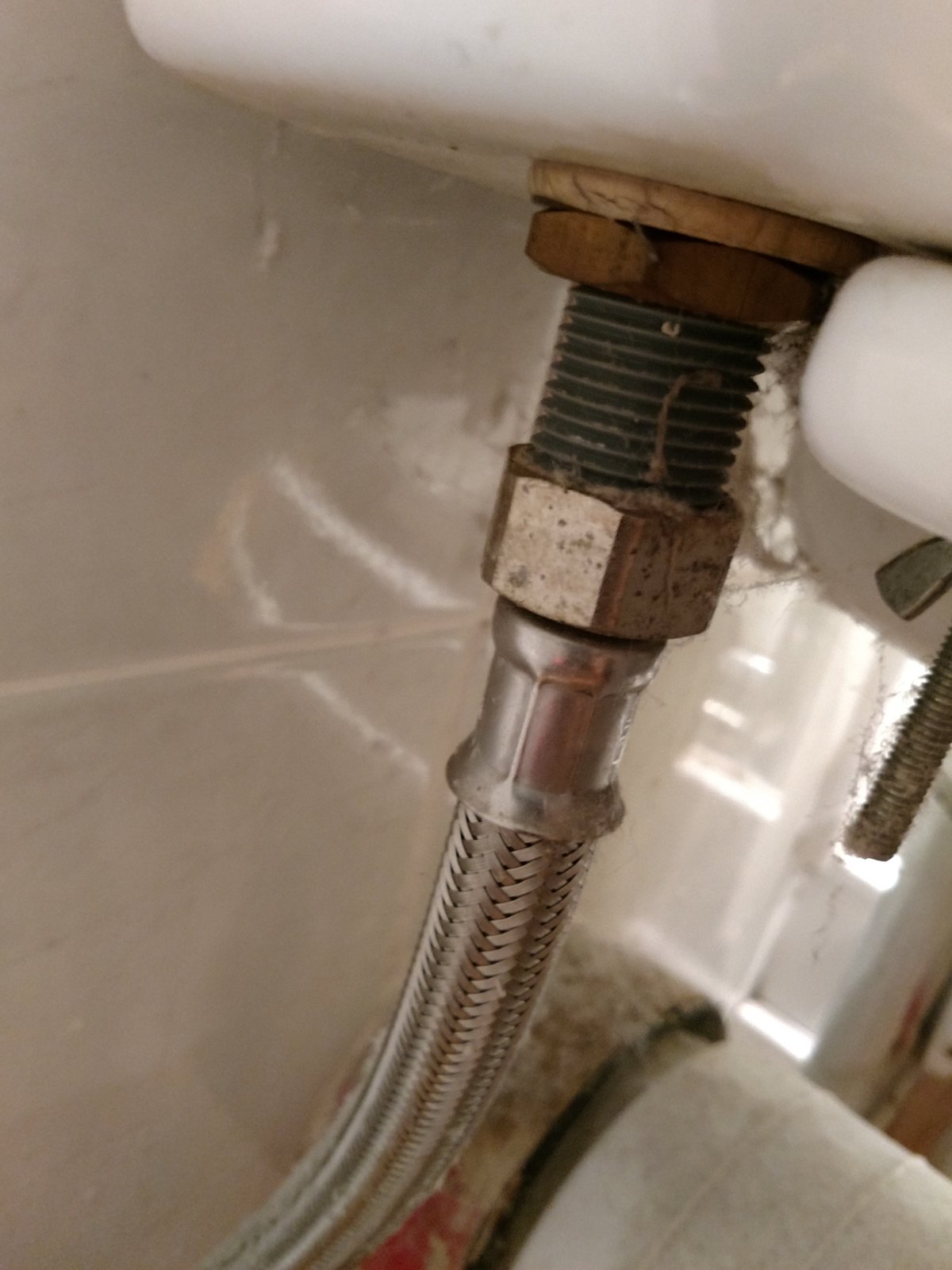

As your pics only show the inside of your cistern ,can you take pic of the water supply pipe ,from below where it meets the fill valve tail. To answer your question ,yes the cistern has to be removed from the pan to fit your new flush valve. Before starting you will need a few other things. A pair of bolts and sealing washers set for joining cistern to pan ,as the ones currently there will need to be dumped. You will need a "do nut " washer ,this makes a seal between the cistern outlet and pan. You may also need a new seal between the fill valve and supply pipe ,which may be the type advised by Andy. But you may need a different type ,depending on how its currently set up ,hence me asking for a picture above.

Cheers ,the pack of seals that Andy ( Hertsdrainage ) suggested you buy ,are not suitable for the flexi hose that connects to the fill valve. The current rubber seal that's in there may be re -useable if in good nick. If not you need a 1/2 inch rubber seal. You will Also need ALL of the items I advised on ,in my earlier post.
Just took another look at your components ,and there should be a small nut ,that goes with the fill valve.it is the one that secures it to underside of cistern...do you have it ??
Make sure its not inside the flush valve !! You can probably use the one currently holding the existing fill valve in place ,together with old washer. But you should have them with the new one though.
Yeah sorry it was loose in the box. It's a plastic nut and it did fit onto the bottom of the fill valve.
On the thick black plastic part of the fill valve that moves up and down. The bottom part was separated away from the top half when purchased. I managed to squeeze it back together. Hopefully it's not faulty.
