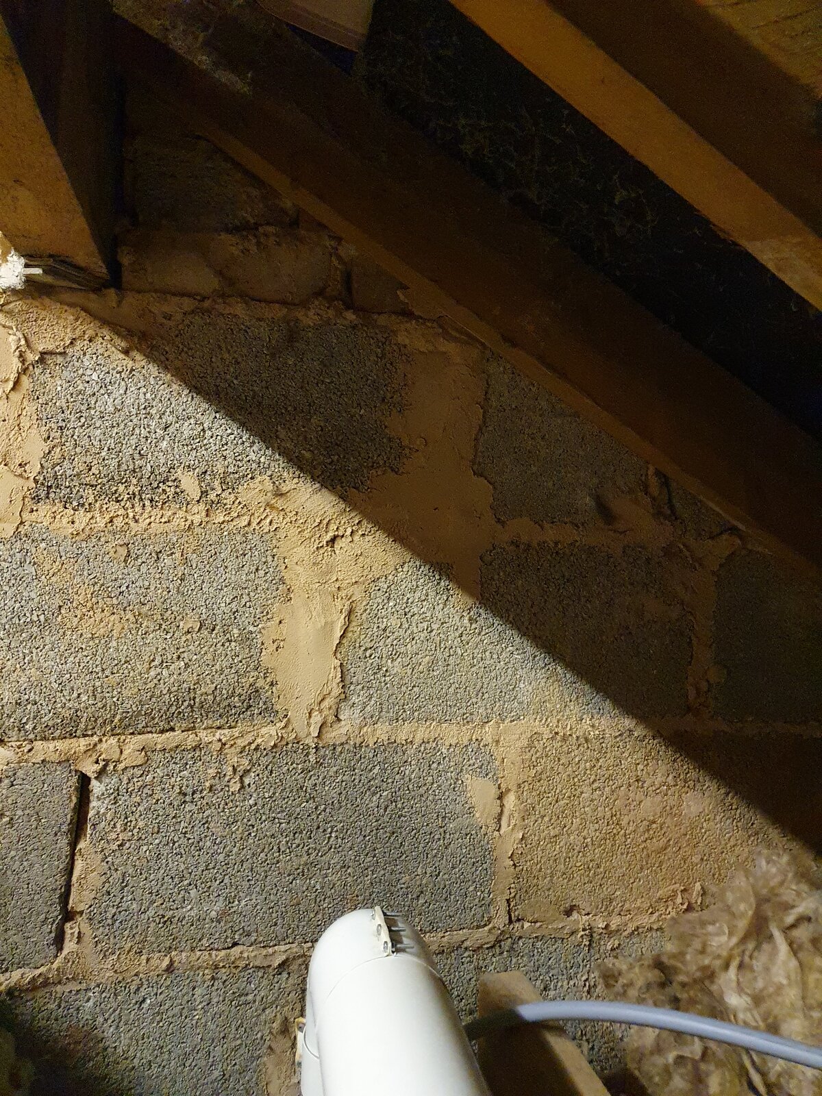

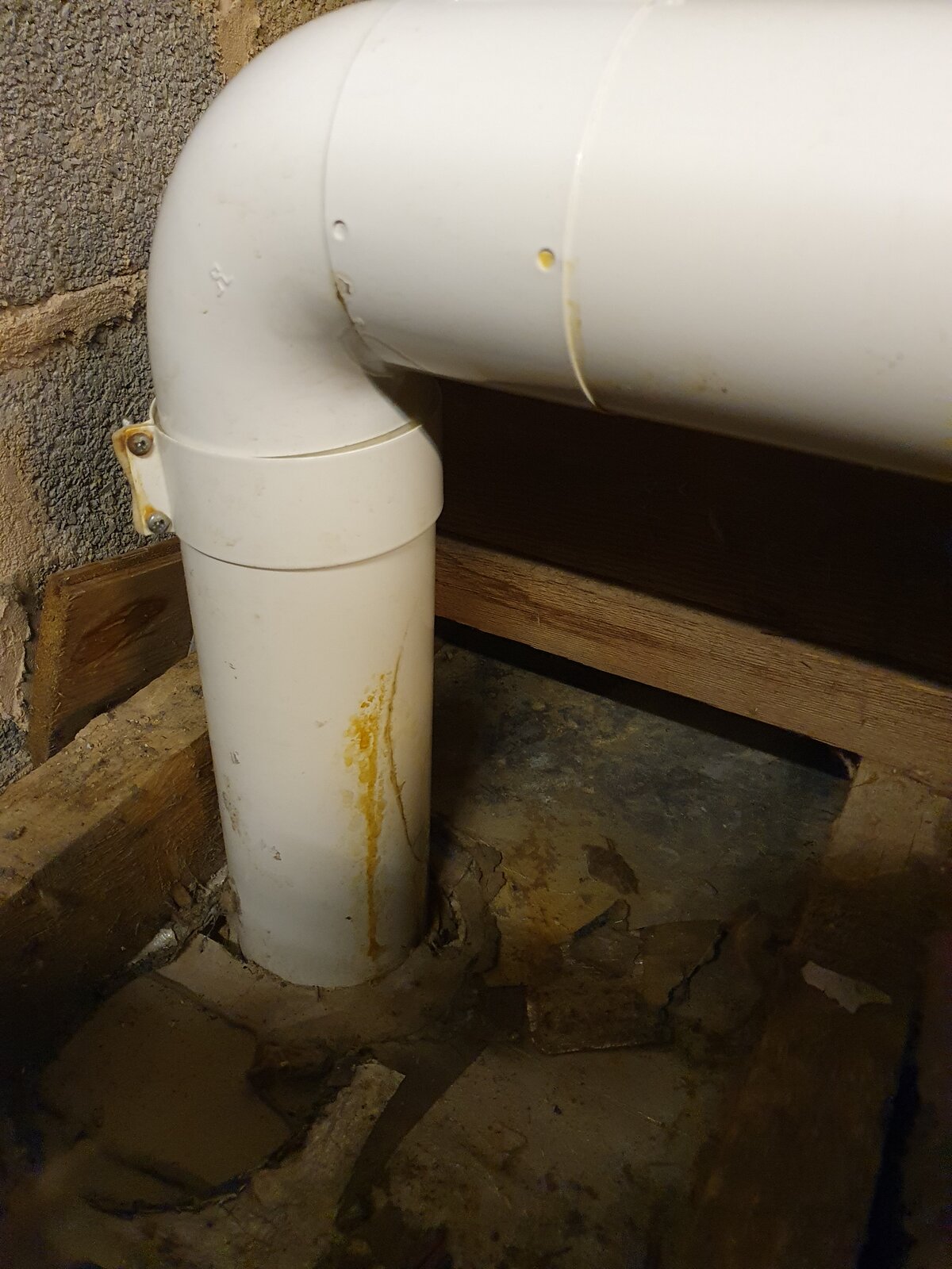

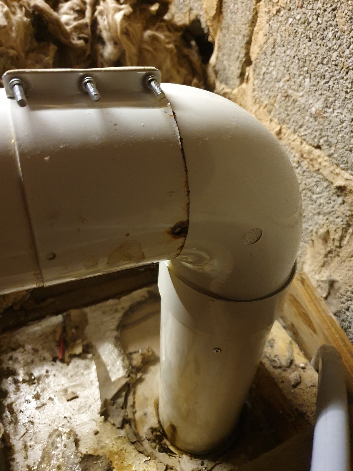

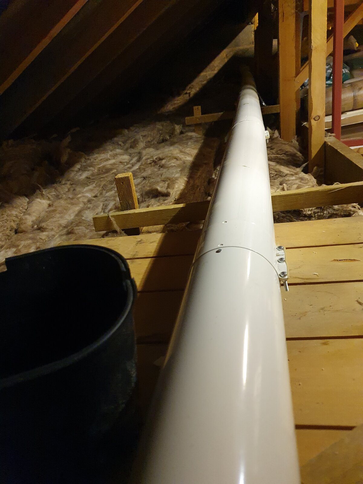

Hi I'm after a bit if advice. When I was up in the loft the other day I noticed that the insulation was soaking wet under the boiler flue. After a bit of looking around I noticed that there was was water dripping from the bend on the flue where there is a connection. Could anyone tell me the cause of this? As you can see by my pictures it's obviously been going on for a while.(moved in a year or so ago). I am am actually thinking of having the flue removed and having it vented thru the roof instead of the current set up where it goes the full width of the house is this the best option
Many thanks
Dave

I’ve never seen anything like it!!!
The thing is , that’s cost a fortune.
Change to vertical, through roof.
Almost certainly illegal due to length of run, seals are leaking probably due to incorrect fall on pipe & clipping. Flue gases could be mixing with clean air. Wow.

OK just a quick update had someone round to check and there is a split in the inner flue and that's what is causing the problem. He did say he could replace the flue but at 8.5 meters long and the fact the boiler is 14 yrs old I don't think it's really worth the cost. So I've decided to have a new boiler installed and moved into the loft but on the gable end wall so it can vent directly out
Many thanks for your advice
