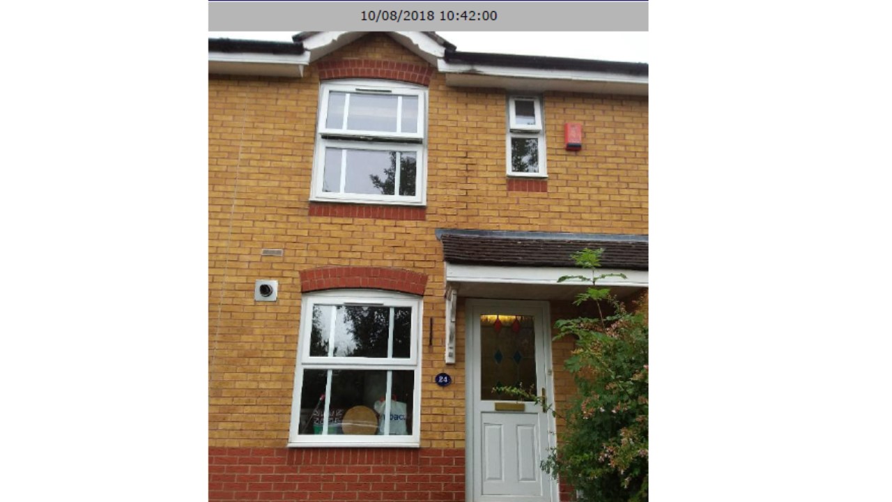

leaking gutter?
8 Nov 2007
206
3
Aberdeen
Hi
as shown in the photo, there is a black stain on the (wooden) fascia of my house (right hand side) for many years. Yesterday after heavy rain, I noticed there seems to be a vertical water mark on the brick wall just below that. Is it because there is an overflow in the gutter above there and the wind blow the rain water onto the wall?
Thanks for any advice.
Probably. If the gutter overflows or leaks at a joint it needs put right.
looks like it might be a roof issue .
The water is running behind the gutter as can be seen on the fascia.
The nearest gutter union is to the far right.
Thanks for all your replies. While the stain on fascia is unsightly, I will leave it until I have the money and time to have the timber fascia replaced with upvc in the future.
Like Woody says .........and I think the water is getting into the fascia/soffit box then running down the wall. You might be able to extend the valley temporarily with some " flashband" thus stopping the wall staining (and more water on the fascia)
it could well be the grp valley is short , or it could simply be the bottom tile channel is cracked off, hence running down the outside of the fascia. either way an easy fix.
while you are waiting for the plastic fascia you timbers are rotting.....

Hi
I am in Bristol. Just got a quote from a contractor saying
“I think this could be due to the gel being rotten. It would mean stripping a few tiles then re dressing some lead so that water from the roof and valley ends up in the gutter not on the fascia.
Cost to do this would be £224.00 + vat. This requires 2 men as someone will need to foot the ladder."
Do you think this is reasonable?
