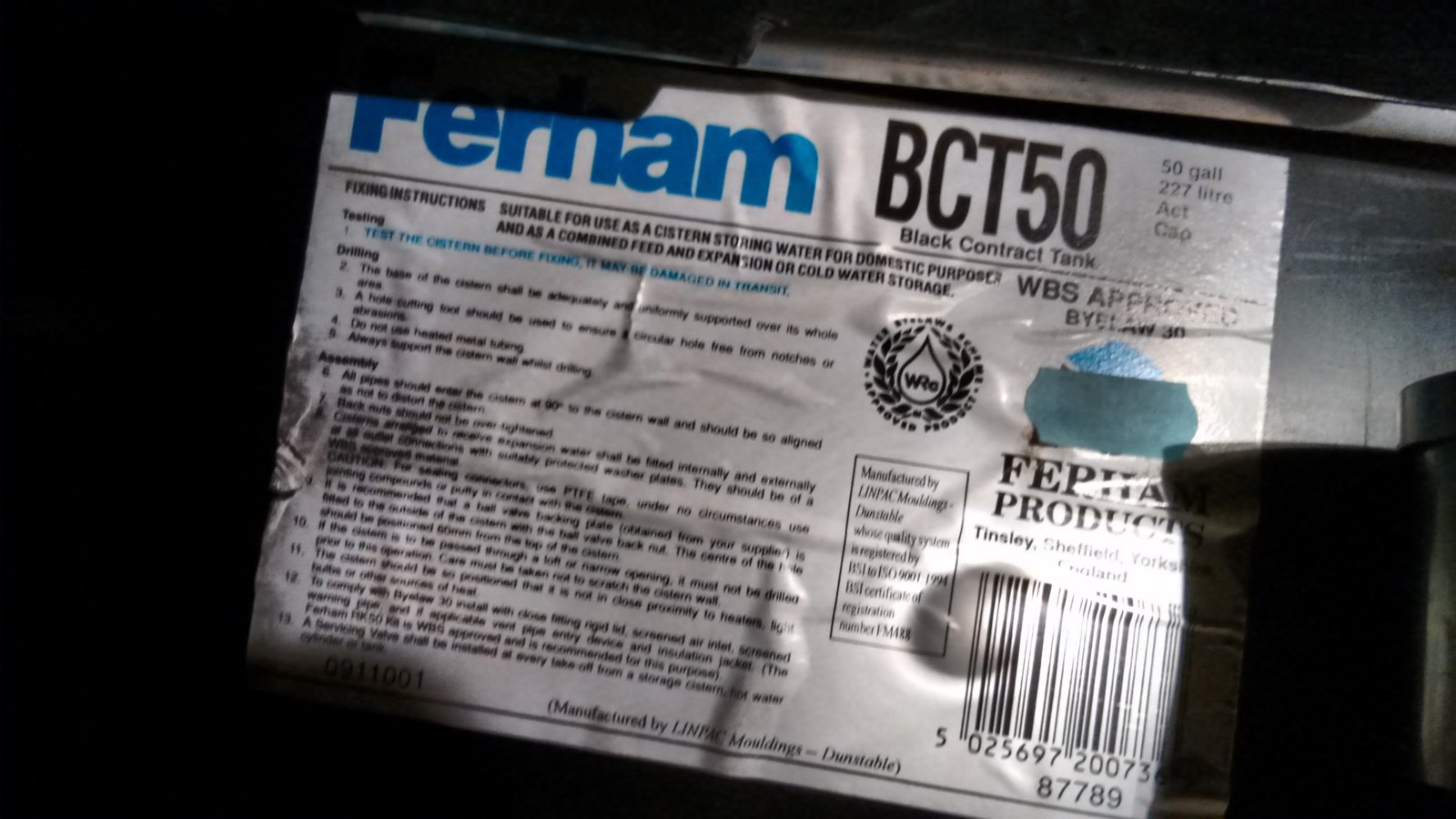

Afternoon all,
The cold water tank in the loft (approximately year 2000, plastic) must be leaking. I can see a few inlets/outlets, none of which have any water around them. The water seems to be coming from underneath, as though the tank has a crack or puncture. No idea how after being in place 18 years. Just age?
I've turned the cold supply off, and drained the tank.
I'm going to look for a leak now, but what to do if I find it?? Or if I don't?
Any tips anyone?

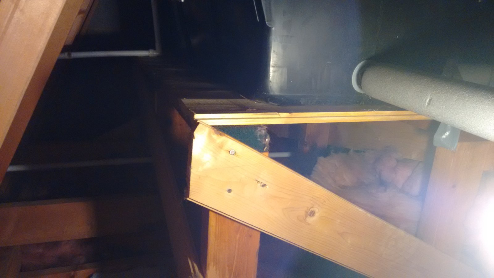

Wooden arrangement of ply and 3x2. Going up now. Update in 10 mins.
is the water from your hot-water cylinder sometimes surprisingly hot?
OK, so it's 4x2 and tongued and grooved, not ply...but yeah...

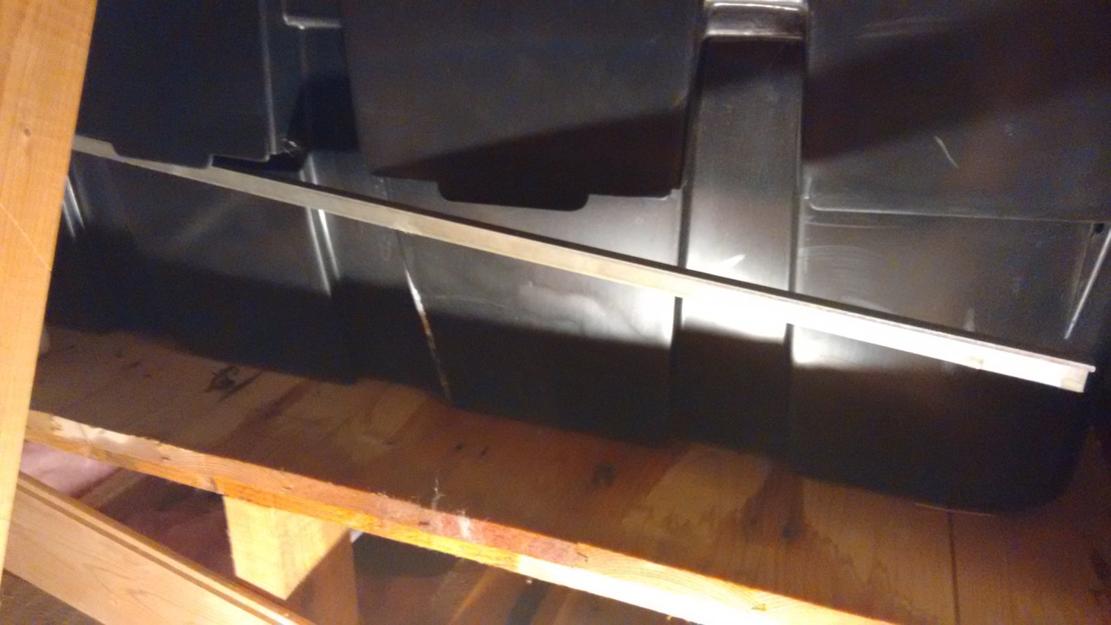

Drained the tank down to the last inch but there's nothing obvious. Probably wherever the split is was caused by a metal re-inforcing bar being out of place down one side, causing the whole side to bow out.
I'm thinking new tank then. Any tips?
Attempting photo's...

Could it be condensation forming on the cold sides of the tank.. ?
Tank sides are dry as a bone. I've taken the lagging off and there's not a drop on either the tank walls or the plastic lagging coating.
Plus, to be fair, we only know about it because it's stained the ceiling below. That's a lot of condensation!
On closer inspection, where the metal re-enforcement bar wasn't fitted properly and the tank bowed out, it looks like there's a tiny split in the plastic. On the pic above there's a limescale stain where I assume the leak was.
I've got to DIY it because my missus is off long term sick and we're skint...any way to bodge this? The split looks like it's about a foot below the water line.

I'm filling it now back to just below the assumed split....it's not visible inside, but outside on a corner it feels like the plastic has split. It's no more than a pin prick, but it could have been there for months. The wood under the tank is saturated but feels solid. Should dry out.
I'm going to only half-fill the tank. If it doesn't leak after that, I'll fill it an inch above where I think the crack is and see what happens...
