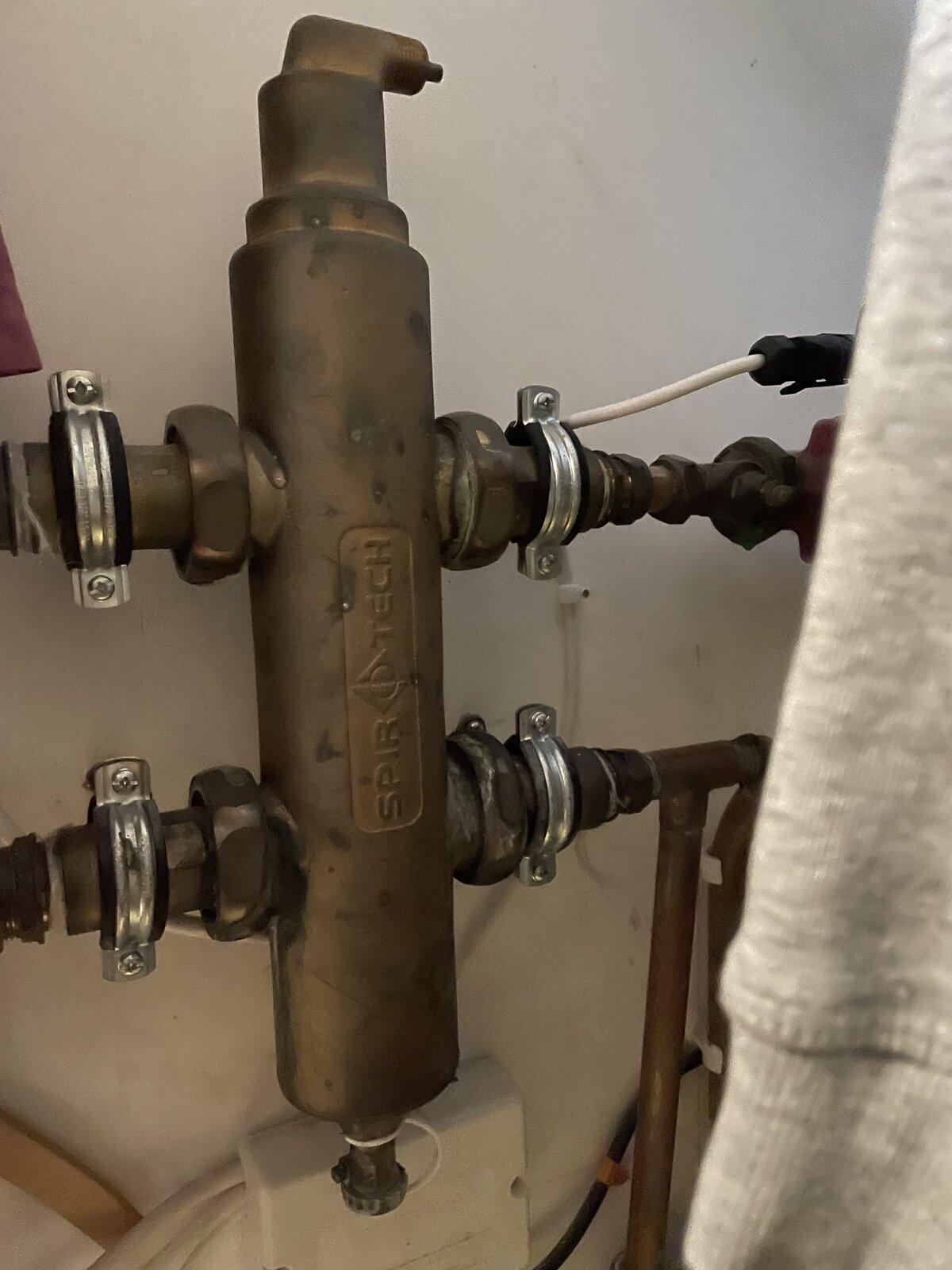

Hi All
in 2017 we did an extension and moved the hot water tank. As part of the changes the heating engineer installed a low loss header. This LLH is now leaking from all 4 connections.
I managed to get them to come out and look after numerous calls and they tightened the connections and said if that doesn’t work they will need to replace the seals. I am now unable to get them to come back and fed up of being fobbed off, I was happy to pay them so they clearly can’t be arsed.
My questions are:
1) Can I get the seals myself?
2) Where from?
3) How do I know what size?
Picture is attached.
Thanks.

1. Its a SpiroCross, made by SpiroTech.
2. The inlets / outlets are G1, G1 1/4 or G1 1/2 which means they are threaded BSP 1", 1 1/4" or 1 1/2"
3. The seals are likely to be some form of fibre washer.
4. I'd contact SpiroTech to help:
4a. Determine which model it is
4b. Whether they can supply the seals OR
4c. What the dimensions of the seals are (outside and inside diameters, thickness) and what they are made of.
5. Have a look at https://www.spirotech.co.uk/products/spirocross/spirocross--brass-143/?variant=1128 and https://www.bes.co.uk/catalogsearch/result/index/?p=1&q=fibre+washers
Thanks for that. I have just sent an email to Spirotech asking them about the washers and where to get them.
I appreciate your help.
Update: Spirotech replied to my email saying they have posted me 4 x EPDM washers today (free of charge). Fair play Spirotech and thanks @oldbuffer for pointing me in the right direction.
Hi Steve, I came across this post when Googling as I have exactly the same issue with what looks like the same LLH (Spirotech Spirocross AX100), but only one of my connections has a slow drip (from time to time). Interesting that it has also just turned 5 years old, which appears to be the age of yours!
Our boiler was serviced last month and since then we have lost pressure on three occasions, which I determined was due to the Magnaclean leaking (part of the service), so I've replaced the rubber seal with a new one and that has fixed that issue. This is when I noticed the LLH connection was also leaking, albeit intermittently, probably when the system is going from cool to hot and there's pump pressure.
I think I will also try your solution and contact Spirotech.
Thanks for posting your issue and solution as hopefully it will help me too.
I can confirm that after contacting Spirotech they also sent me 4 x EPDM seals free of charge. However, over a year later and I still haven't gotten around to replacing them as it is quite a big job due to all the 22mm supply/return pipes needing to be moved out of the way to enable the LLH to be taken apart.
I've also noticed the Auto Air Vent is now leaking water, so yet another issue with this LLH!
