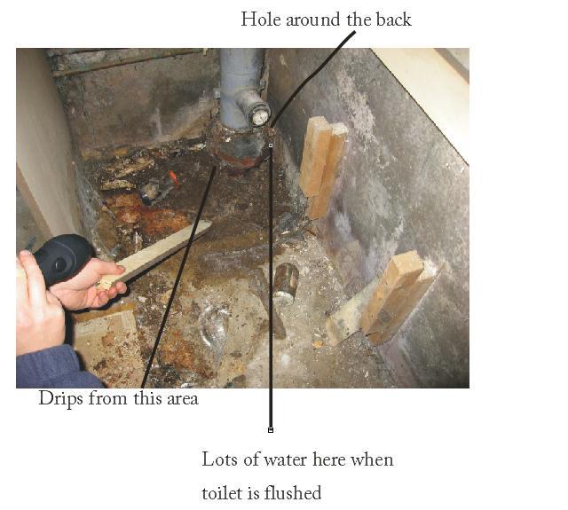

Hi,
Whilst taking out my old kitchen, behind one of the units was the sewer stack from the bathroom above. Everything was damp so scraped away all the sewage to reveal the extent of the problem. It appears that somewhere on the stack it is leaking into the kitchen. Tried flushing the toilet to identify where abouts and have indicated it on the attached picture.
It also appears that behind the stack right in the corner, it opens up into a hole in the floor, could this be into the sewer?
Any help would be gratefully appreciated as I dont think this is a particularly healthy
Cheers,
Grozz
This is a common point of failure
Normally you will have to dig out the broken collar and replace the pipe section under and within the floor slab
If you try and bodge it by just sealing around the joint, then there is no guarantee that the pipe is not leaking within or under the floor.
Access may be a lot easier from outside

Access from outside is by digging down to the drain and opening the wall where it enters the foundations. There is also digging from the inside.
The problem with those clay drains, is that when you start knocking the floor around it, they tend to crack further down, so you end up renewing the whole section from floor level to part of the drain where it exits the house.
You need to get quotes. It wont be cheap as its very awkward and time consuming.
Normally this is routine maintenance and not claimable on the insurance. You need to check your policy.
By all means have a go at the top bit around the collar, but it's rare a repair here will be successful, or last.
Just a possibilty (Probably some of the building boys will shoot me down) I had the same problem with an old S trap WC. I cut off the broken collar with an angle grinder (you need a top quality diamond disc - the pipe is very hard) and pushed a straight pan connector down the pipe. This left a push in type collar. Now I don't know if a stack pipe will pushfit seal but if not there is probably an adaptor available.
