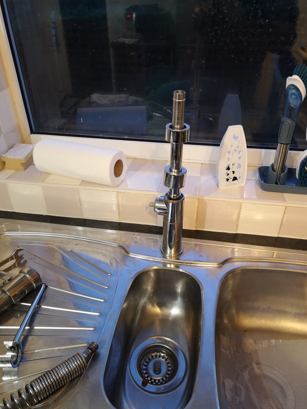

So, my tap leaks from the area showing on the attachments.
However, I have no idea how to take the tap apart. The only screw is highlighted with the purple arrow. There is also a screw on the nozzle itself.
I am guessing I just need to put a new o-ring near the area in the photo.... I just don't know how to get to it.
The tap was in the property before I purchased it so don't know the make.

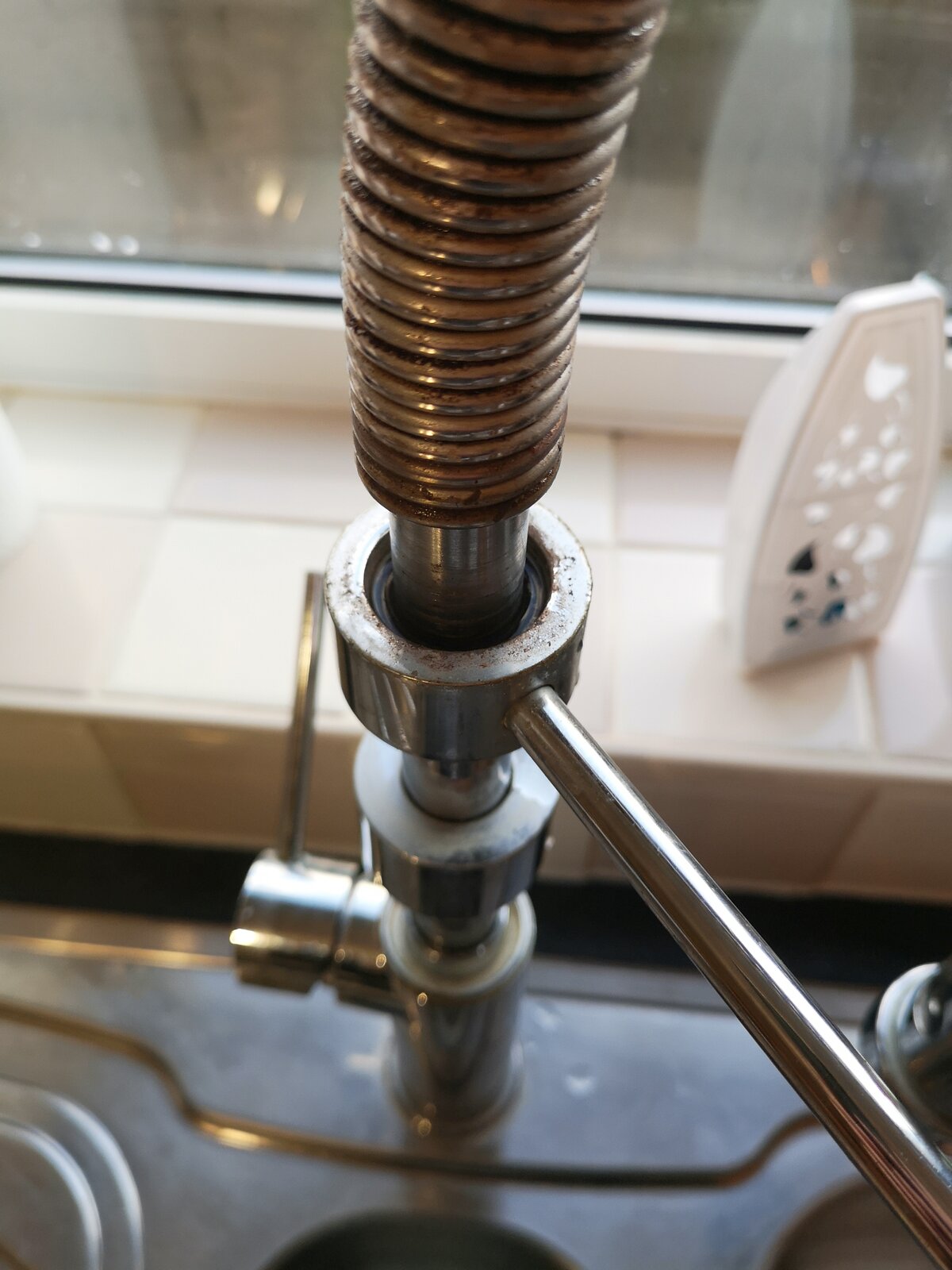

It drips directly from where the flexible pipe goes into that ring you can see on the photo.
Ps taken the on/off handle off to see if I can get into it that way.... I cannot
1. Those flexible pipes usually have a 1/2" BSP male thread on the end. This screws into a matching female thread in the tap, with some form of seal or O ring in between to seal.
2. If not already done, loosen the screw circled in yellow.
3. See if the chrome tube at the end of the spring section will unscrew.

I got that far..... But could take anymore off. I think the small ring at the top might come off, but no screw or anything
So, put it back together again
