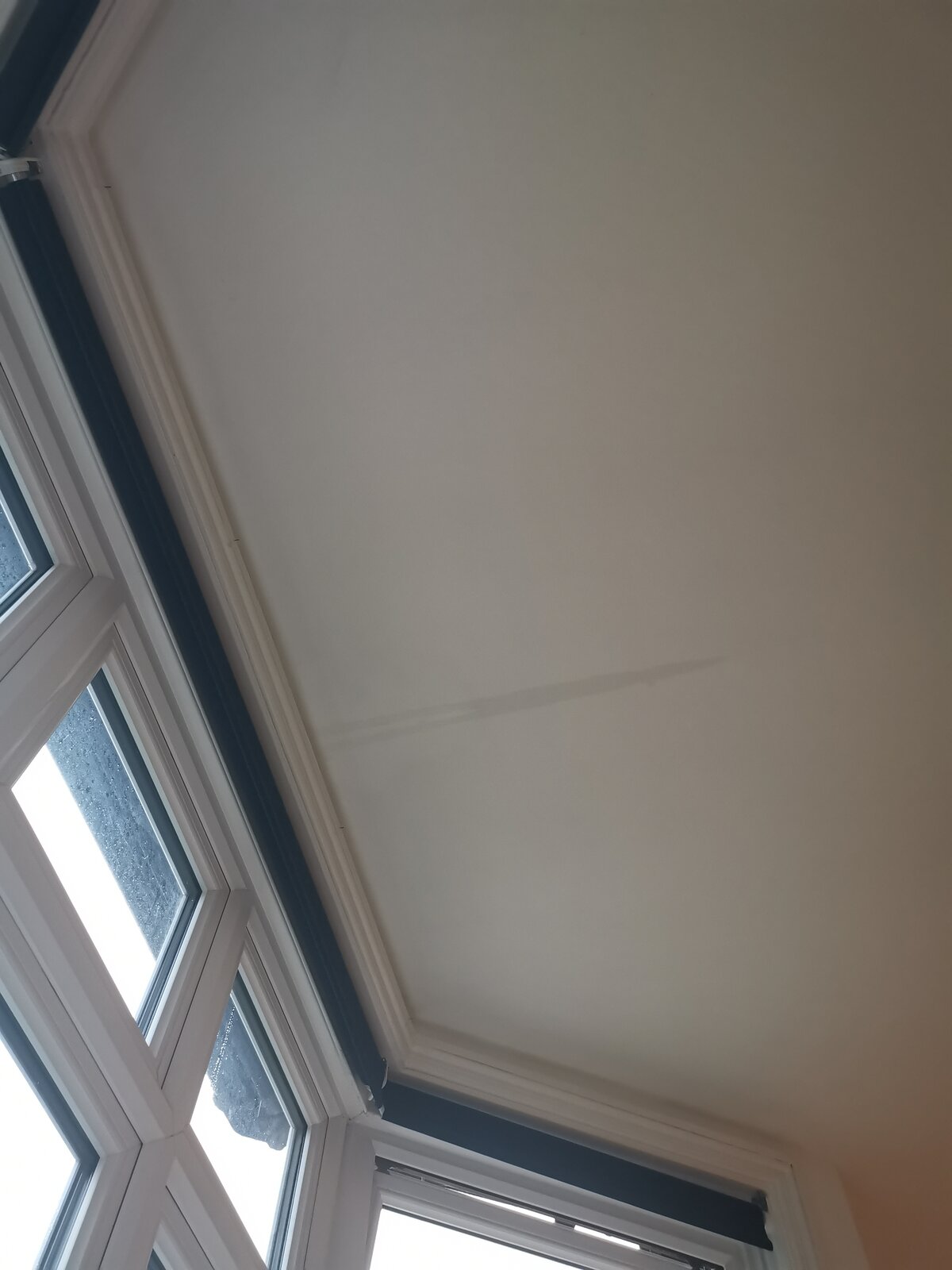

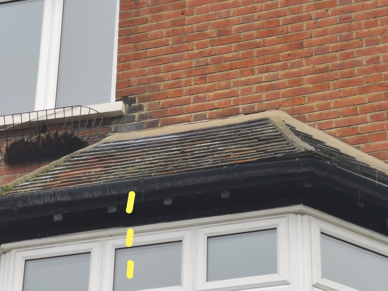

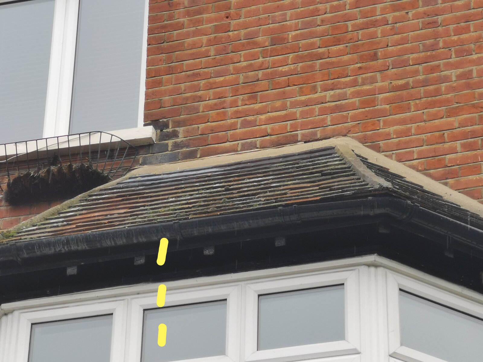

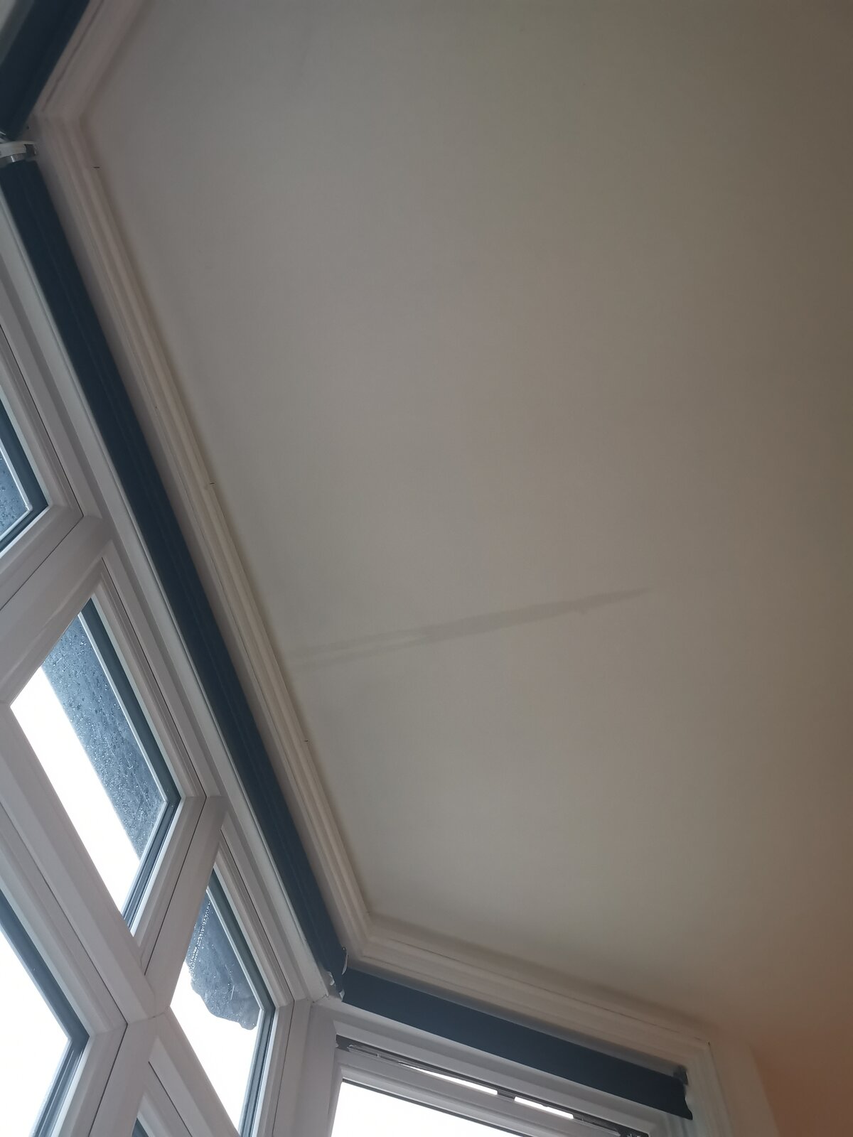

In the 18 months that we have lived in our flat, we have had some visible damp on our ceiling adjacent to the bay window (3 separate times altogether). It seems to happen after particularly heavy rain when it is also windy. The photo shows the alignment where the damp patch is occurring. The second photo shows the most extensive damp patch we have seen. It seems to start right next to window and spread from there.
Looking at the roof there doesn't seem to be any missing tiles. Also, the gutter doesn't overflow and is overhangs the top of the window by quite a lot. I'm wondering whether it's one of the following reasons:
- No proper lead flashing; there appears to be a mortar joint instead of this
- Perhaps combined with no cavity tray; 120 year old house so not sure if they had them (or an equivalent) back then
- Rain getting blown up and over tiles (I don't think there would be felt under there)
It's tricky to get access up to the roof because there is a conservatory below half of the bay window so I'm not really sure what my best course of action is. Any advice would be appreciated.

As it's a flat, who is responsible for maintaining the structure and exterior?
Notwithstanding "woody" above,
Your roof tiles have a mild Moss Infestation over the entire roof, moss can and does allow rain water to get past the tiles. /// No felt??? ///
There is a small area of missing pointing between the wall and the cement? flashing [near the right hand side]
It appears that historically some tiles have been replaced?

No traditional lead flashing and a solid brick wall!
I would start with storm dry first.

Thanks all for your suggestions.
Ken, that is interesting that the moss roots are extensive enough to do this.
I'll look at getting the moss cleared and a proper flashing installed. Obviously, it is a bit of a concern that the timber frame of the bay roof could be rotting.
I doubt its the moss on clay tiles. The mortar fillet may have cracked
