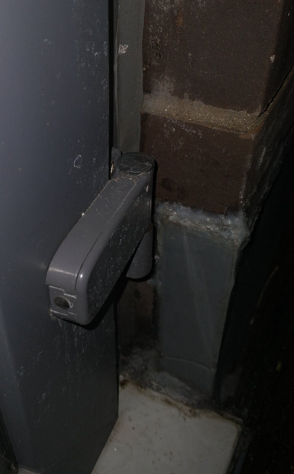

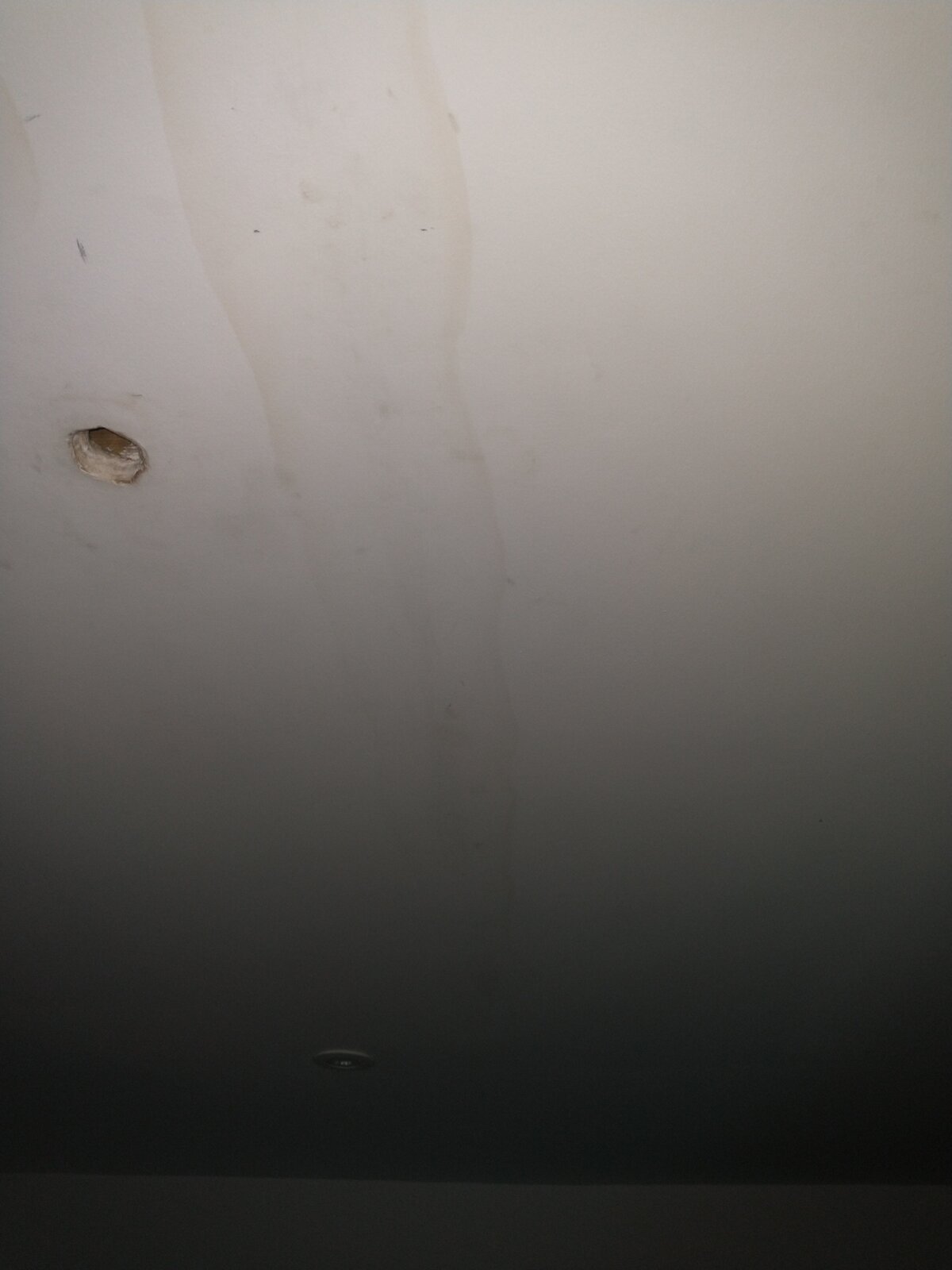

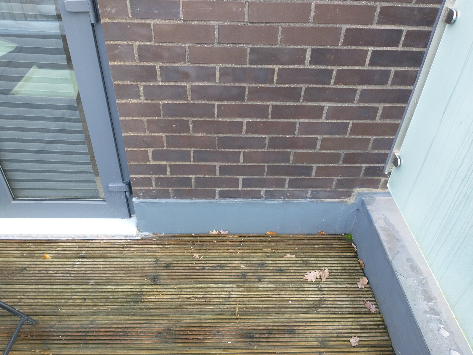

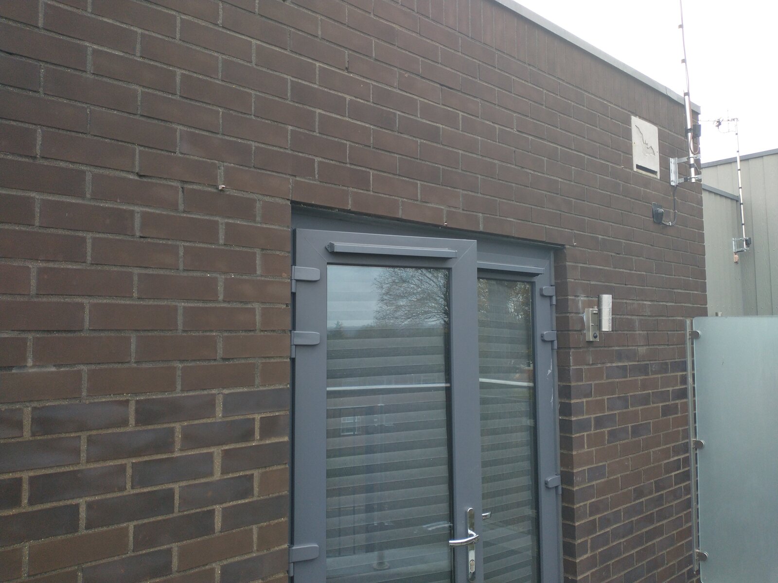

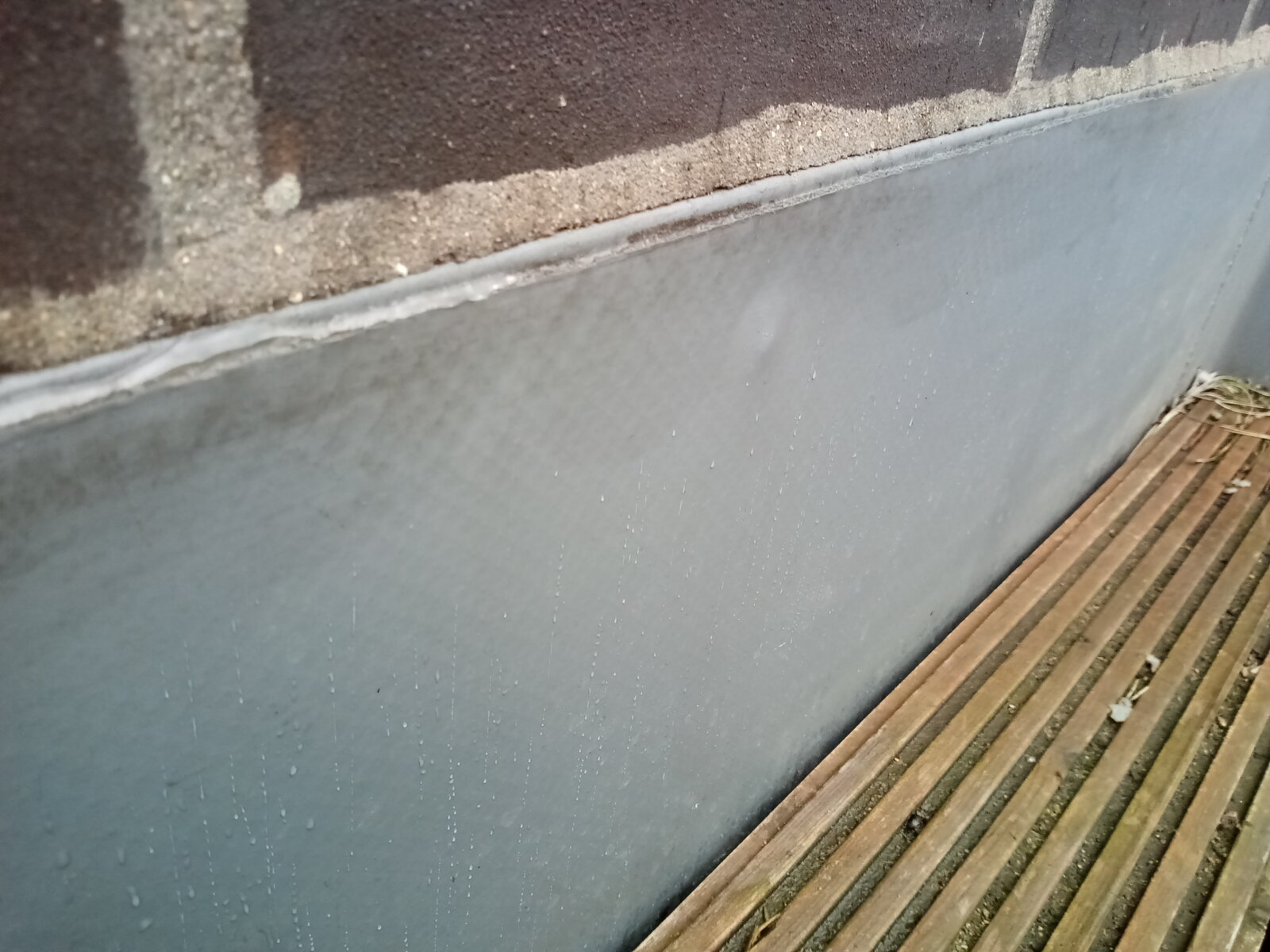

Hey,
After some advice.
I have a balcony which leaks into the room below during wind driven rain. I have used sealant on the flashing which has reduced it somewhat but not eliminated it.
It's 100% not the roof itself as the water can been seen dripping either side of the metal beam supporting the cavity wall.
Any ideas?
Cheers

Sorry yes i remember I had another 2 threads on this. I should of posted it there, apologies.
The reason for asking again is because I've had a quotation to install lead flashing above the rubber upstand (even though this rubber is chased into the wall) and to seal the wall with a masonry cream instead of retrofitting cavity trays.
I was wondering if this seems like a legitimate solution and if masonry cream is suitable for cavity walls with a living space underneath. I am worried it will effect moisture already in the wall etc.
