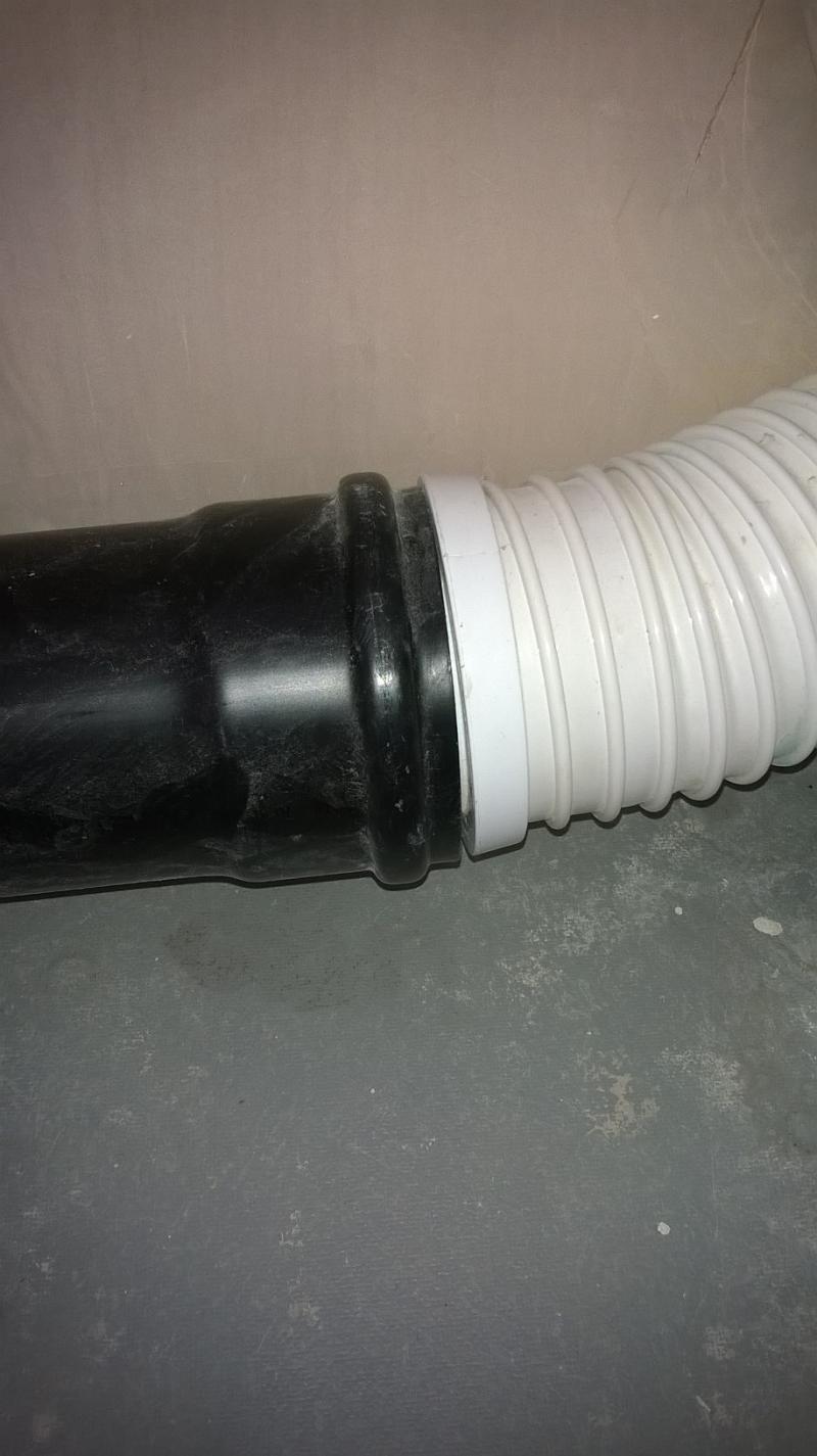

Hi Guys,
I am remodelling my bathroom and moved the toilet across the room. The soil pipe is internal in the corner of the bathrooms on each floor and I managed to rotate the junction and run a soil pipe horizontally which I will box in.
I have used the flexible pan connector that was on the toilet before but its dripping a bit.
Does this look right? The rubber seal goes into the soil pipe all the way and there is suction... I cant see any damage but there is a small drip.
The flexi should push into the pipe itself, not a socket. You may need to cut it off.
That's what I presumed but wasn't sure, its part of the soil pipe so thought I could just use it.
Thanks for the advice.
Alternatively cut a section of pipe the depth of the socket, insert, and then push in flexi pipe
Cut off the black socket and push flexible in.
IMO, I would rather use rigid pan connector than flexible one.
Daniel
Or, leave it a couple of inches longer so that it can be gripped should it ever need to be removed.
