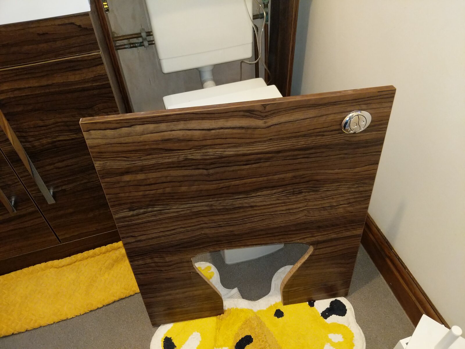

So I called in the experts , two did not turn up on time and third who did turn up said he will need to remove the toilet bowl and flooring to get to the flush as there is no way to get the wall panel out. The bit about removing flooring concerned me a bit so I felt along the sides of panels and pulled on what I could, the panel is out :-)

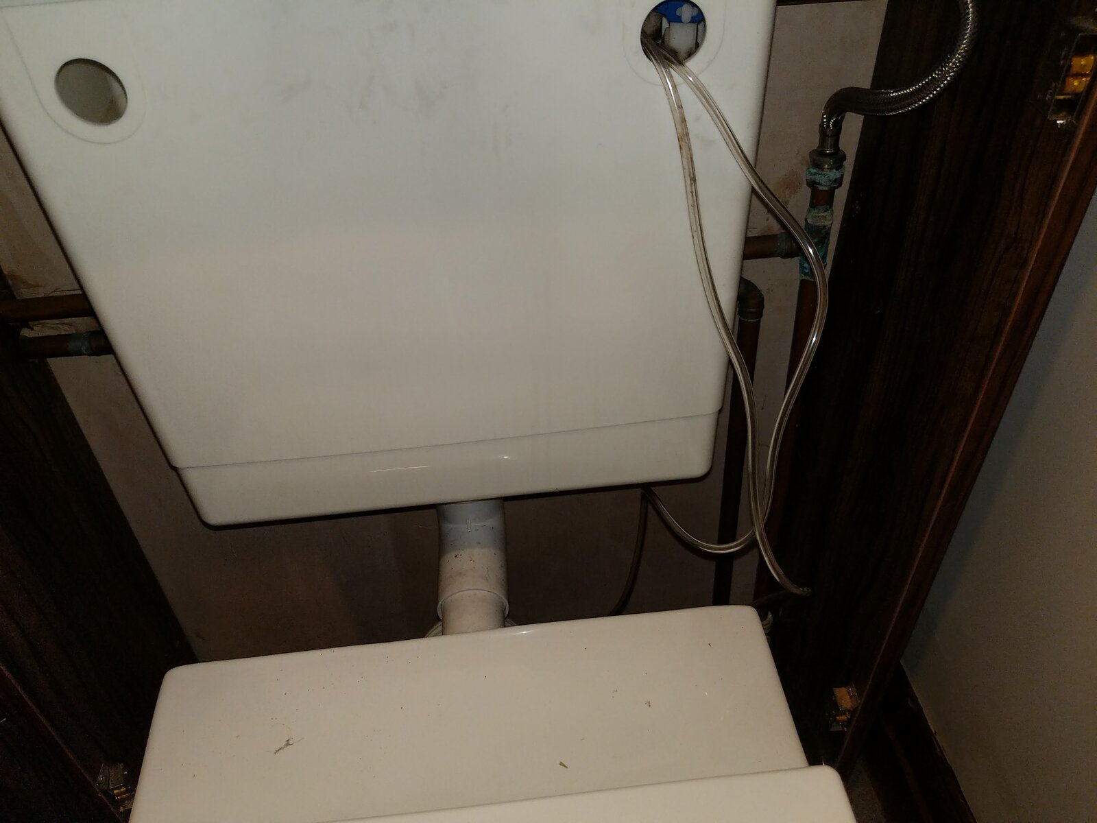

I can see the flush system, can't access it very well but I have taken some photos, any ideas on what to look for or how to try and resolve this will be most helpful. I can hardly see inside. Photos attached , it is a funny looking system with two plastic clear pipes coming out.

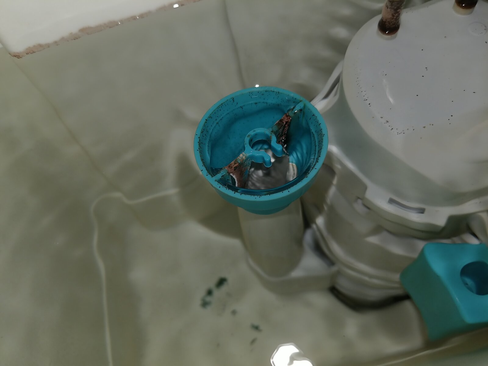

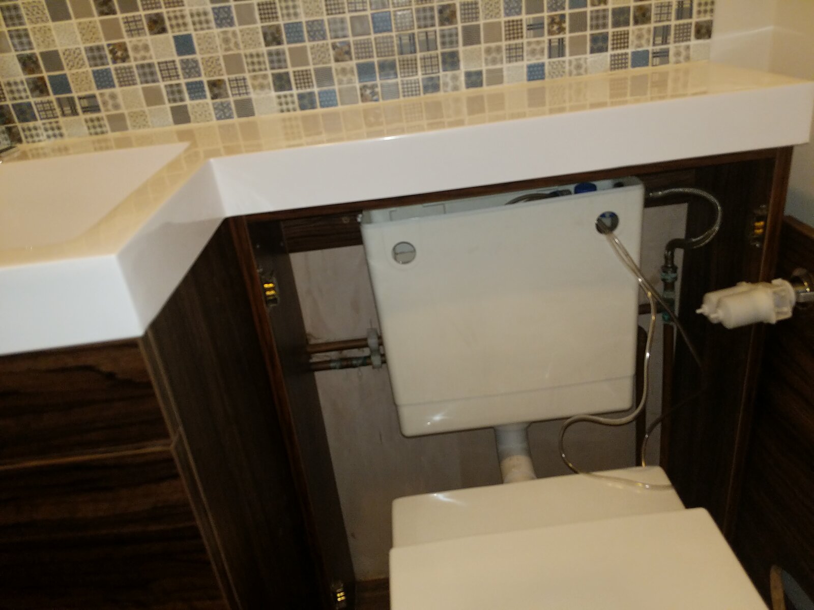

I think I know where the problem maybe , it is almost certainly the flush valve, the problem is getting to it.
Looks like the only way to get in is by removing the top L shaped sink panel

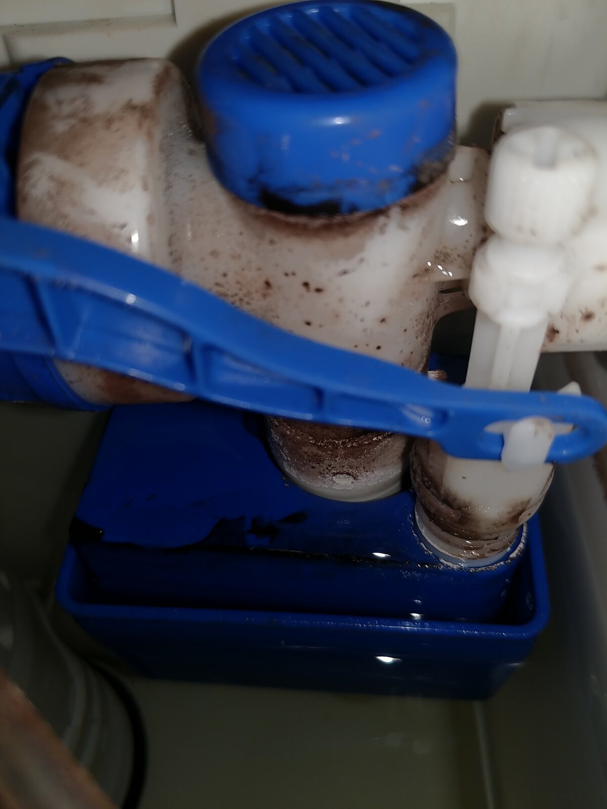

On your picture showing the blue lever, have you tried adjusting the white plastic screw to push the float deeper into the water so that the lever shuts the valve off sooner? You might be able to do it by touch or with a mirror?
