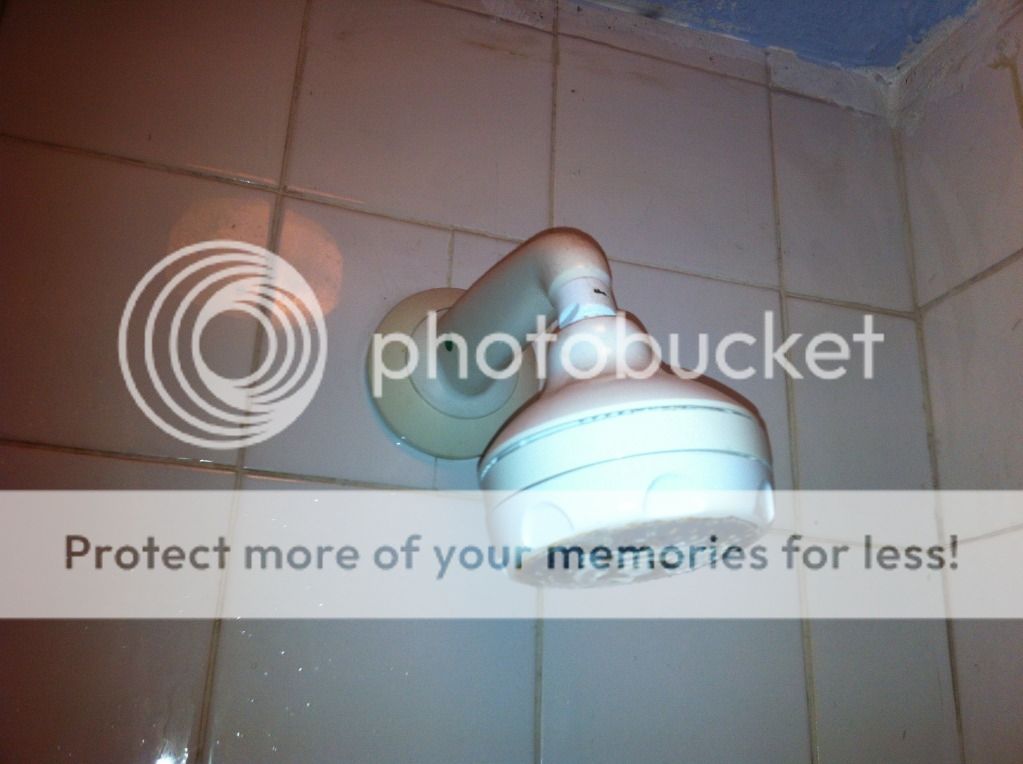

Hi folks,
We have this old shower and the control is leaking and I had a few questions. I have taken off a couple of layers:
1) If I unscrew any more here water starts gushing out. So I imagine I turn the water off unscrew this and replace a washer. Is this right or could it be something else?
2) The shower head is above:
Since the water goes through the control knob thing, can I replace these fittings with one of those shower heads on a flexible hose? Will that kind of thing work with the plumbing that exists? Is it easy to do?
3) Also I can't see a way to get that shower head off, might the whole thing unscrew? I don't want to force it.

Looks like an Aqualisa shower. You will need to remove and replace the whole cartridge. The screws around the outside hold the cartridge in place.
The cartridge is not serviceable.

Hi,
I think the colour is the key. I swapped a green one. Aqualisa web site has spares, though you may find them elsewhere.
Best if you can identify the actual model of shower.
Easy to swap.
There is an 'O' ring to go in the back of the housing before you slide the cartridge in.
With regard to the head it looks like there is a flat visible in the photo suitable for an open ended spanner.
Aqualisa web sie may have manuals too.
