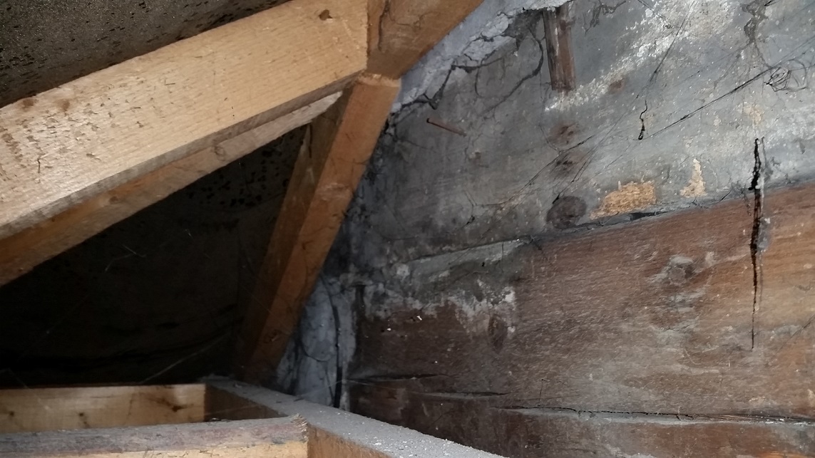

Just hacked some of the porch away and managed to get a look at the beam(s)....
Original is rotten, with plenty of woodworm exit holes. Looks like another timber beam has been put underneath, which looks in good condition apart from some horizontal cracks. Bit nervous the original beam is still there in that state though (and that new one could get woodworm too!) ? Feel like it needs a professional to look at it but who, a structural engineer? Timber specialist?
