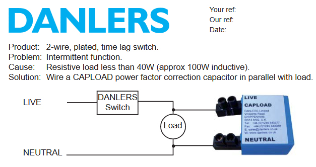

AC can have capacitive and inductive linking, and the longer the switch wires, the more of a link we have, so two way systems are more prone to the problem.
So the voltage slowly builds up in the lamps smoothing capacitor, until high enough to light the LED's when it discharges through the LED's as a flash or keeps the LED's on dim.
I cured by changing bulbs, G9-comp.jpgthe smoothing capacitor in the large bulb was nearly as big as the whole of the small bulb, and it was a higher wattage to start with, so swapping to the larger bulb stopped both staying on dim and the flicker when on.
The load-capacitor.jpgload capacitor should stop the flashing or staying dim when off, don't really know why it did not work for you. But I found it hard to fit in the limited space inside the lamp fitting.

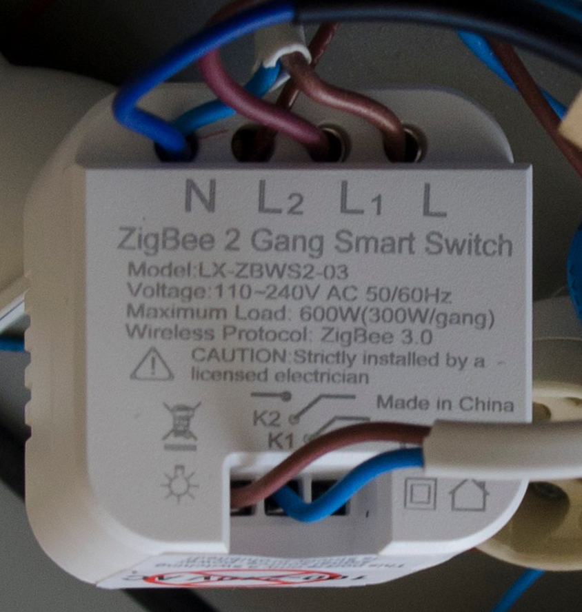

Using a relay DSC_6061r.jpg so the wiring to the two way switches is extra low voltage DC is another method, also allows switching with phone and voice control.
