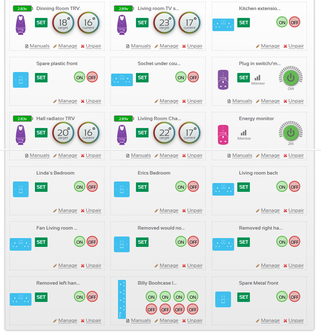

The ZigBee hub does allow some interaction, I have a remote control (Lidi) which was to work three GU10 spot lights, to work two lamps in my wife's bedroom, and a relay can be both worked by hard wired switches and the smart life app on the phone so many ways to control same lights. Still waiting for son with ladders to come an install it.
But also had fair share of failures, got up to 5 smart switches at one point, now only two still working, also had a smart socket fail, and so now using plug in devices, as can be easy unplugged when they go wrong.
Five devices no longer used, this does not include items controlled with Smart Life. Another 20 devices on that system up to date only one failed.
Electronic equipment does not like surges, so I do have a surge protection device fitted, and I have been using smart devices now for some five or more years. I have used them instead of installing two way lamps etc. But be warned, they do go wrong.
