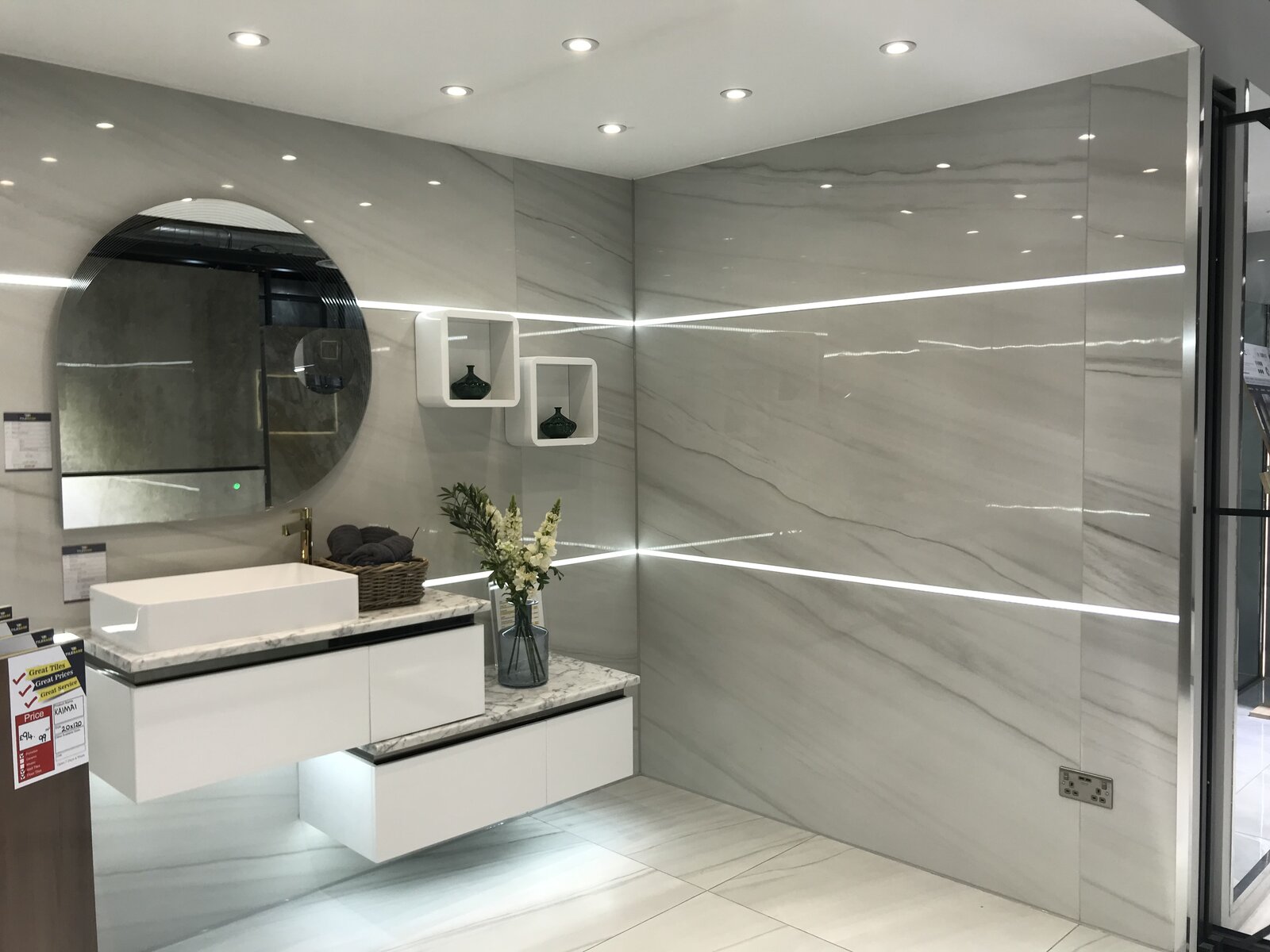

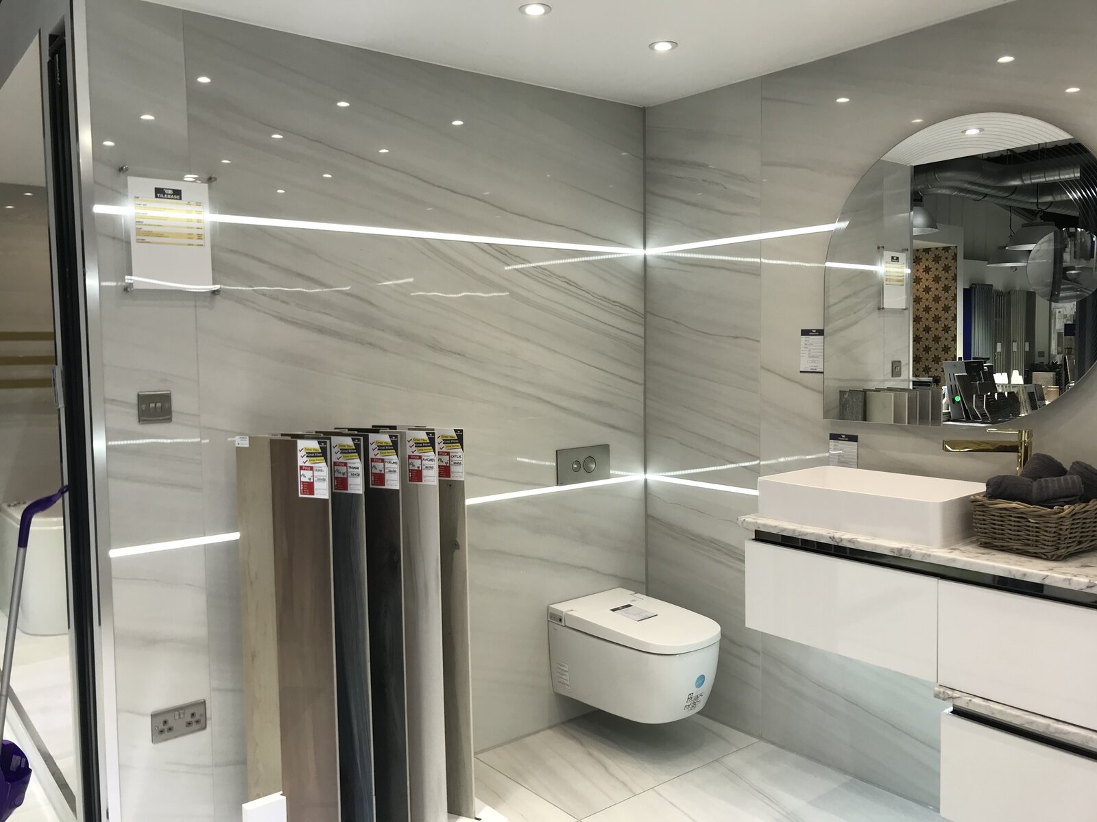

Hi
I would like to copy the same LED strip lighting effect on my bathroom tiles before we start tiling our bathrooms.
could I pls get some advice as to what is needed to get the desired effect?
1. what type of LED strip (this one had a dotted effected which was quite visible and I didn’t like. I want a single line effect).
2. the stop thingy in between the tiles, is that called a defuser? If so which one should I go for and what size (10mm?).
Anything else to keep in mind? Cool light or soft light. Type and size of transformer?

You are looking for "LED strip Diffusers".
Aluminum U channels that take a LED strip.
Have a look at these:
https://www.ebay.co.uk/sch/i.html?_...fusers.TRS0&_nkw=led+strip+diffusers&_sacat=0
The width depends on the width of teh LED strip you are looking for.
Remember that you also need somewhere safe and dry to hide the 240Vac to 12Vdc converter. You need a high quality (not an ebay knock off) and a relatively high Wattage version. The LED strips require about 5W for each meter length, so a 3m x 3m room will require 3+3+3+3 x 5W = 60W + a bit a safety so say a 100W converter.
Almost all LED strips have dots. The diffusers helps minimise this.
Suggest that the LED strips you look at are 'waterproof' as this will minimise condensation causing corrosion to the tracks and damaging the LEDs.

Consider what will have to be done when the LEDs need replacing. Maybe the tiles will have to be remove to access and replace the LED strips.

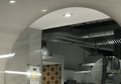

It looks good but may be impractical in a home. The photo appears to have been taken in a show room where there are exposed ventilation ducts.
All LED strips have point sources of light. The diffusers spread the intensity but there's a tradeoff in terms of brightness vs spread (the more diffusion the dimmer the result).
Drivers- whatever you buy make sure the system is wired so they are easily accessible for replacement. Likewise the LED strips themselves- nothing lasts forever.

That is a show room display :-)

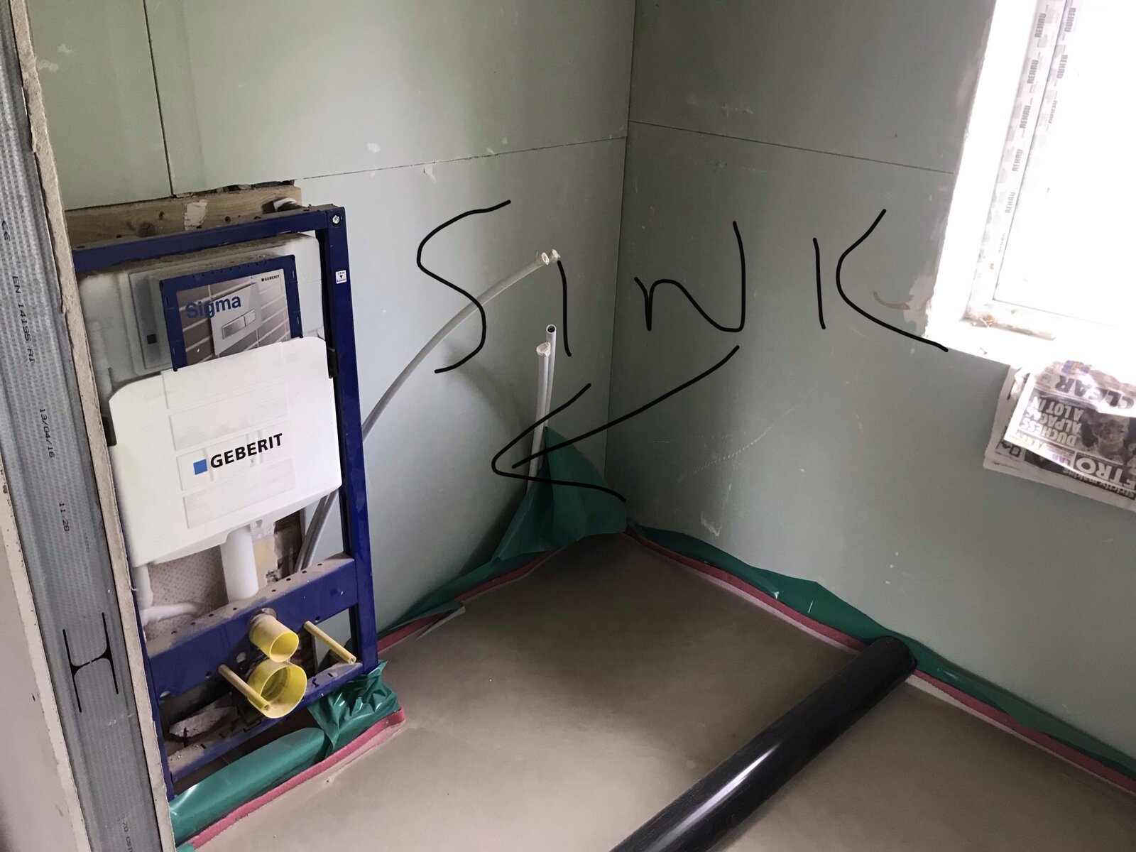

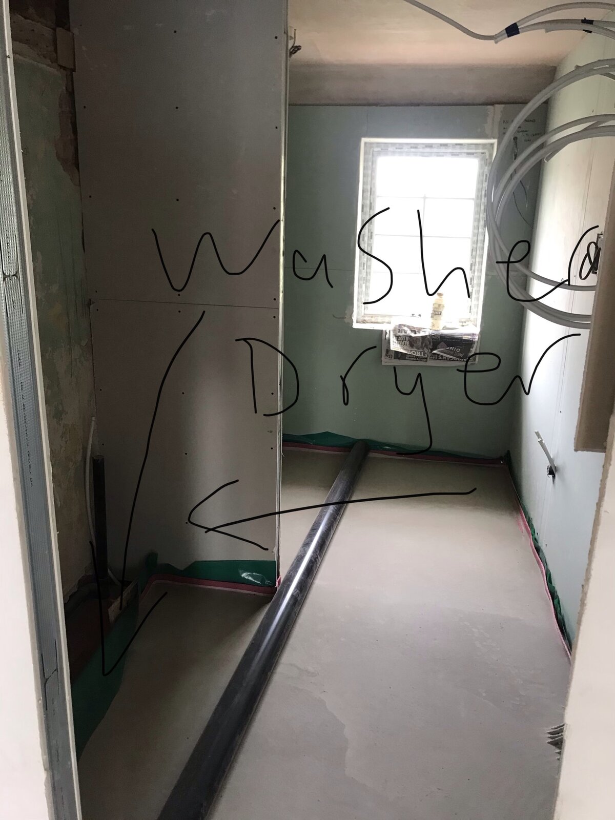

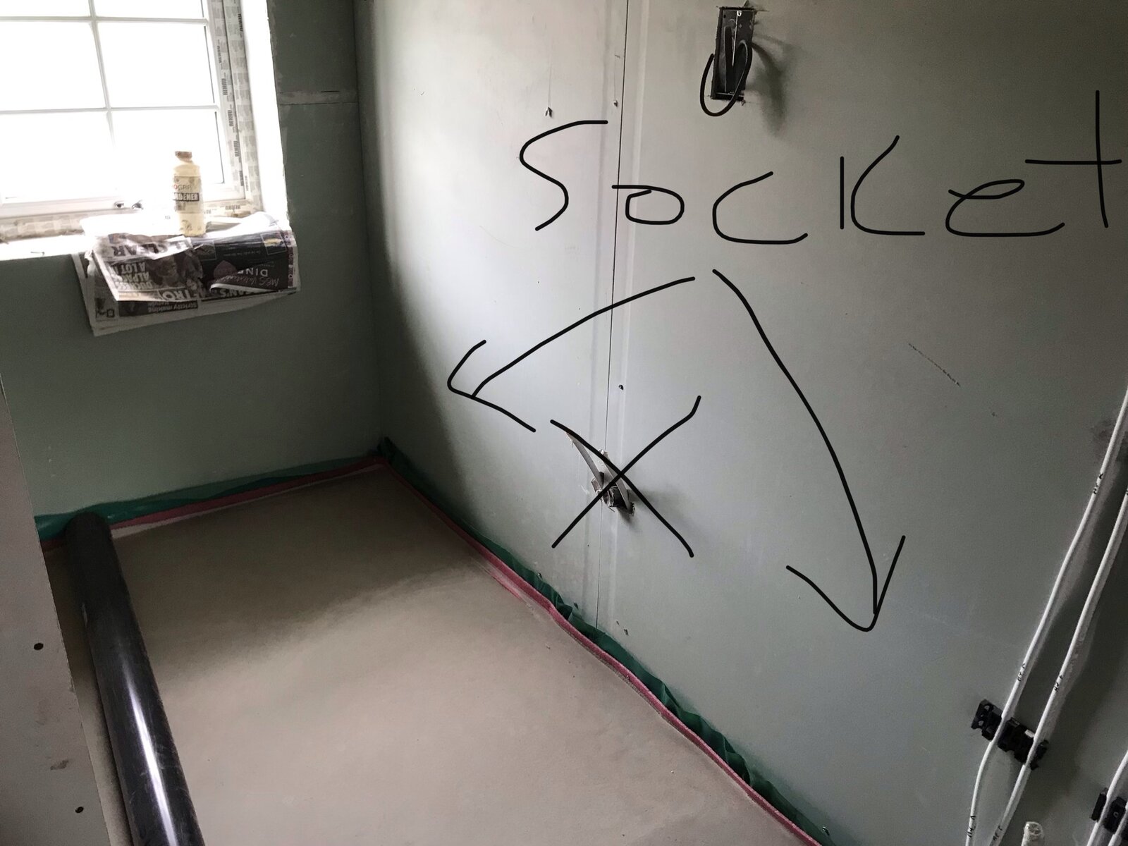

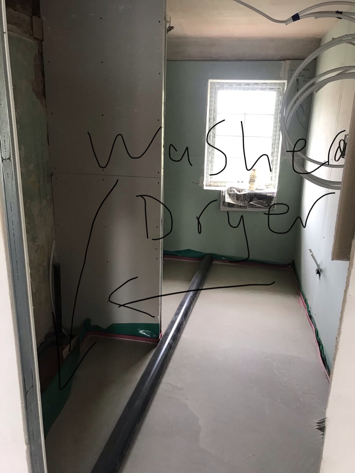

That said, I'm creating a laundry room on my first floor. It will have a sink and toilet in the corner and on the opposite wall a socket for my ironing board etc. Is that going to be an issue? There will be no bathtub and no shower. In the same room will be a sectioned off washing machine and dryer.
...and can do all the wiring from the otherside of the showroom display.
am I allowed to have double sockets given the setup I have described for this first floor laundry room with toilet and basin?

Just search google for led strip channel. It will bring up lots of examples. Basically it’s just an aluminium extrusion which you attach to the wall as you are tiling, and when you’re all done, the led strip can be installed and the plastic diffuser strip clipped into place.
