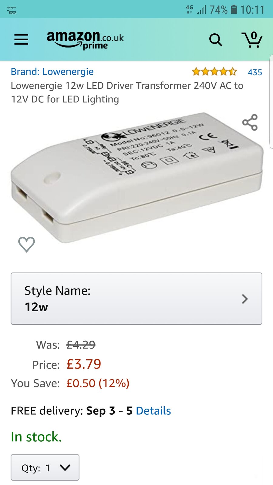

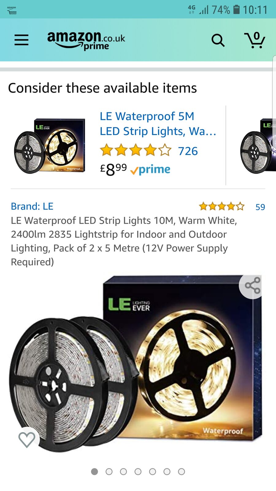

I fitted a kitchen earlier this year and used 2x5m led strips as feature lighting on the underside of solid oak worktops. They were IP65 rated and cost about £16. Like most strips they can be shortened if needed.The drivers weren't included but they cost around £4 each. I soldered 12v wire to the strips and waterproofed them by hot glueing the connections. Here are the items I used -

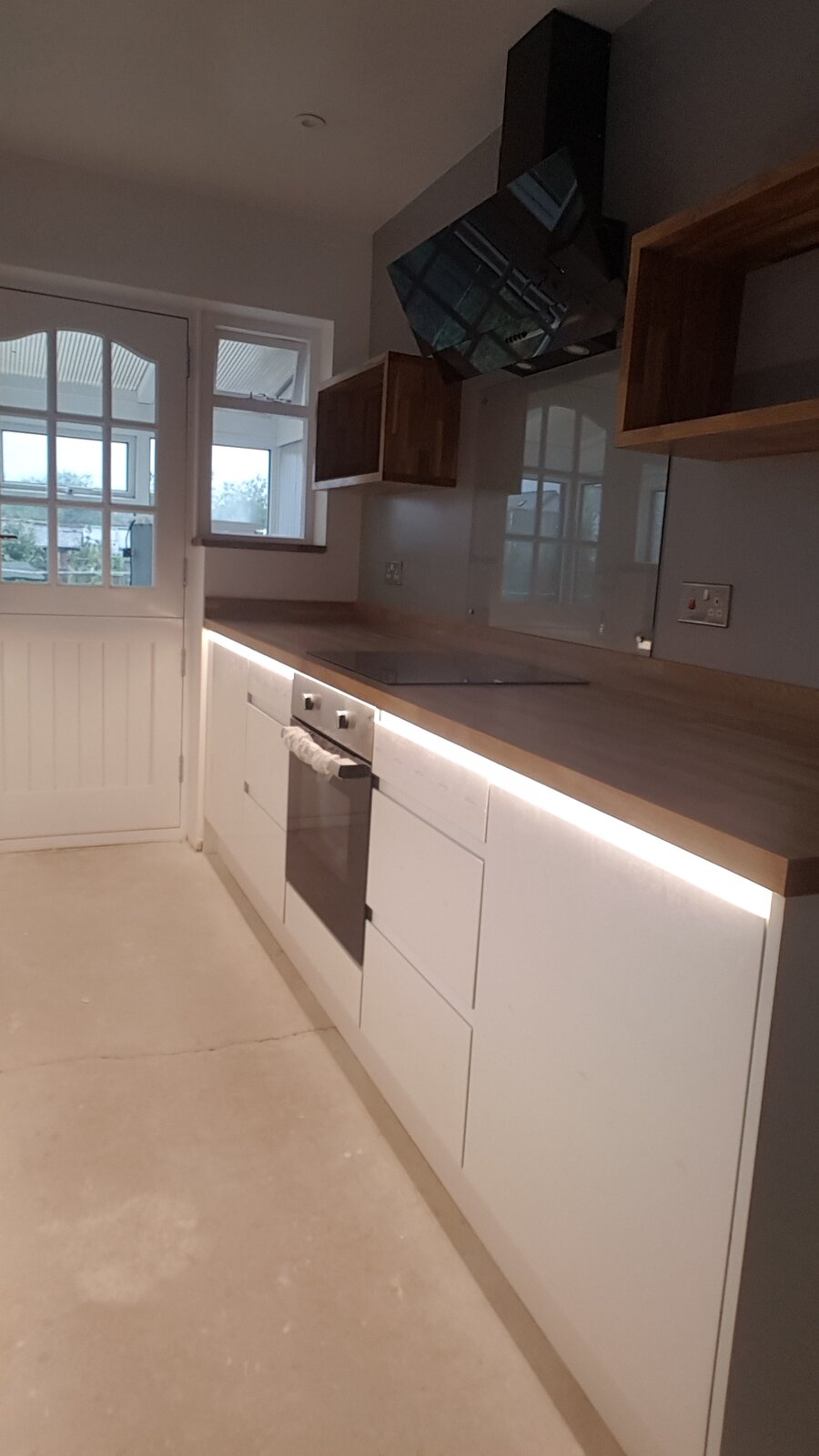

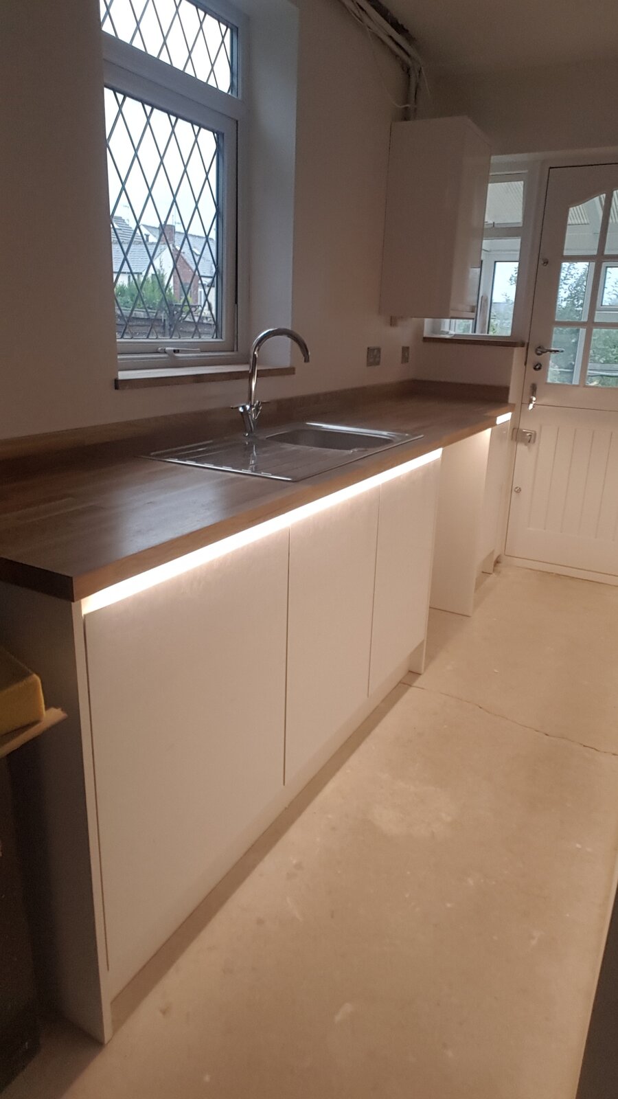

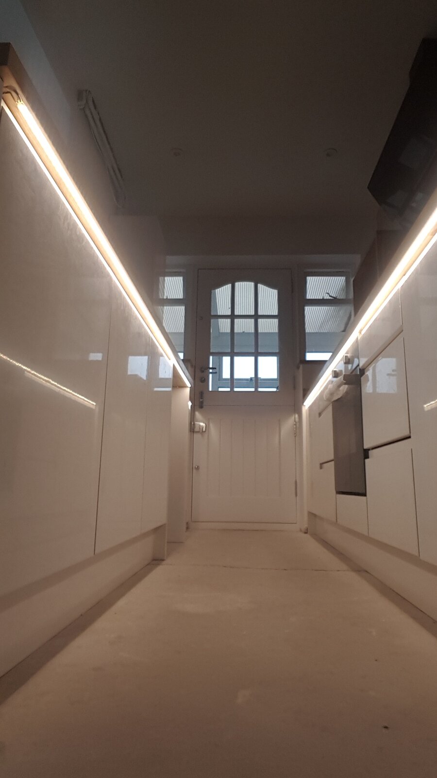

They'd illuminate the steps fine and probably a bit further, but the light thrown from them isnt strong enough to light up the garden. I'll get some photo's posted for you of these ones under the worktops.
Here you are britishboy7, they are very bright actually.
