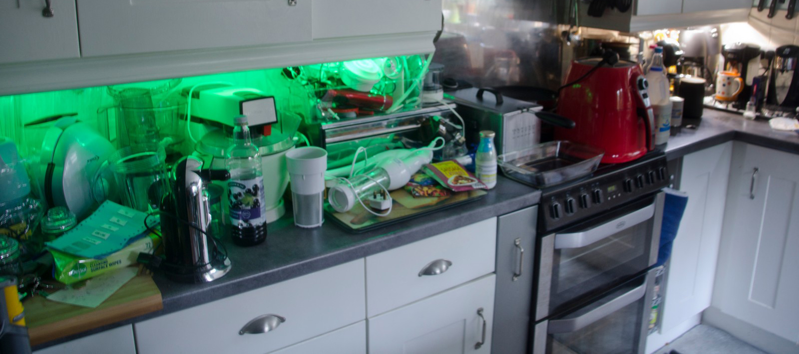

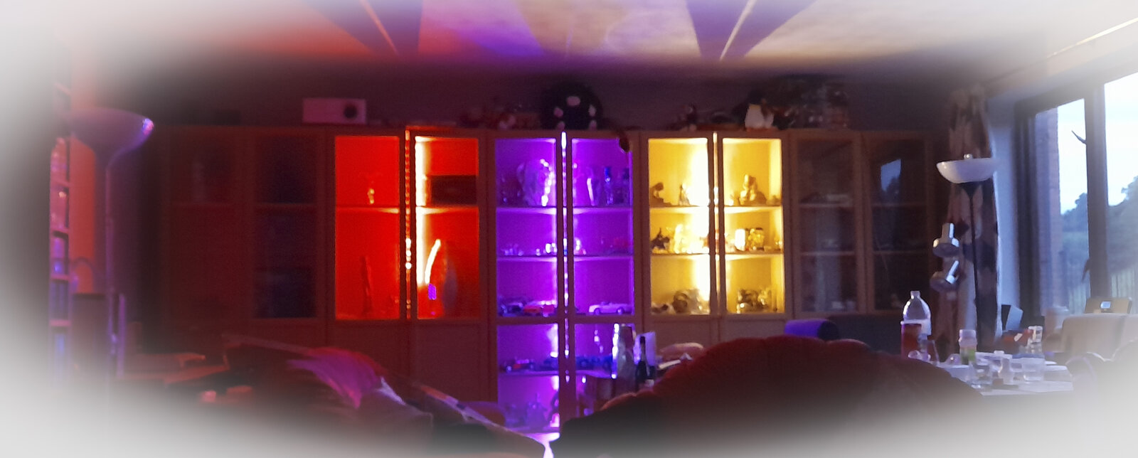

Here 20220704_220141_1.jpg three different lights, Ikea Lidi Ikea there are so many ways to use them and so many types, but all I am using need wallmart power supplies.
