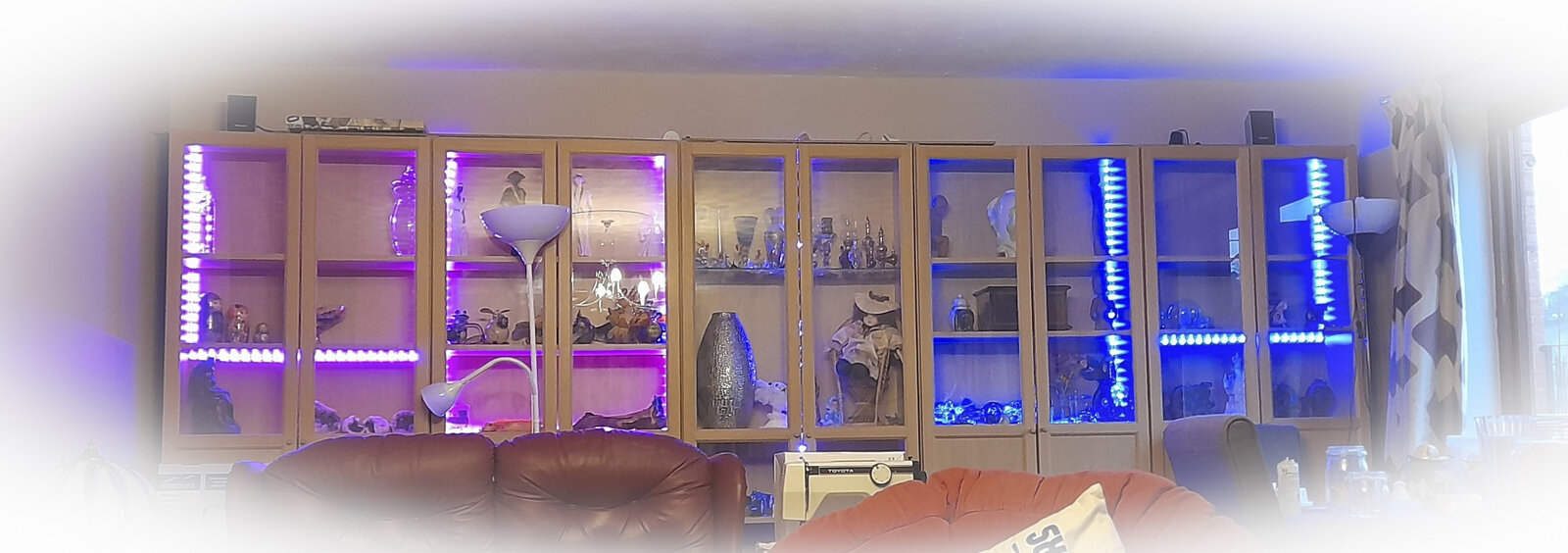

As to the strip lights, I had a pair of 3 meter strips from Lidi which were rather robust, and worked well, but the billy bookcases centre floor to ceiling with glass doors it worked well, but either side the two units needed 5 meters to light, so went for TCP from Screwfix, nowhere near as robust, but behind the 4 doors they don't need to be so robust anyway. 20230227_170703_1.jpgThe units are both for decoration and for light, that side of room is away from ceiling light. The ceiling light uses a Tapo smart switch, so entering or leaving room hey google turn on/off living room lights works well. We also have some uplighters, again can all work with same command.
