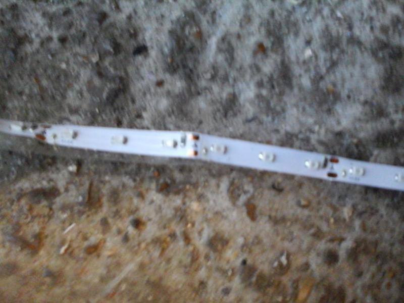

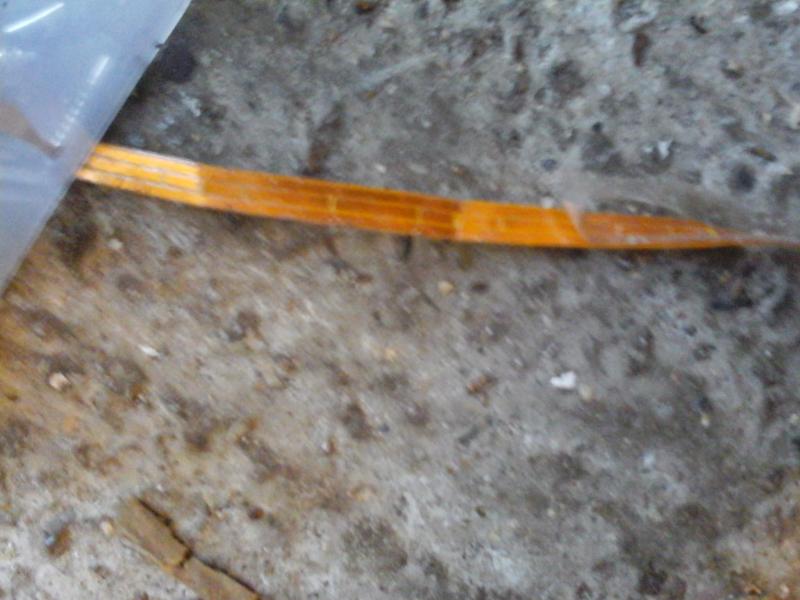

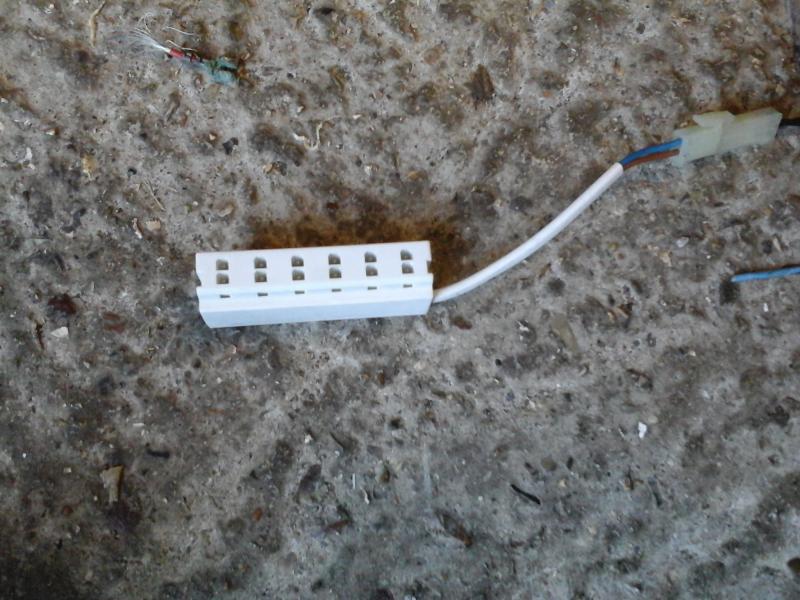

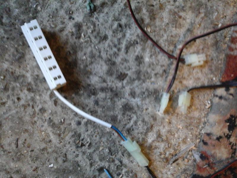

We use similar at work plugged into little splitter boxes and puts them in parrallel
with the insulated ones they fit two core wire one end and heat shrink BOTH ends to seal the open ends
As you say, you cut to lenght on the marks as shown on this uninsulated version
