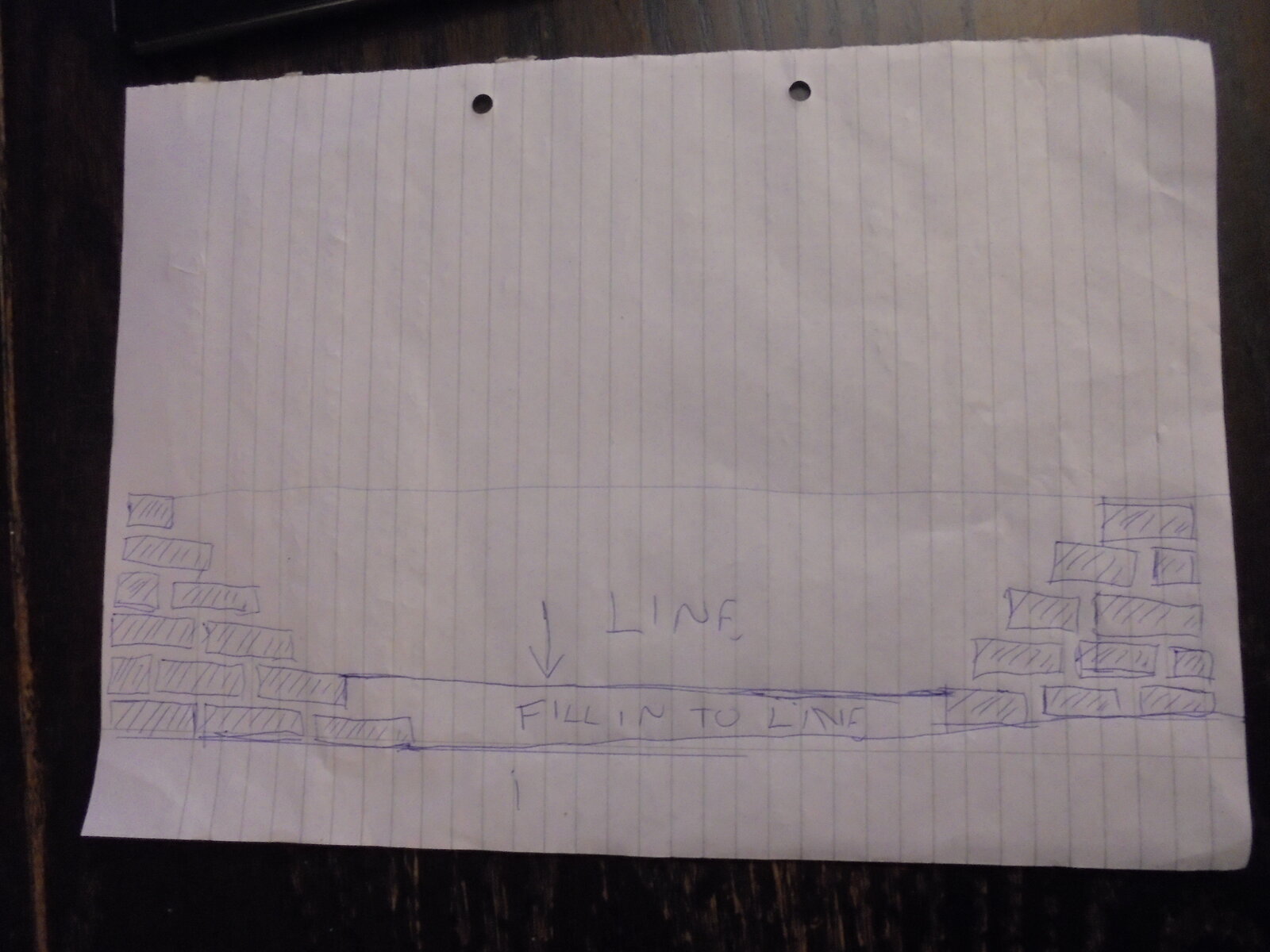

You need some datum pegs set at DPC level. Measure down from the pegs to the concrete and build up the corners to them. If you have 6 in one corner and 5 in another it's known as a pig, grunter, Billy Bunter etc. Just put the lines up so you have 4 above in all corners and run the bottom in to the line using cuts, slate, brick on edge etc and then above will work out
Stuart
Would you mind explaining the bit above a bit more, I don’t fully get it.
I understand the datum pegs. And lines.
(y)
You have 6 courses in one corner and 5 at the other, but are level. Put the line at 4 down from the top and then run in to the line. As the joint gets bigger, use some slate to build it up, or a brick on edge to keep to the line. As you get to the other end tighten up the joints for 2 courses till you get to the other end. Then you will have 4 courses over the line and it will run in.

Reading your original post and seeing Stuart’s post, I think you’d be better starting again.
I’ve built small walls before and struggled getting things as neat and level, usually as I’ve started off badly. (Won’t now thanks to Stuart’s diagram).
If you are he’ll bent on keeping what you’ve already to built (being a brick out), I’m wondering if you could do the next course out of blocks, and cut these to get it all level. Then continue with brick/block wood.
it’s a bit of faff, but doable no doubt.
Honestly, take it down and start again. You might be able to reclaim the bricks whilst the mortar is still green. Set out a datum at each corner. Lay first course to take out the roughness of the concrete and bring the level closer to datum. You might not get it level but it gives you a flat surface to work off. Adjust bed joints if necessary. Once you've got a flat surface work out the highest and lowest corner and divide courses by x to give you bed joints needed at each corner to bring it to level. Make a gauge rod for each corner. Bring up the corners and lay the runs to a line.
