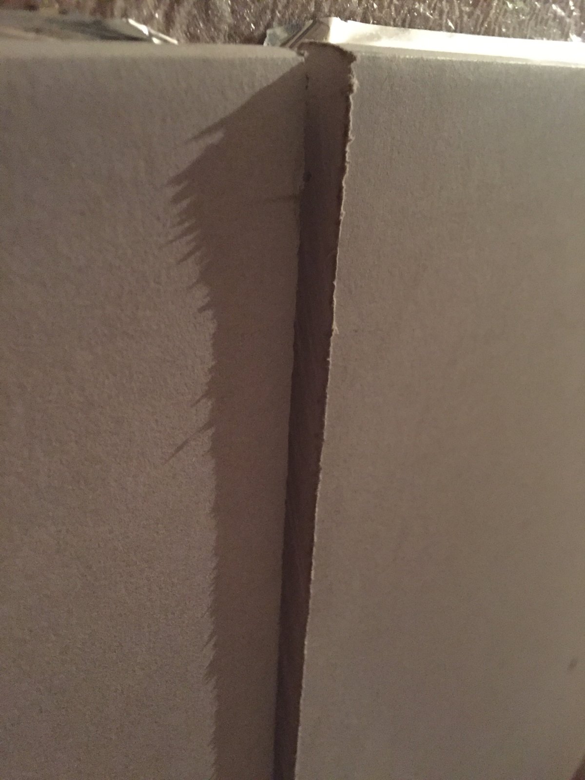

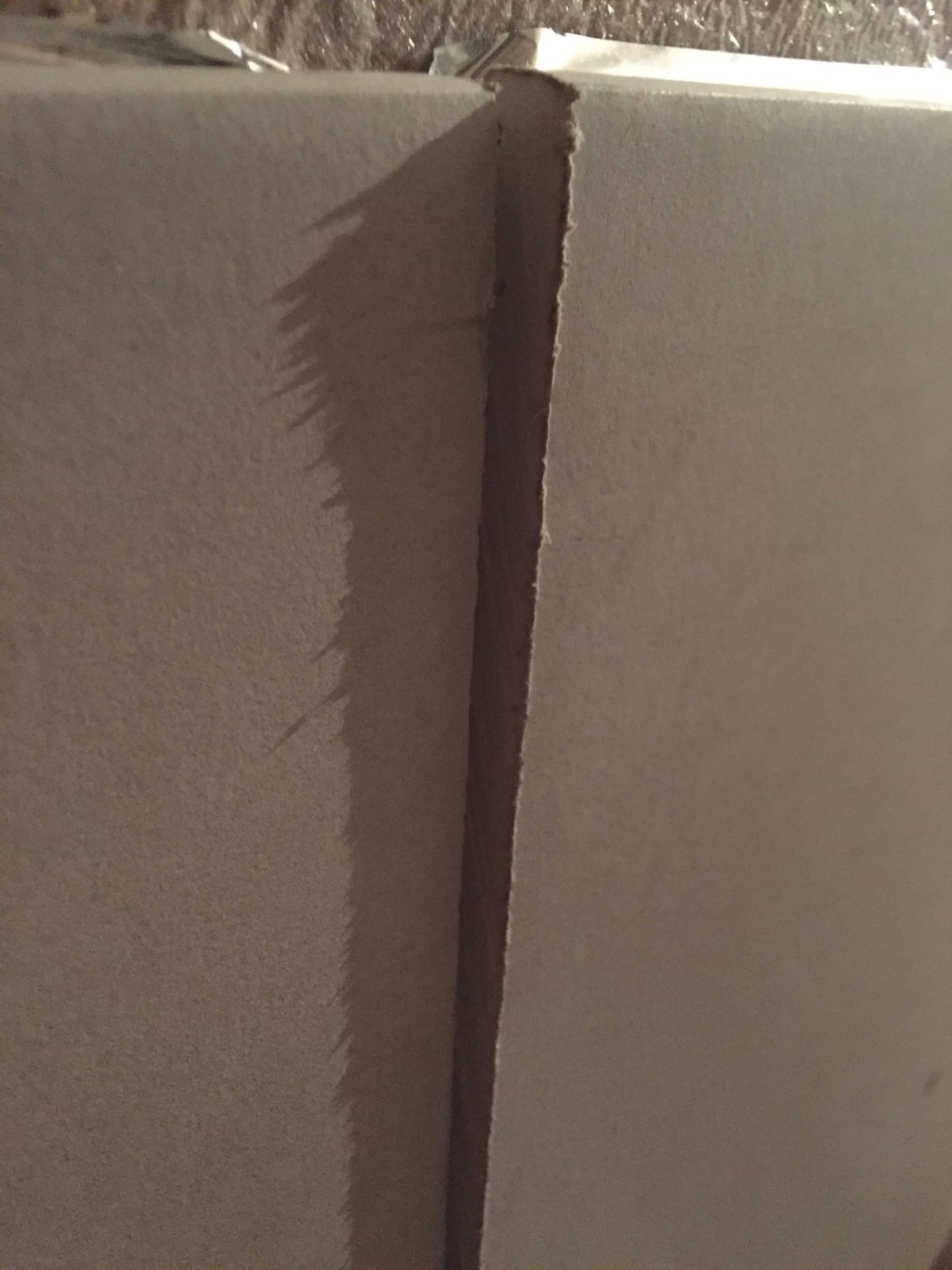

Hi,
I am overboarded the loft rafters and am now in the process of plasterboarding. I am screwing in the plasterboard into the rafter beams through the insulation. My problem is that on some joins, the is a ridge of up to 5mm - seems a bit too much to level off via skimming. Its mainly down to the joins not falling near a rafter. One side like you can push level to the other plasterboard, but when released, it raises back out. Is there an easy solution?

Also attached is an image
Here is a slight raise (sorry pic didnt upload! will try tomorrow)
It sounds like you have joins between the boards that have nothing behind them to screw into..... I assume you are screwing the boards up? If so, you should make sure you have something to screw both boards to where they meet. Suppose you could always use some adhesive behind the boards where they meet to try n get them more flush with eachother
Absolutely correct williamglossop. It’s only this one but am contemplating putting a metal/wood strip behind the flush one and then screwing the outward one into the strip bring them almost level. Any discrepancy I can level out with the plaster finish
You can also squirt some adhesive foam behind the one that's protruding and then rig up some basic way of pushing it flush till the foam goes off
Don't think that will make much difference to be honest - I'd try something simple first n see if it works. If not, you'll have to get some timber down the join - either a full length running vertically down the full join so u can screw both boards to it, or several pieces at 400 centres running perpendicular to your join.
Hi, don’t really want to take off the insulation. Will try the strip method first, if that fails, will try the glue option. Will try this next few days and will update this post.
