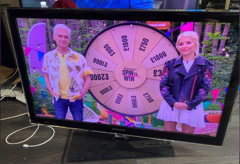

Hi there I purchased an LG smart tv back in 2019. For the past few months for some reason there is q blue backlight when watching normal tv channels/streaming apps. I am not sure why.
Has the screen got faulty? I have alternated the settings and it still doesn’t make a difference

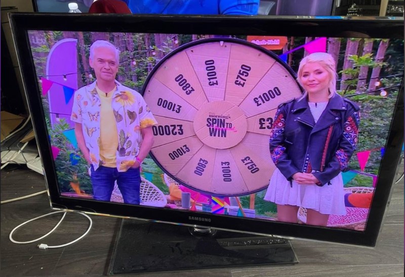

Something like this?
Yes like that but it isn’t as bad as that. But it is still a blue/purple backlight which is so annoying because you can’t watch anything without having to think about that!
It's the backlights. The emissions have fallen causing the colour change.
Swapping out the backlights should cure the problem, but you should also make some checks on the TV settings. If you're running with the contrast settings high - which would be the default if they haven't been changed - then this shortens the life of the backlights.

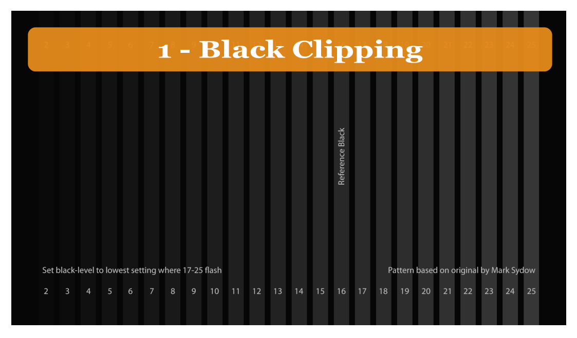

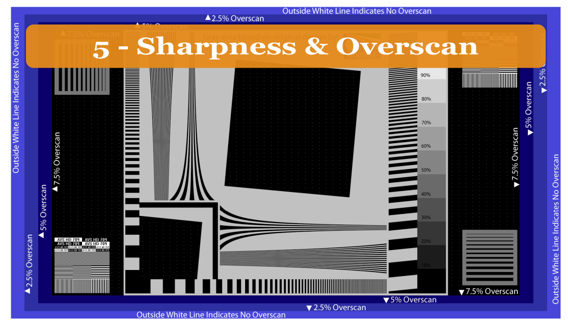

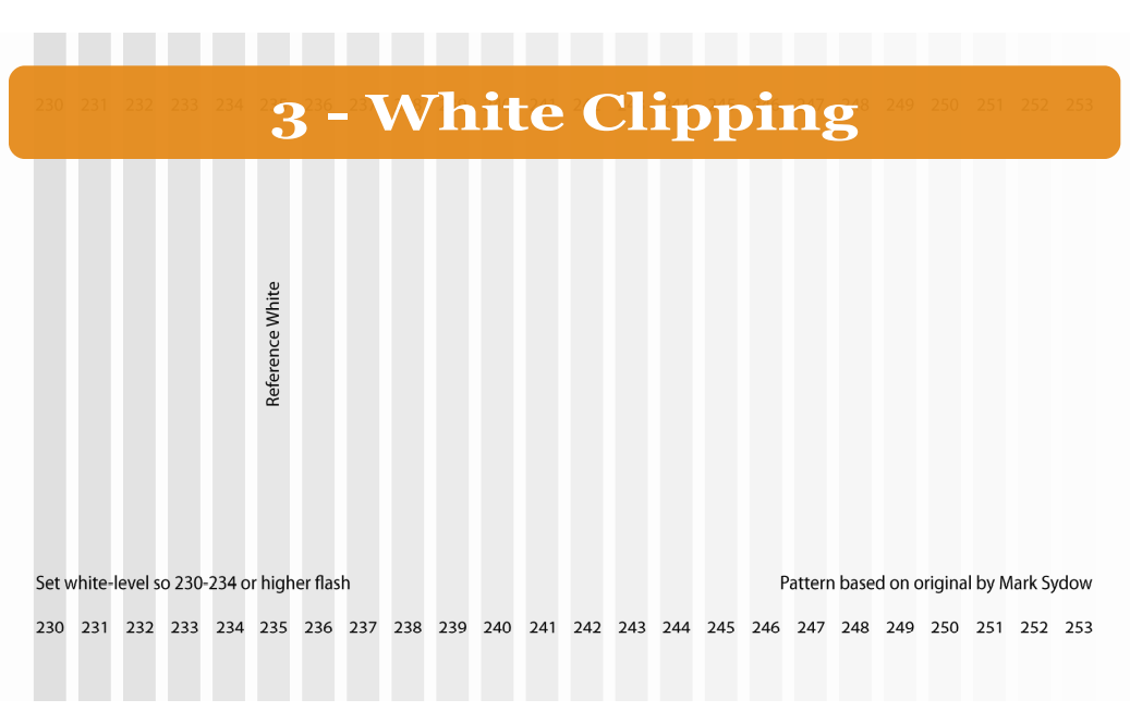

To set the TV correctly requires using some test patterns to be able to see what the TV does with a reference image. You can't do this as a novice by just looking at TV programmes and films. It's very likely that ordinary TV images have been Colour Graded (adjusted for brightness and contrast) scene-by-scene to make the best use of the dynamic range range on offer. IOW, if you use a TV prog to set brightness and contrast with one scene, then it will be wrong for the next scene if it's substantially brighter or darker, so you end up riding the TV controls to compensate all the time. With test patterns you set up to the industry standard. This is the same standard the Grader used. That means you see what you should see in all scenes within the limits of the TV's performance.
The patterns you need are Brightness
Contrast
Mixed APL (Brightness and Contrast in the same image)
Sharpness
and... depending on whether you want to go the last mile - Colour
The above patterns are from the AVS HD 709 test pattern set which can be downloaded and used for free.
https://www.avsforum.com/threads/avs-hd-709-blu-ray-mp4-calibration.948496/
There's also a pdf user manual from which the above screen shots were grabbed. You're only reading the first two pages because the adjustments being done are very basic. Once you have an idea of what you're looking for then the total time to do the 4 or 5 settings is under 10 minutes. Yes, that's all it's going to take to get any TV running correctly for SDR.
The patterns can be downloaded and run from a USB stick in many TVs.
