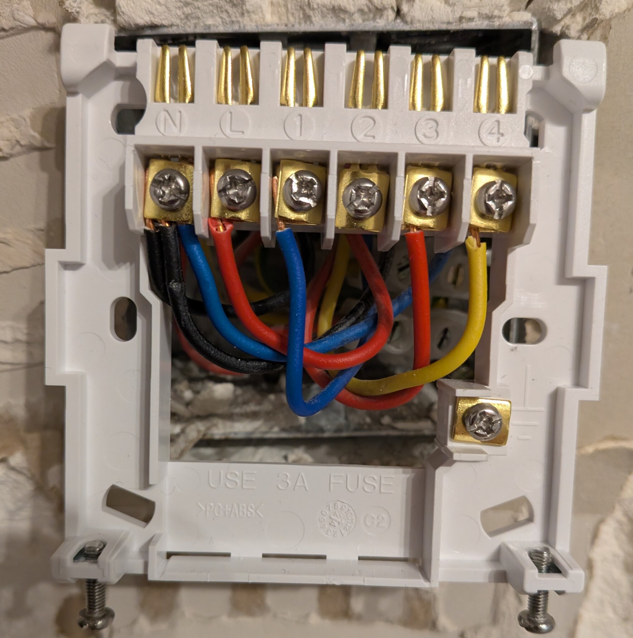

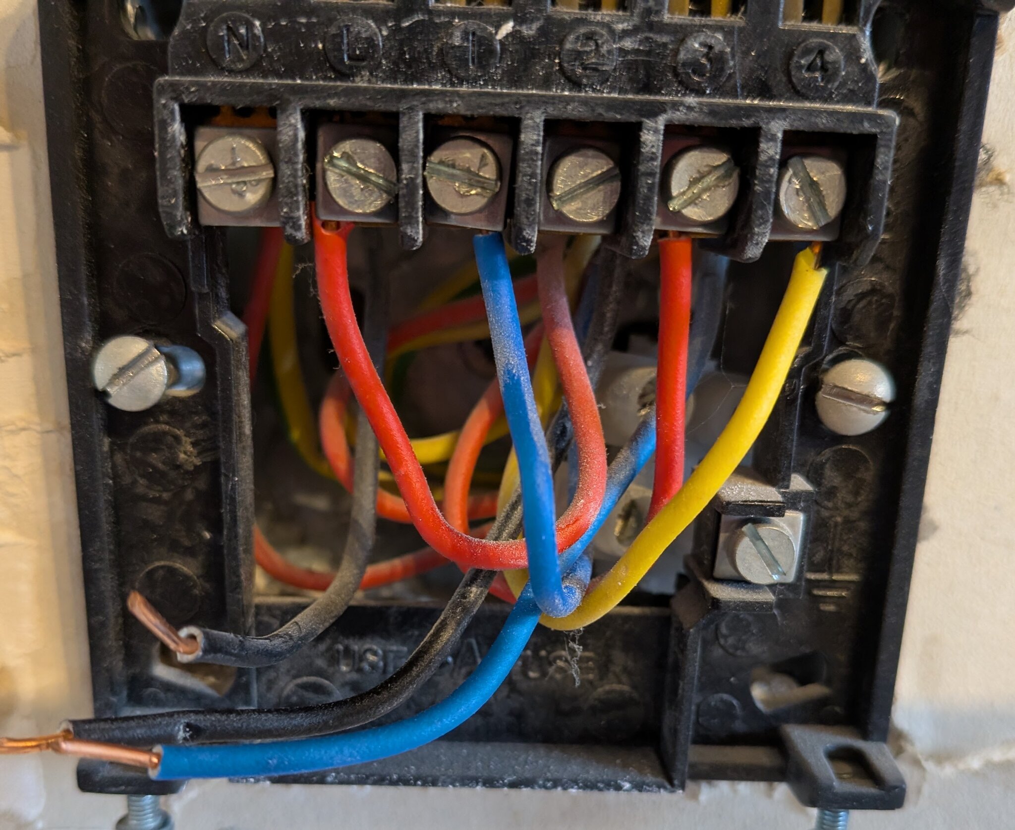

On the LP241 programmer terminal block, the connections were N, L, HW off, HW on and CH on. There was NO connection for CH off (Pin2). I did a 1:1 wire swap on the Hive unit.

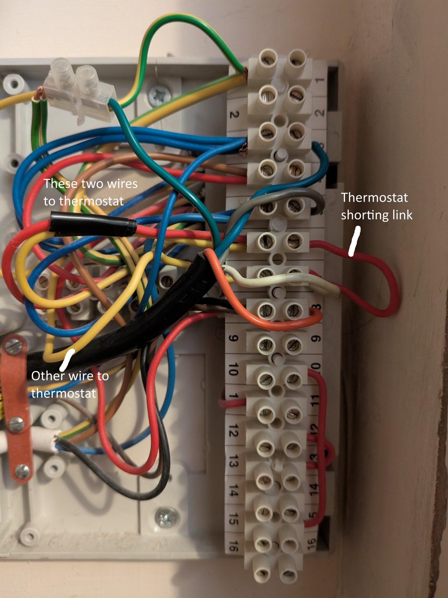

I traced the mechanical thermostat wiring back to the wiring box in my airing cupboard and linked the wires together with a short piece of wire (so linked together on the terminal block and wires open circuit where the thermostat was.

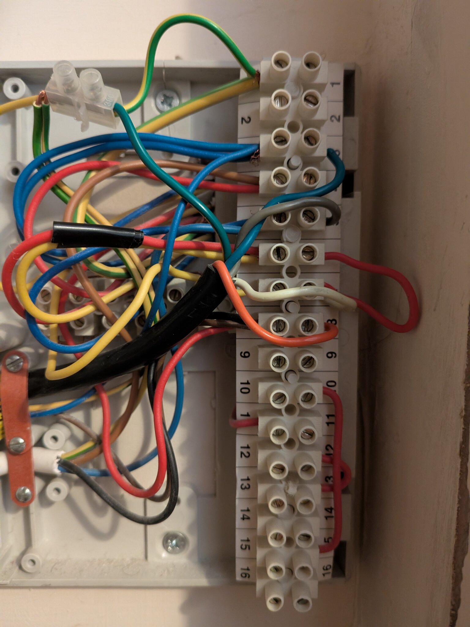

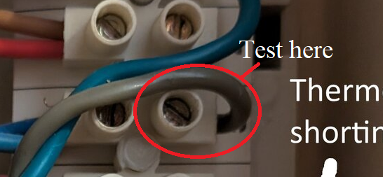

OK Here are photos of the original LP241 plate (I had removed the three L wires), The Hive plate and the mess of wiring in the junction box :(

Failing all that I will try and find a complete circuit for the system ie control box, pump, 3-way valve and thermostat and trace all the wiring back to the terminal box labelling each wire and ensuring that they go to the correct position.

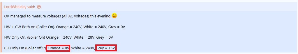

OK managed to measure voltages (All AC voltages) this evening :)
HW + CW Both on (Boiler On). Orange = 240V, White = 240V, Grey = 0V
HW Only On. (Boiler On) Orange = 240V, White = 28V, Grey = 0V
CH Only On (Boiler off??). Orange = 0V, White = 240V, Grey = 15V

These are what you should have, so something is amiss

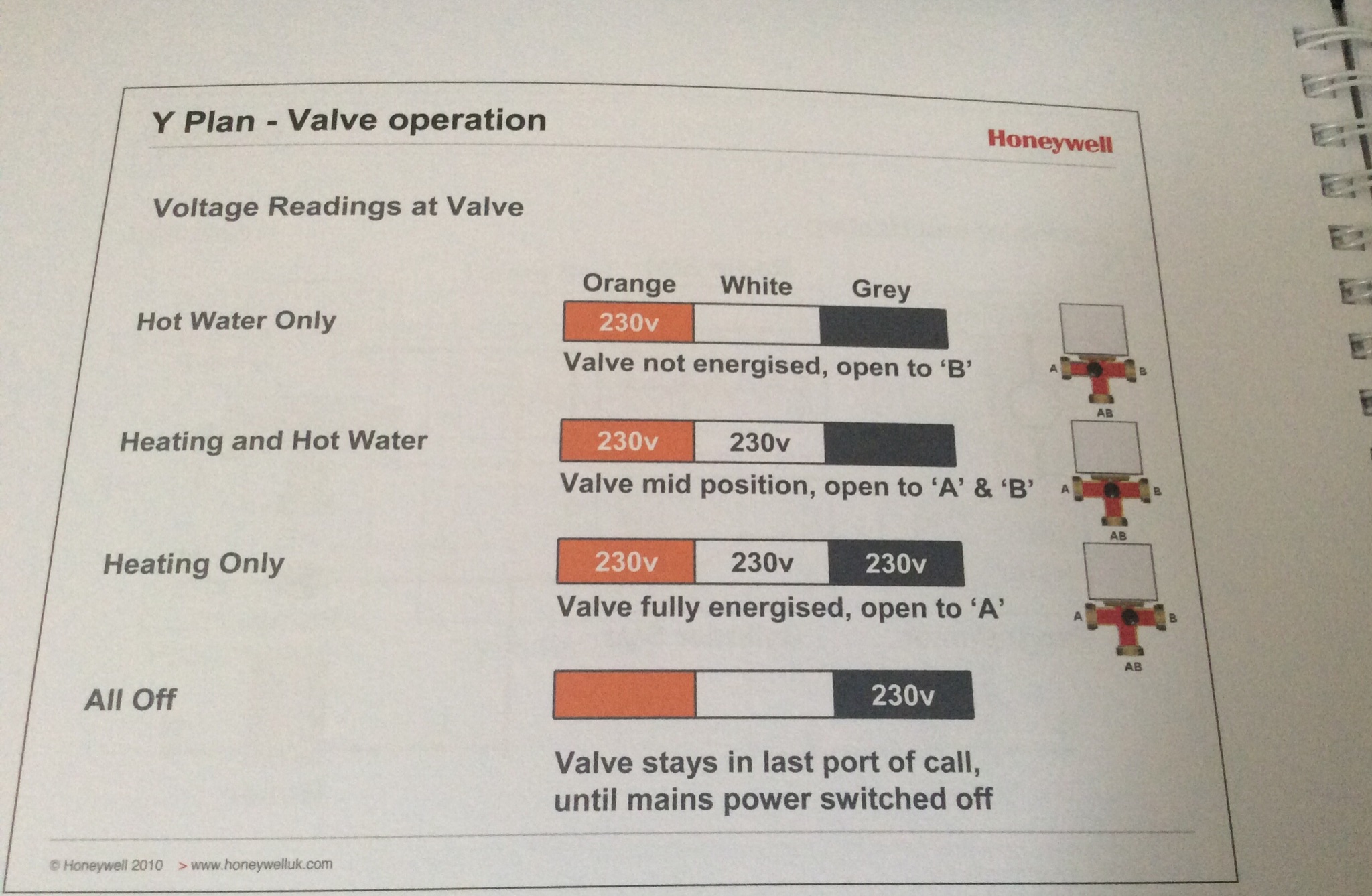

So here's the problem.
When CH only is required there should be 240v on the white (CH on) and grey (HW off). Both are required to be 240v to wind the valve over to the CH only position when it operates a microswitch that puts 240v on the orange wire and the boiler starts.
You seem to be lacking the HW off signal

'HW off' comes from two places:
1. Programmer (or Hive) HW off
2. Hot water cylinder thermostat satisfied
You can see in the diagram below how wires from both of these two places connect to the motorised valves' grey wire. By doing so if HW is 'off' at the programmer or the hot water cylinder thermostat grey is made live.
It would be real coincidence if the tank thermostat was faulty at the same time as swapping the hive unit. So I wonder if the hive unit is actually providing the HW off mains supply? I could try and measure this at the control box?? A faultly Hive unit would make the most sense?
The easiest way would be to check for 240v on Hive terminal 1 with the HW set to off. Remove the wire that is currently in the terminal for the duration of the test to prevent any unwanted voltage coming from it.
Yes, so I would check the Hive first, but it may be possible for you to have disturbed the wire from the cylinder thermostat or the Hive in the wiring centre when you were inserting the link for the room thermostat.
However, when the Hive is set to HW off the grey should be live regardless of the position of the cylinder thermostat, and from your 'truth table' it's not.
