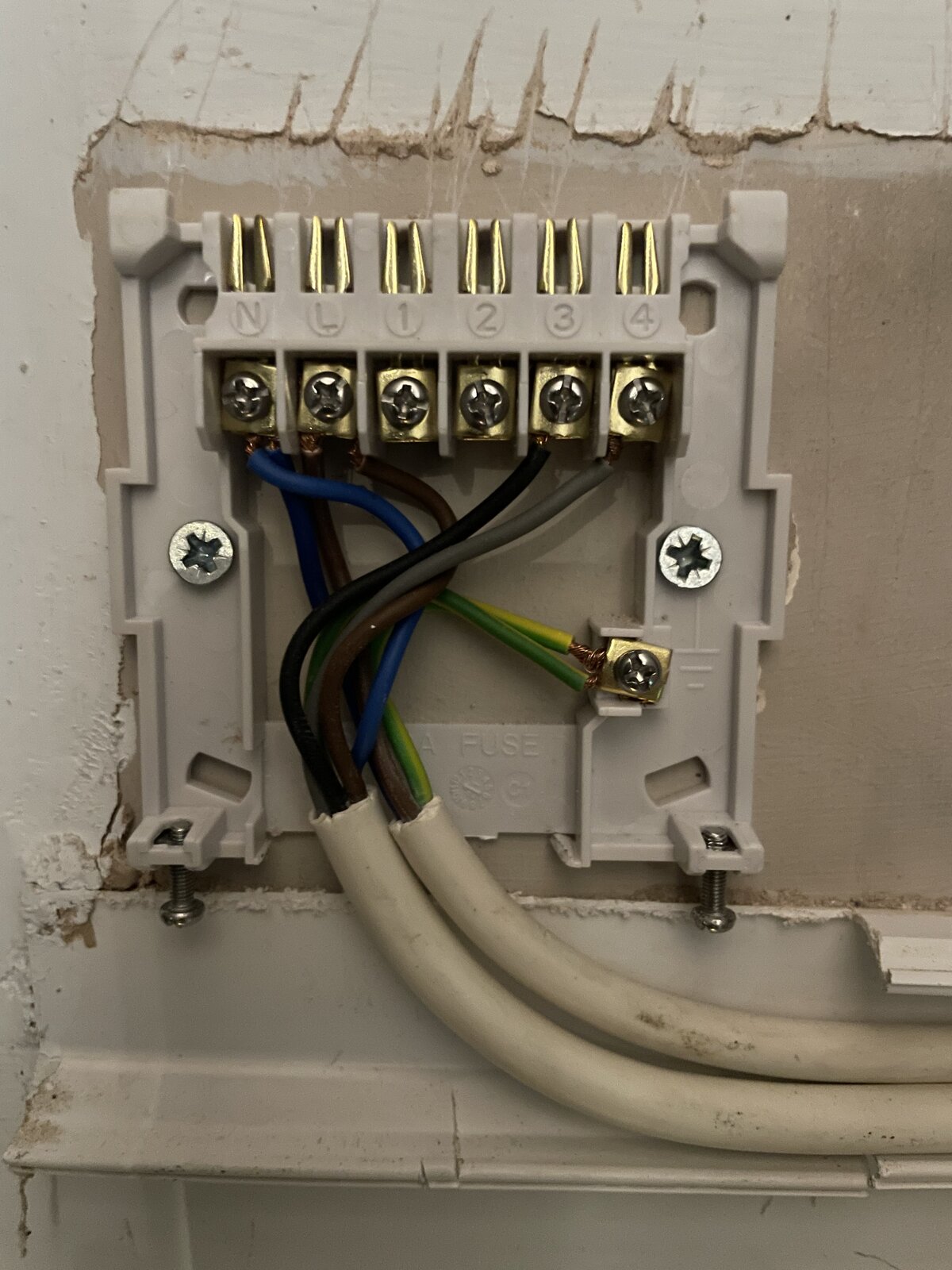

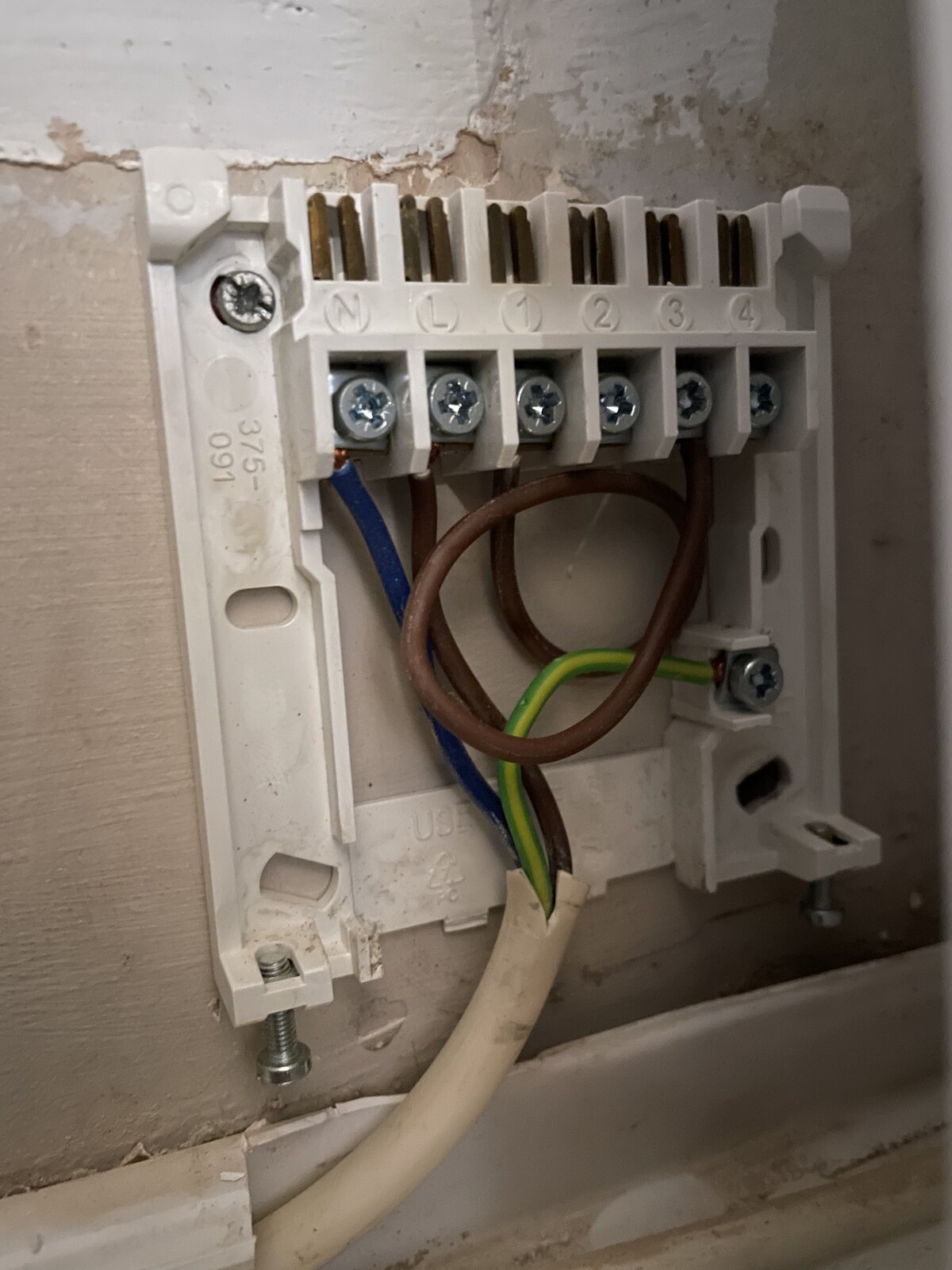

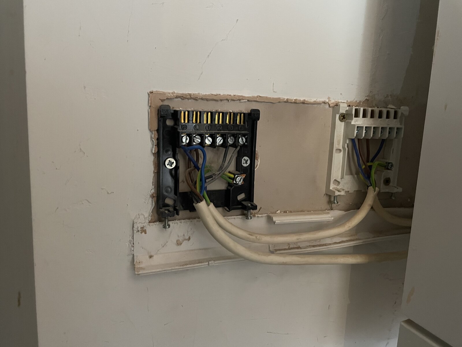

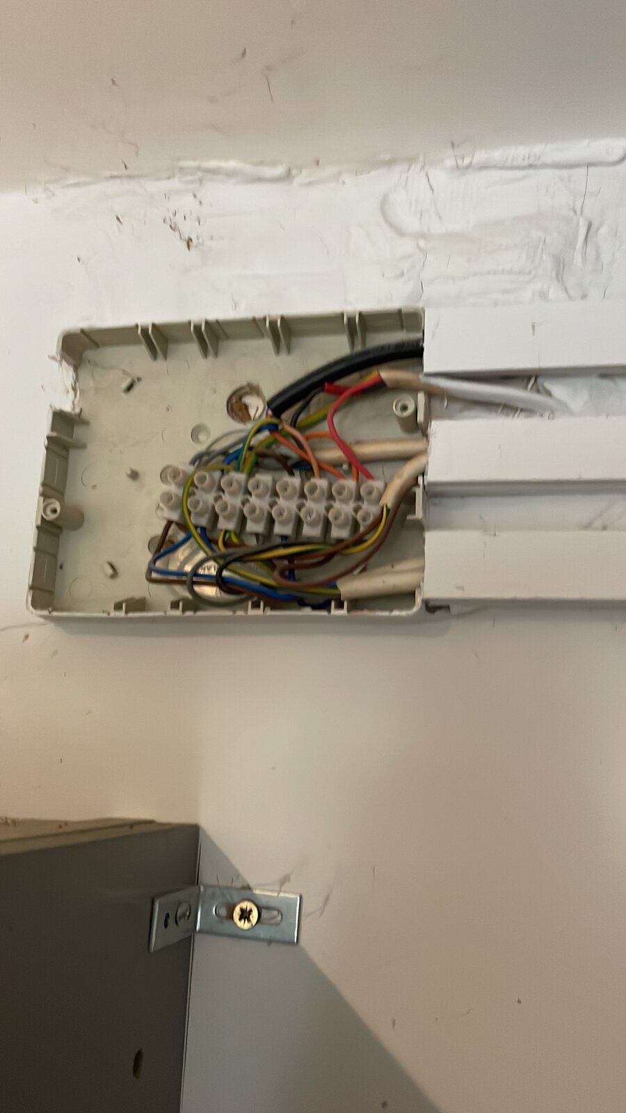

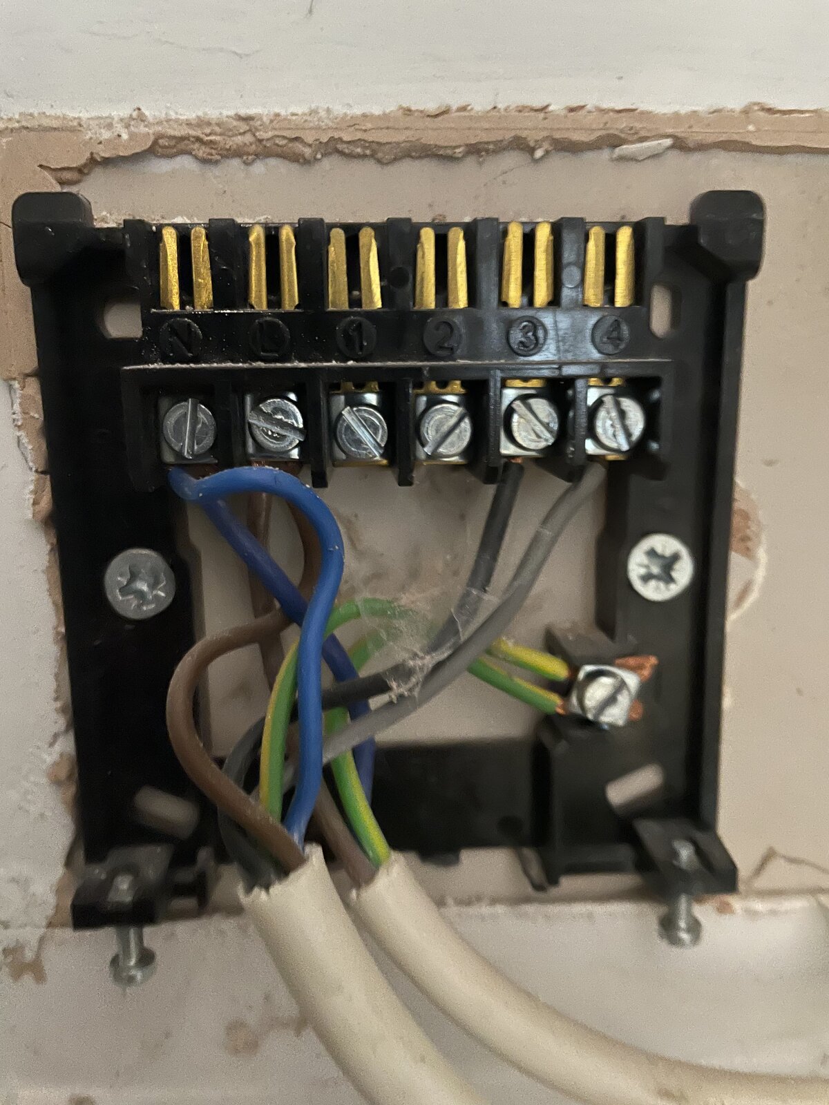

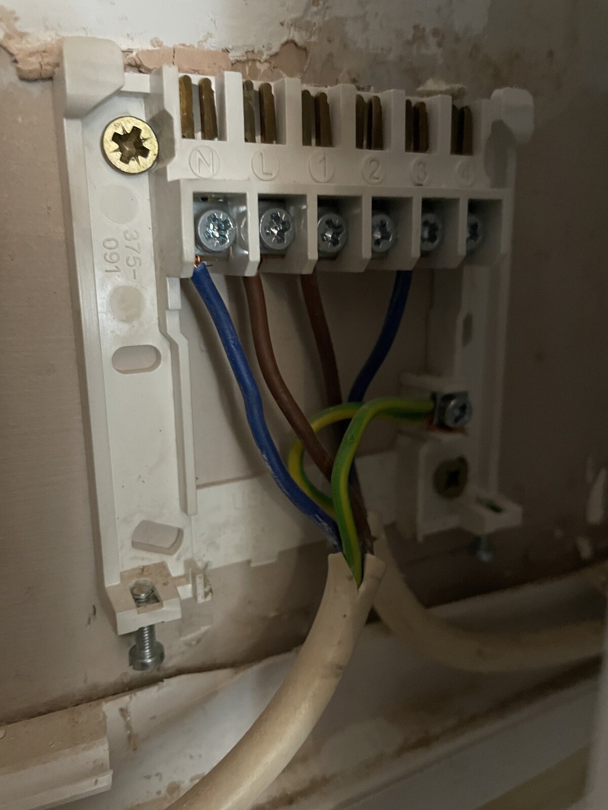

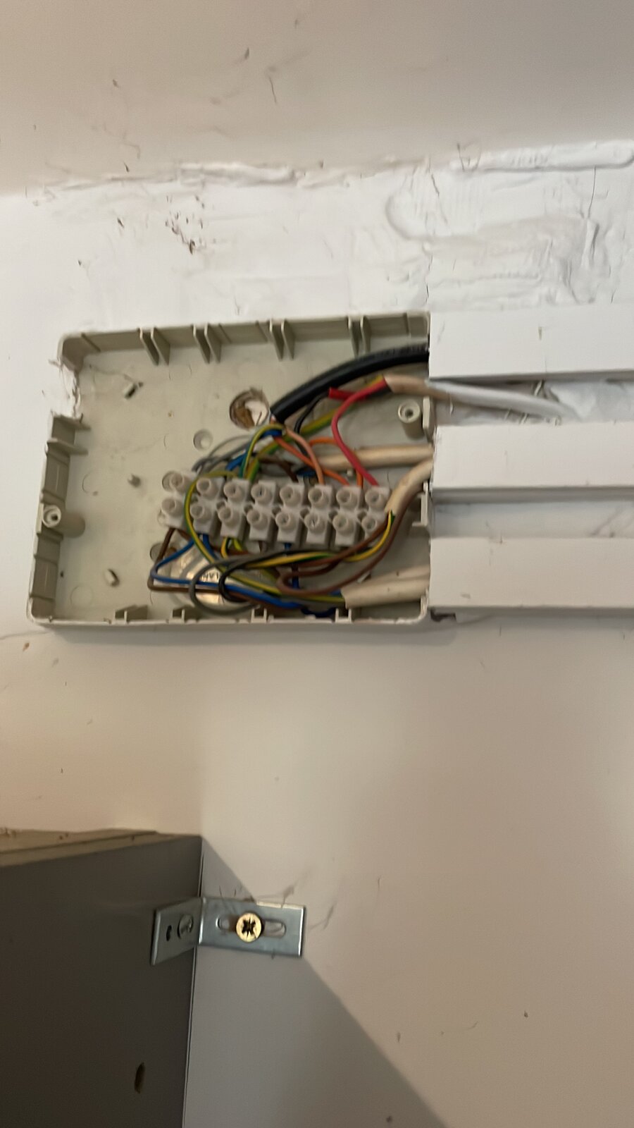

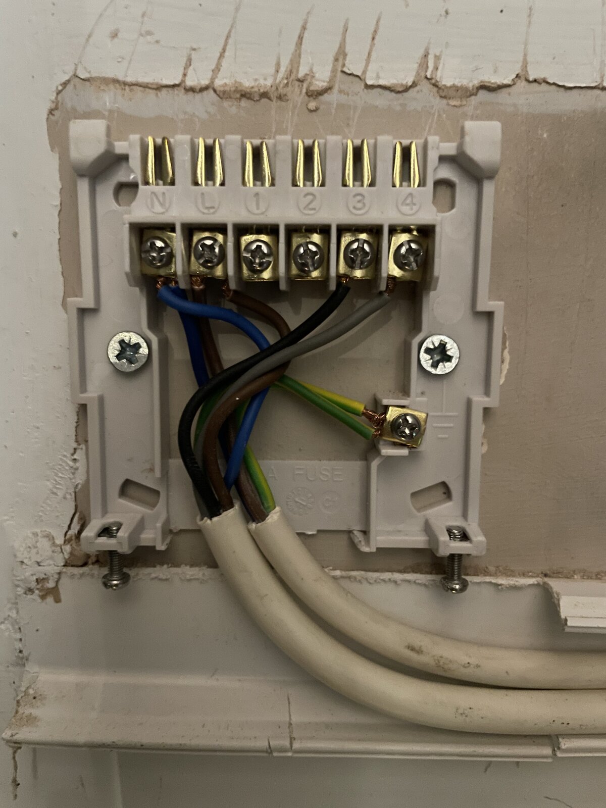

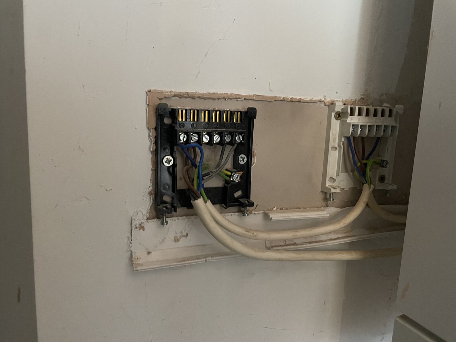

Hi, I have done a self install of my hive for the lp241 programmer.
I have read on here that it is a like for like switch for the lp241 to the hive dual channel receiver, however I have a slight issue on the heating side.
I have disconnected the previous thermostat and linked the terminals together.
The boiler currently ignites for hot water but when the hive reciever asks for heating, the boiler makes a noise but does not ignite.
Anyone able to look at the wiring and see if anything is incorrectly placed or done incorrectly.
Thanks in advance.

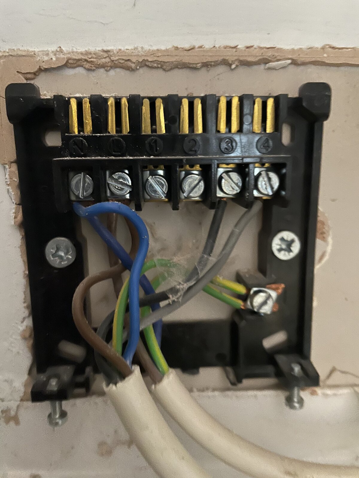

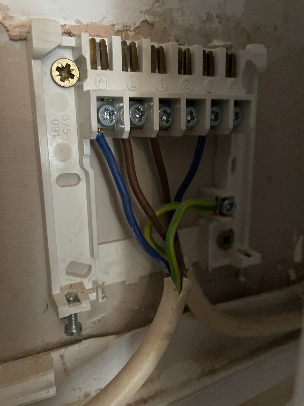

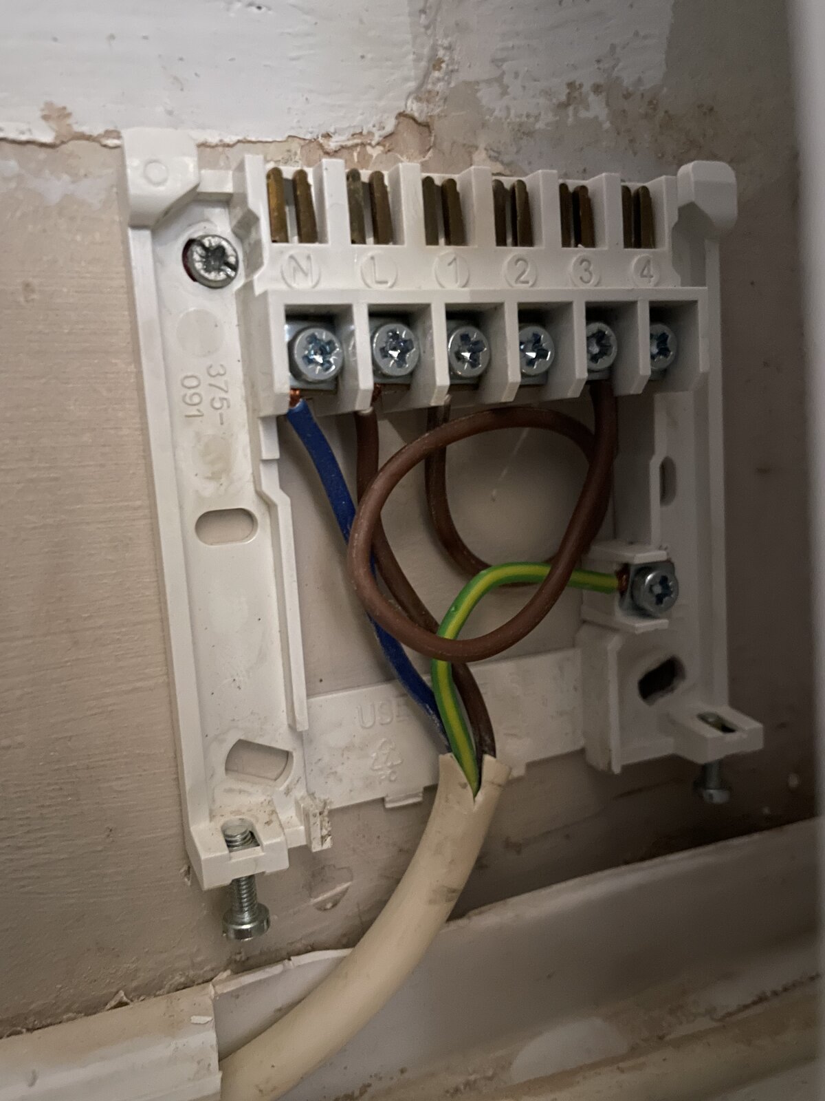

Also had a Drayton digitstat SCR next to the lp241 programmer
To disconnect the previous heating stat I removed the cable that goes from the junction box and connected to the digistat scr in terminals 1and3 and replaced with a cable joining those terminals together in the scr. I think this is where my issue is.
Where have you looped the digistat in the wiring centre? Looping at the digistat end on the backpanel isn't doing anything.
I’ve sorted, joined together at wiring vents rather than digistat.
Digistat is out now
Thanks for reply
