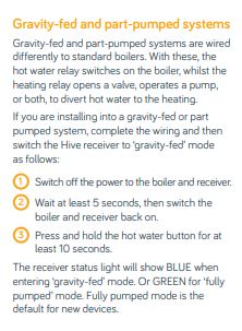

That's a bit of a brief description. If you have a fully pumped system with motorised valves all will be OK. However if you have an antiquated system with only pumped central heating and gravity circulation hot water. Then the Hive will need to be set to gravity mode.
Erm. I don't think you understand, don't confuse gravity circulation with having a feed tank in the loft, that's completely different. You need to identify which system you have correctly.
how do i set the hive to gravity pls
It tells you in the instructions. But don't set it to that if it's not that type of system.
mmmm ok, how do i do that? there is a pump for the heating under the hot water tank, it's a grundfos, it's a very old system as it's a rental property, and landlords don't like spending money on updating things
there's writing on the wall near a shutoff valve which says ' cold water supply from tank in roof valve is crap' lol
Old systems were plumbed so that the pump circulated water only around the radiators, but the hot water cylinder was not connected to the pump, it relied on the natural principle of hot water rising and cooler water falling to naturally circulate hot water around the hot water cylinder. This is known as gravity circulation.
A tell tale sign of a gravity system is that in order to have the heating on, the hot water also has to be on at the same time. Usually when selecting the heating to come 'on' at the programmer it automatically switches the hot water 'on' with it as well.
Gravity Hot Water, Pumped Central Heating
Fully Pumped
yes if i switch the heating on and the water is off, it switches the water on automatically
you are a diamond, thank you so much, i have been playing with this for days,
and it all works or seems to the way it should, thank you again
