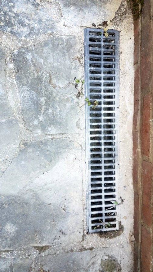

A drain in my garden has been getting clogged up and I'd like to lift the cover grate to inspect and hopefully give it a clean.
Any idea how I could get this off or is it non-removable?

The grating is fitted to a channel.
I think I can see the grating screw heads that tie the grating to the channel?
Simply unscrew and lift out - if its tight then carefully prise the grating out after removing the screws.

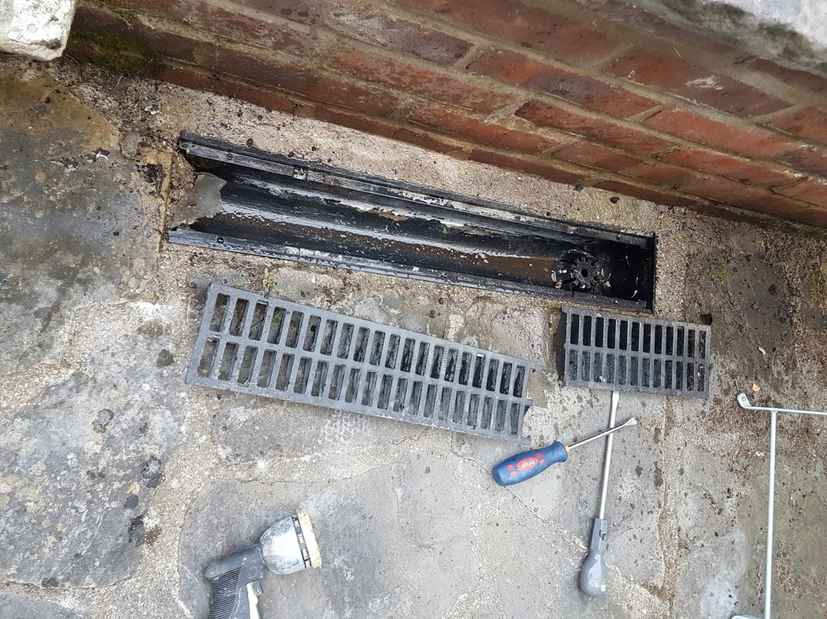

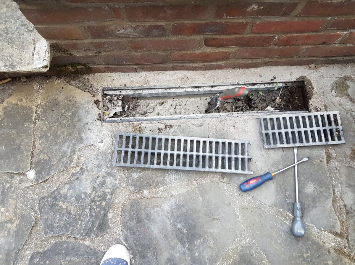

Thanks all for your help. It turned out to be a plastic cover without any screws or clips. It came off in two parts after a few minutes of prising around the edges with a screwdriver. I think it must have been split when removed previously.
There is a drain hole at one end of the channel - not sure where it lead!
After cleaning the muck out it is working well again. I appreciate your advice. Pics for your reference.
