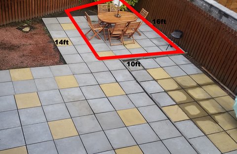

I'm looking to build a 14x10' shed in my garden and plan on using a slab base. All of my garden is slabbed anyway but the section where the shed is going to go is not level. You can see the area marked out in the image below (I was going to build it myself that shape but have decided to go for a standard size at 14x10).
At the moment the slabs are just layed on top of some sort of fine black substance (I know nothing about garden DIY!) And they aren't cemented down.
I was wondering what the best way to tackle it would be. You can see the patio has a 2" or so drop and at very end of the shed which I would like to remove, otherwise the shed will be quite high up (by the time it is built on a wooden frame ) and I would struggle to get my motorbike in it.
I hope this make sense and appreciate any help given!
Thank you

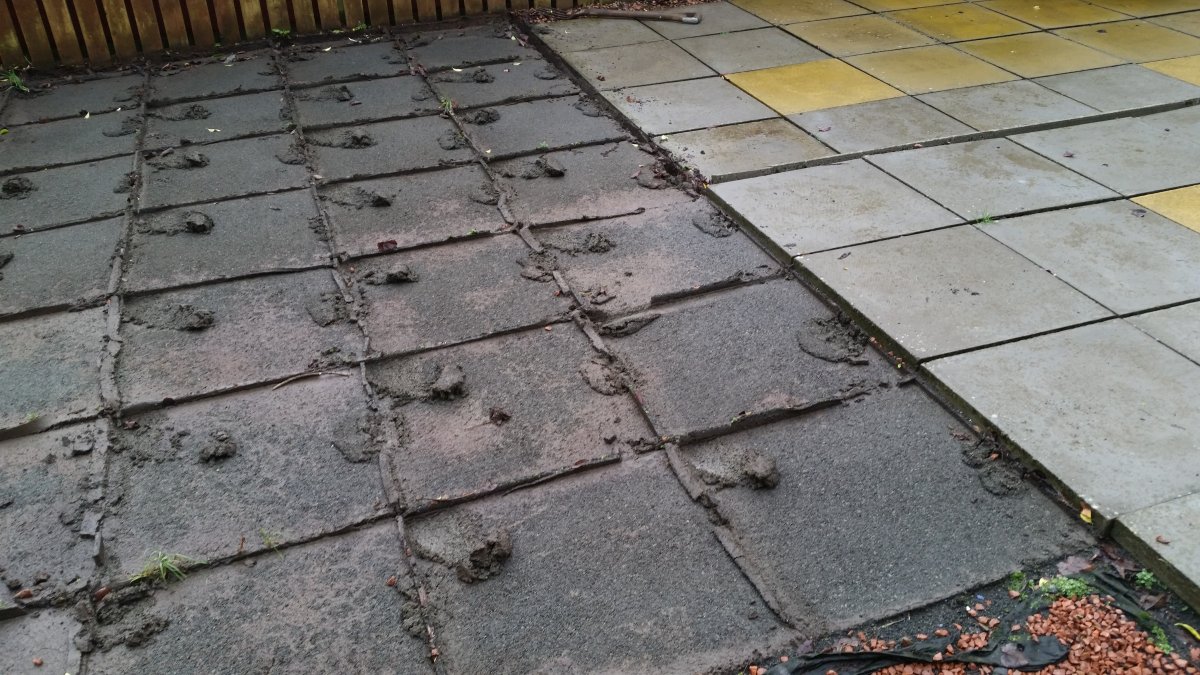

Unless this is a super light trials bike or similar then you will definately need to do some decent work.
I would recommend that the shed area had at least a 75mm sub base and the flags must be laid on a sand and cement bedding and ideally pointed with mortar to create a fully rigid pavement.
The weight of a motorbike rolling over flags will cause a rotation effect as the leading edge of the flag is weighted it will want to flip the other side up so the flags must be stuck down and pointed to avoid this.

Hi Steven, if the shed includes a 22mm floor panel, and that is on top of floor beams, how much over your current patio slab height is the floor of your shed going to be?
The shed base might might double the height of the obstacle you have with your existing edging?
Can you ramp the pavers in front of the shed up to the door, over that distance you might not noticed the angle, even with a big bike?

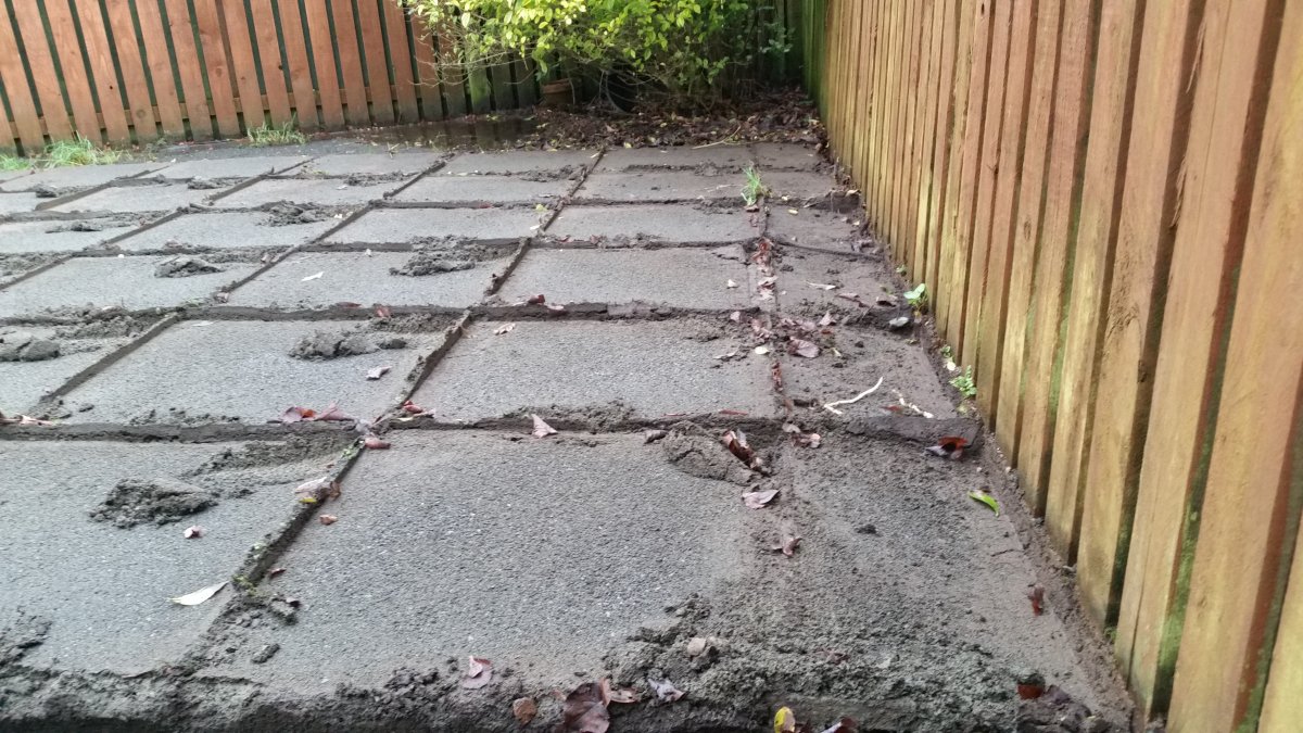

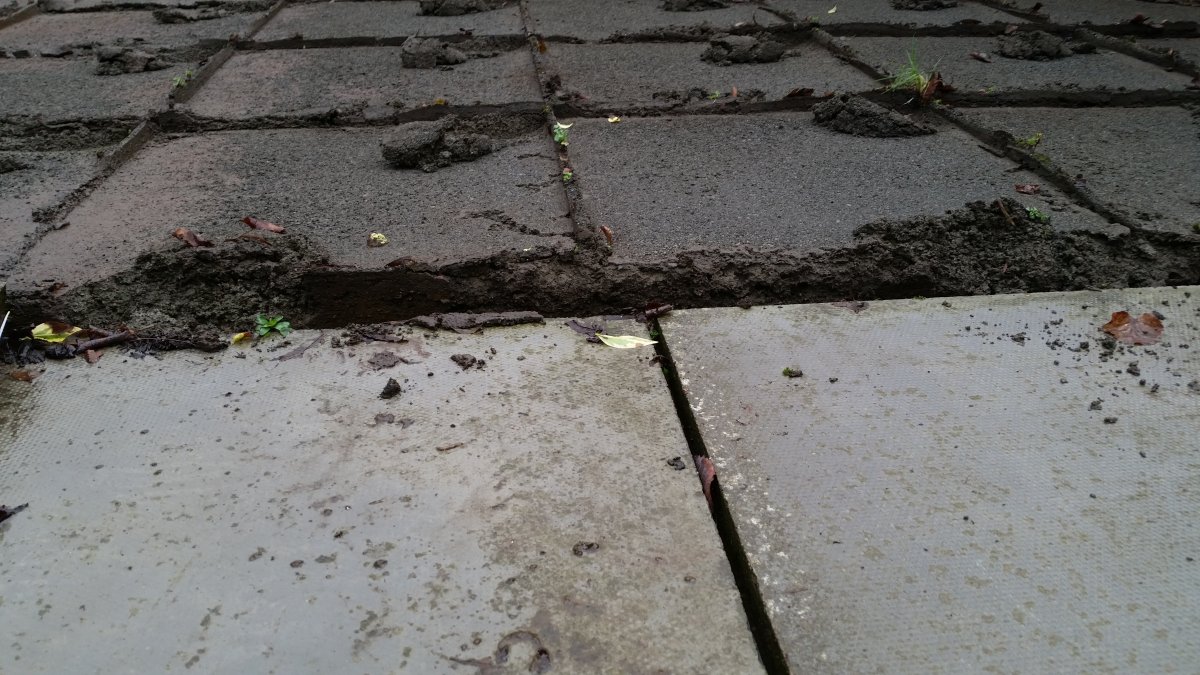

I got some work done today and lifted all the slabs for the area the shed will be going in. They were just sitting on top of a sand like material.
Being a completely gardening beginner, would someone be able to give me some advice about what I should be doing next? How much should I did and what materials should I be using to lay the slabs?

I notice you have some standing water next to the bush, I guess you are relocating the bush, so the water might get worse? Perhaps it is due to the garden fabric, but if there is already pooling, I might be reluctant to recess anything but the pavers, or you might end up with your timbers sat in water. Even if you do recess the pavers it is worth having somewhere for any water to drain away round the edge of them. It was surprising how much rain water the shed used to spill! I used a flexible perforated land drain pipe that I bought on ebay for a couple of quid. This was surrounded by pea shingle and drained into the deepest hole that I could dig on the other side of the garden. I filled this with bricks, builders rubble and pea shingle. I capped it with a couple of pavers to stop soil subsideing into the void from above and blocking it up.

You can see the slab underlay(?) sloping towards the fence. It looks as though your ground is higher then your neighbours. This is a severe problem.
