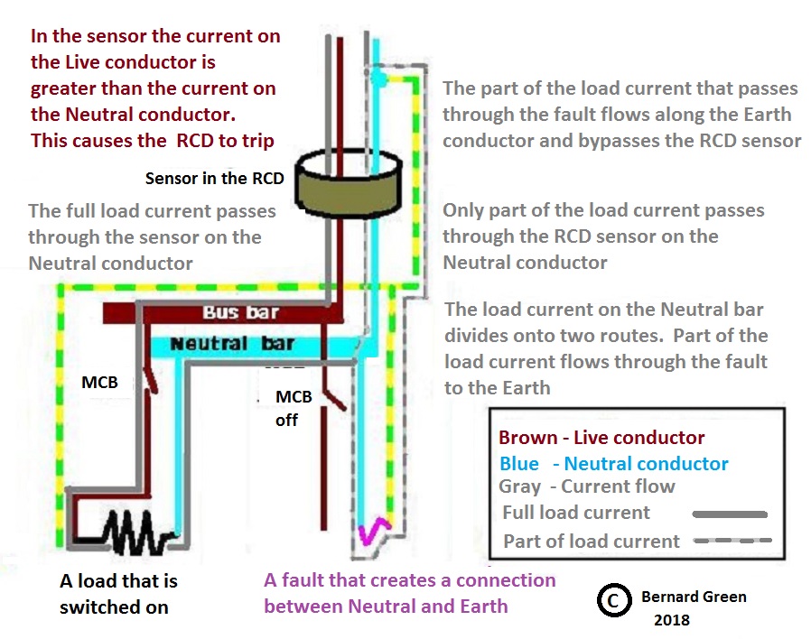

Believe it or not, you would be contravening the Regulations to do it intentionally
Why an RCD can be tripped by a Neutral to Earth fault / short even though the MCB for the circuit is switched OFF

It may depend on what else you had switched on in the house at the time!
