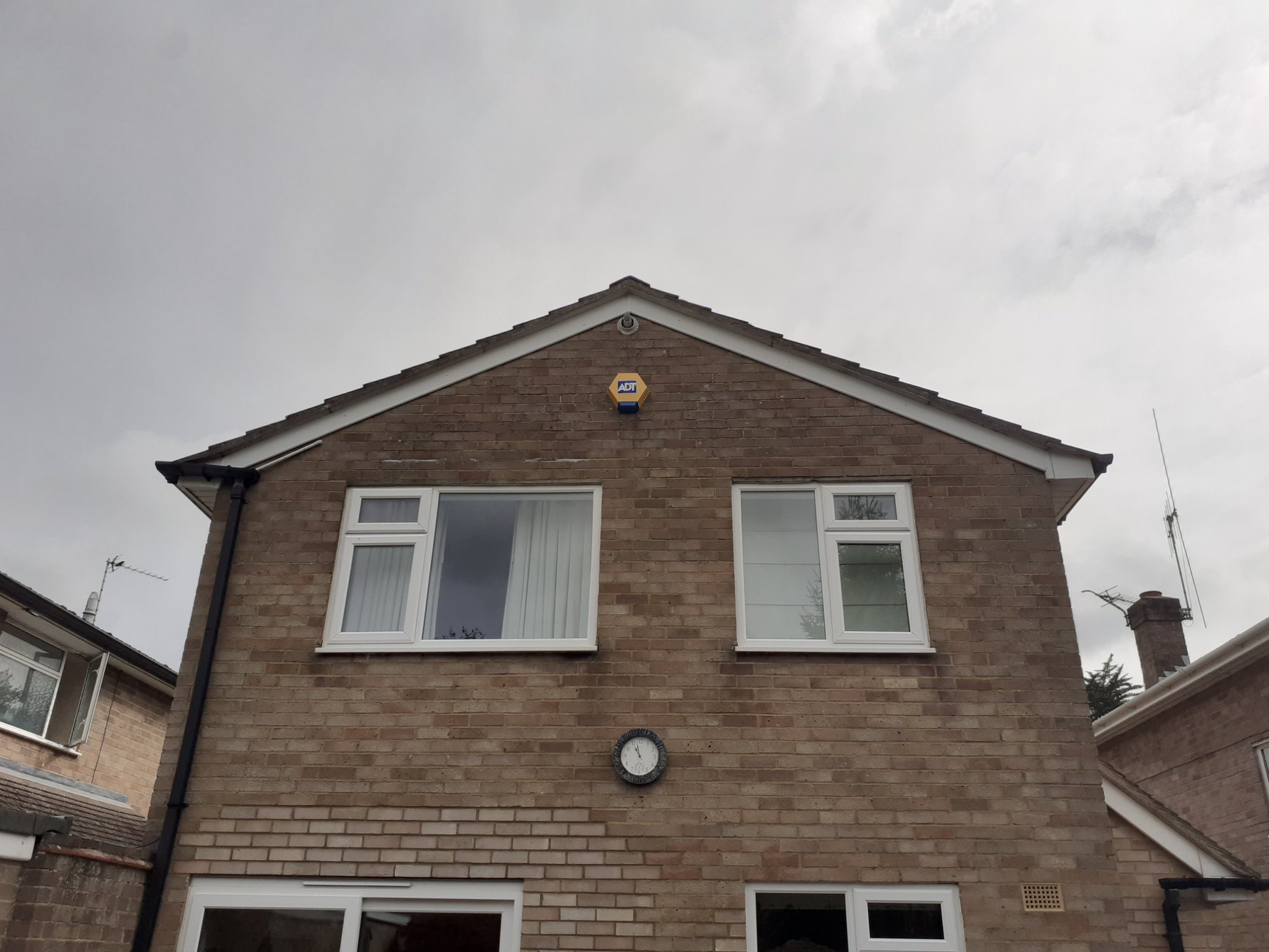

We have a detached house, built in 1968 with a pitched tiled roof and wall construction which consists of outer brick, an air gap and inner block.

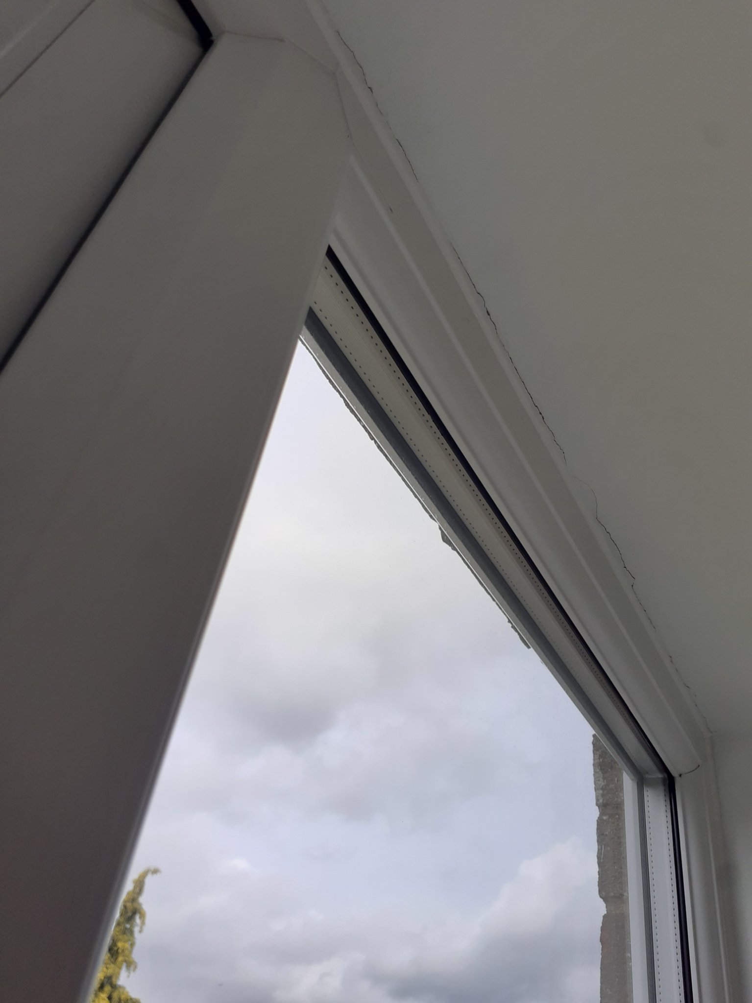

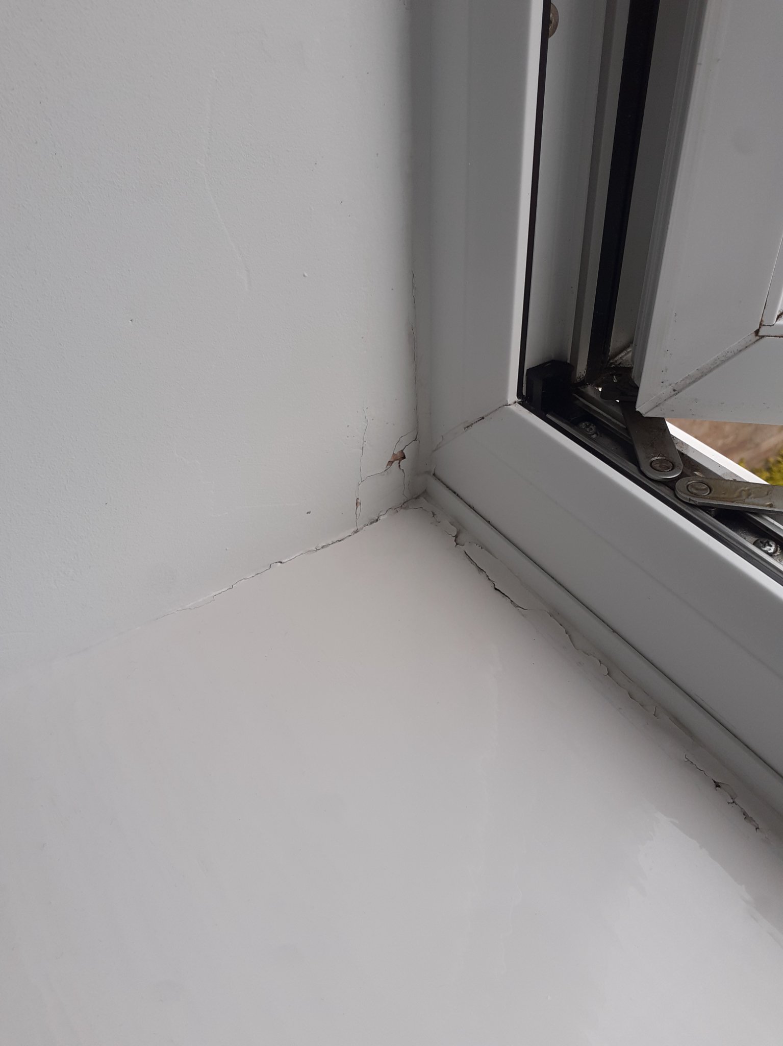

On the west facing wall we have first floor bedroom uPVC windows where in the window reveals light mould and then moisture builds on the paint which results in flaky paint and then a slow softening of the plasterboard. This occurs on both the side and upper reveal for both windows and it is predominantly where the plasterboard meets the uPVC window frames.
The issue was in place both many years before and the years after the fitment of replacement uPVC windows which were fitted in 2005. There have never been lintels in place in the outer brickwork but there are on the inner blockwork. The issue is not in place in any other windows but it does appear to affect a number of identical houses in our road.
I have attached photographs below.
I would be very grateful on thoughts on what maybe the root cause of this issue.

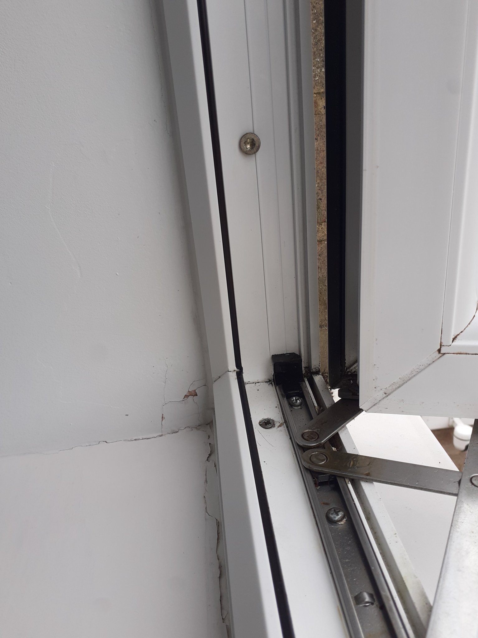

Your images are not showing much, other than common skim and mastic cracking from thermal movement of the frame and maybe cooler edges of the reveal making the skim brittle.
I can't see any staining or signs of water penetration, or mould.
Looking at the picture of the gable there appears to be something running along the mortar 2 courses above the larger window. Obviously I have no idea from looking at pictures but water can penetrate brickwork either through the bricks or mortat joints. Or it could be getting into the cavity at the verges. Have none of your neighbors had the problem investigated.
Perhaps the photos arent the best but around 2 years of repainting the plasterboard certainly begins to fail
The white line appears to be silicon but this was installed by the previous owner. One neighbour seemed to feel that in his house the bricks and mortar above the windows had sagged due to a lack of lintels

There's a fair bit of brickwork above. It's normal to omit outer lintels where the roof's a few courses above, but this being a gable end there's a lot more. That's a concern for the weight and the height over which condensation can gather.
Cue the internet experts saying bricks don't need lintels as they hold themselves up bla bla bla, all rubbish!
If you're seeing softening of the plasterboard then that's unlikely to be just condensation from within. Perhaps look at getting a few courses removed and new lintels and cavity trays installed, with weep vents. Will definitely need scaffold, for safety and to prop the wall.
Also look at how many screws are holding the windows in, they look to be moving around a lot. Perhaps add more and/or fill the void with foam, which will also reduce any condensation by insulating it.
