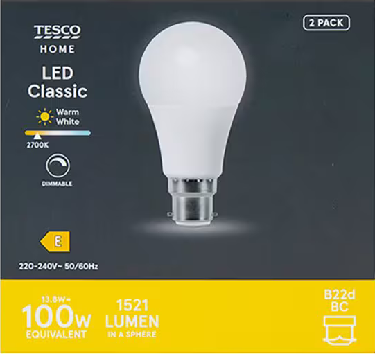

There has been a faction who say bulbs grow in the ground for years, however what other name can we use? Lamp, Fitting and luminaire covers the whole item, we have fitted lamps onto spigots, with oil lamps for years, and still do, I watch them changing the lamps front to back every time the train comes in.
Yet the 13th edition said "(ix) Lighting fittings using filament lamps installed in a room having a non-conducting floor, mounted at such a height that they cannot readily be touched and are out of reach of earthed metal." so it seems we have called it filament lamps for years. (1955 the requirement for not needing an earth to lights).
I feel either the two wattages should be the same size, or the equivalent watts should not be shown. So many read on their dimmer switch 20–300 watt, so they look for a bulb which says
and over 20 watts and expect it to work.

The equivalent watts is to help people pick the right LED wattage by comparing it to the old school tungsten lamps.
"Equivalent Watts" should NOT be indicated.
Only Lumens and "Colour Temperature" (Kelvin) should be stated - in large Type and easily found !!!
I can see why the equivalent watts are displayed, but not displayed larger than the actual watts.

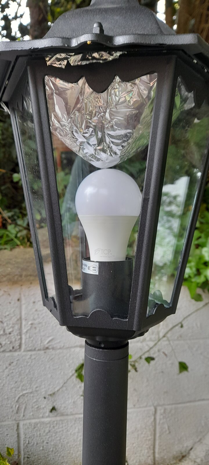

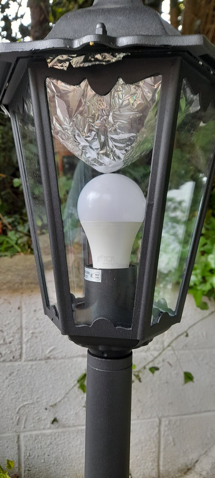

In read terms, neither watts nor lumen help that much, the problem is LED equivalents are often directional so can never be equivalent, or if not directional have a reduced illuminated surface, so replacing a MR16 with an LED equivalent one has no reflector, and smaller surface area. Or in an outside lamp, 20230518_174342.jpg it is shining up lighting the sky rather than the ground, I did experiment with reflectors, using baking foil, ended up was a smaller piece, but all but one of my outside lamps the base is at the bottom.

In read (sic) terms, neither watts nor lumen help that much, the problem is LED equivalents are often directional so can never be equivalent, or if not directional have a reduced illuminated surface, so replacing a MR16 with an LED equivalent one has no reflector, and smaller surface area. Or in an outside lamp, View attachment 347892 it is shining up lighting the sky rather than the ground, I did experiment with reflectors, using baking foil, ended up was a smaller piece, but all but one of my outside lamps the base is at the bottom.
The type of LED pictured should not be used in an Enclosed Fitting.
The only type of LED suitable for use in an Enclosed Fitting is a Filament LED, with all of its "Control Equipment" encased in the "Base" - which, together with the Socket, acts as a heat sink.
Filament LEDs are just as "omni-directional" as a "normal" incandescent lamp.
See https://www.bunnings.com.au/osram-7...ape-frosted-filament-b22-light-globe_p0127919

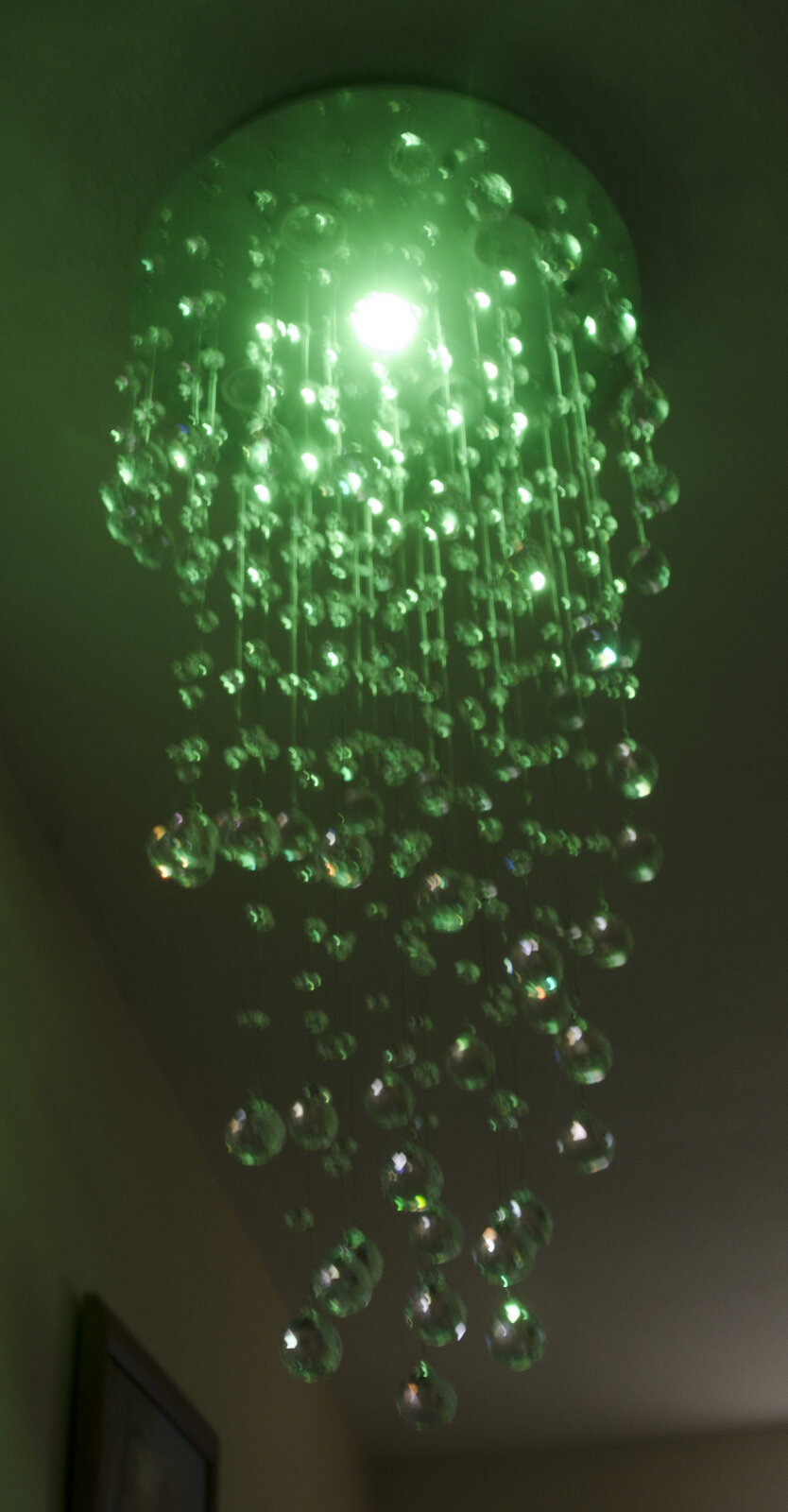

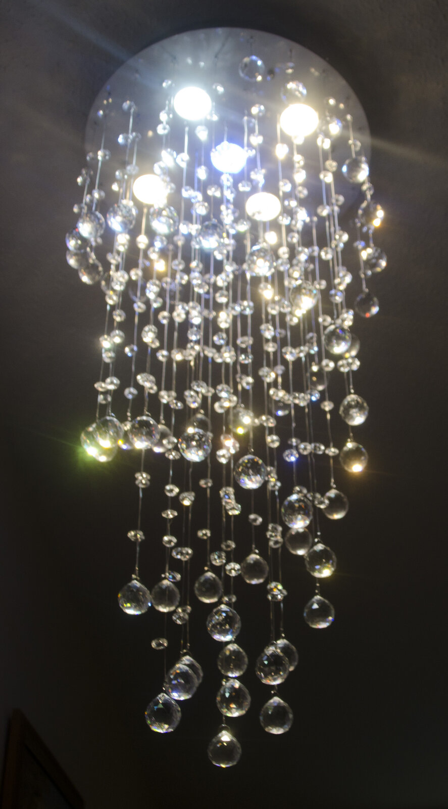

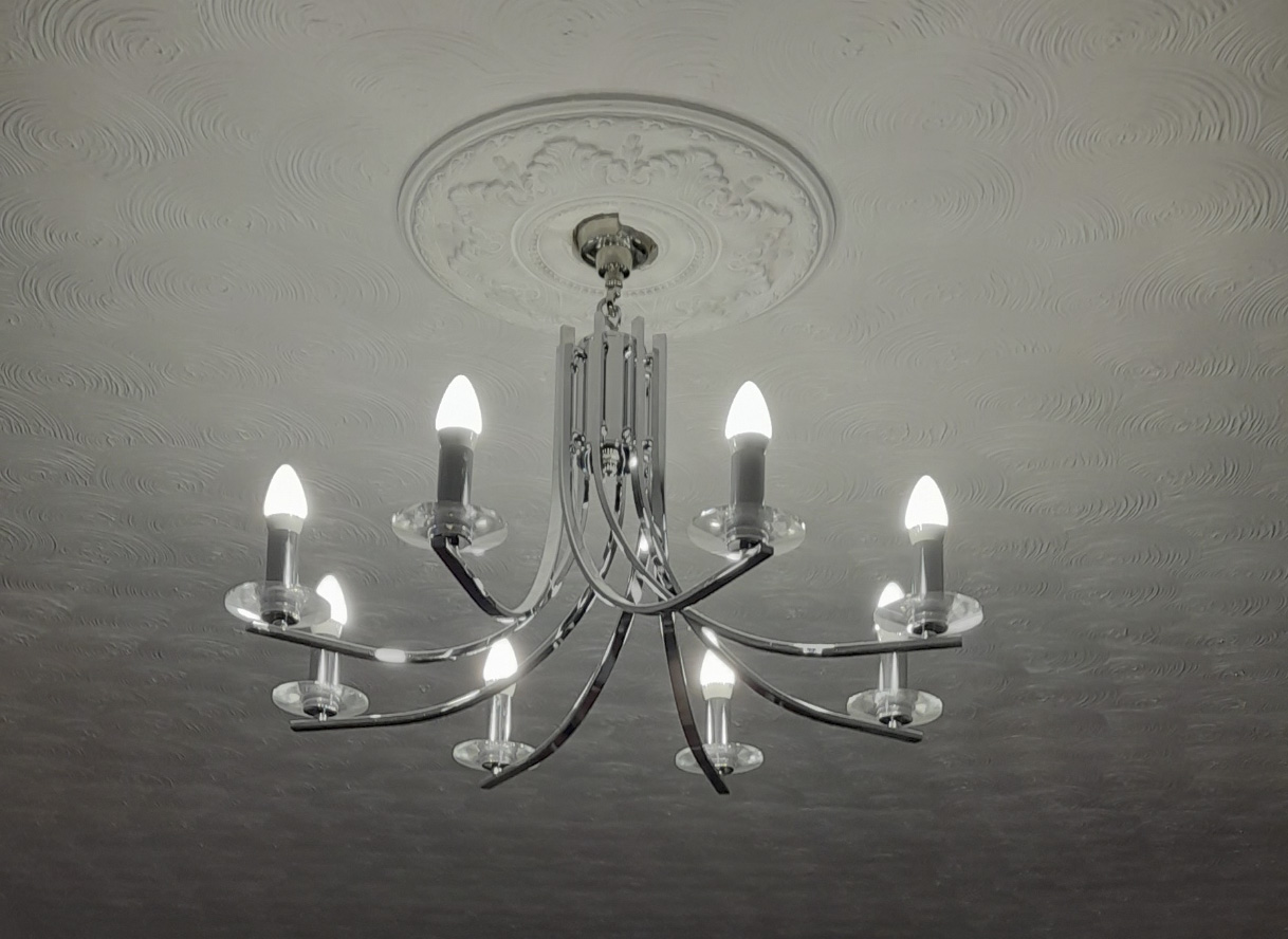

But back down to reality, I moved into a house with a single 150 watt tungsten pearl light bulb for the whole of my living room. The largest LED I could find in local shops was 15 watt, which was like a tocH candle. So I wanted to change the fitting for one which would give out the same light as a 150 watt bulb. Clearly, some sort of chandelier with multi bulbs was called for, and most of the light will be spread throughout the room by reflecting it off the ceiling, so bulbs need to have a base at the bottom, this also keeps the electronics in the bulb cooler, but as we look at chandeliers the bulb size drops, as they typically use an E14 base rather than a BA22d, so max bulb size which can be obtained in local outlets is 6 watt.
Google tells me a 150 bulb has an output of 2100 lumens, and a 6 watt LED typically 480 lumens, I thought that a little low, so checked a few, and it does seem to be what is quoted, so the chandelier would need just over 4 bulbs, in fact I got a chandelier with 8 bulbs, 20220415_000328_1.jpg and I still need to use standard lamps with uplighters and reading lamps. Either the 150 watt bulb was over 2100 lumens, or the 6 watt are under 480 lumens, or a lumen is no good to work out light output?
With my landing light, I was looking at three things, what it looked light, DSC_6804.jpg how well it lit the area DSC_6798.jpg and the ablity to reduce the light output at night so it would not wake people, the danging bits actually do help spread the light, however even with 5 x 6 watt GU10 bulbs it is not bright enough to stop the emergancy tourch lighting at top of stairs, I can select centre or outer lights, and also centre is colour changing and dimable, so it does what I want, however the emergancy tourch does not light in daylight, but does with the landing light on, so clearly not really bright enough.
On my move from tungsten to LED I did make errors, the LED seems bright, but sit down and try to read a book, and they have failed, last house living room had 2 x 100 watt lamps, swapped to chandliers so 6 x 40 or 60 watt, it would depend what was left in the multi-pack, on going to CFL went to 10 x 5 watt, nowhere near enough light, then 10 x 3 watt LED better but not enough so went to 10 x 5 watt, as one looks at the lumens outputs claimed, it quickly becomes apparent lumen does not work. Started with 2660 lumens, and this went to 4700 lumens, so the room should have been twice a bright, and no way was it.
I have the same trouble.
I think my dangling bits help spread the light too.
The first time Mrs S saw them, she said "Lord, I have seen the light!"
